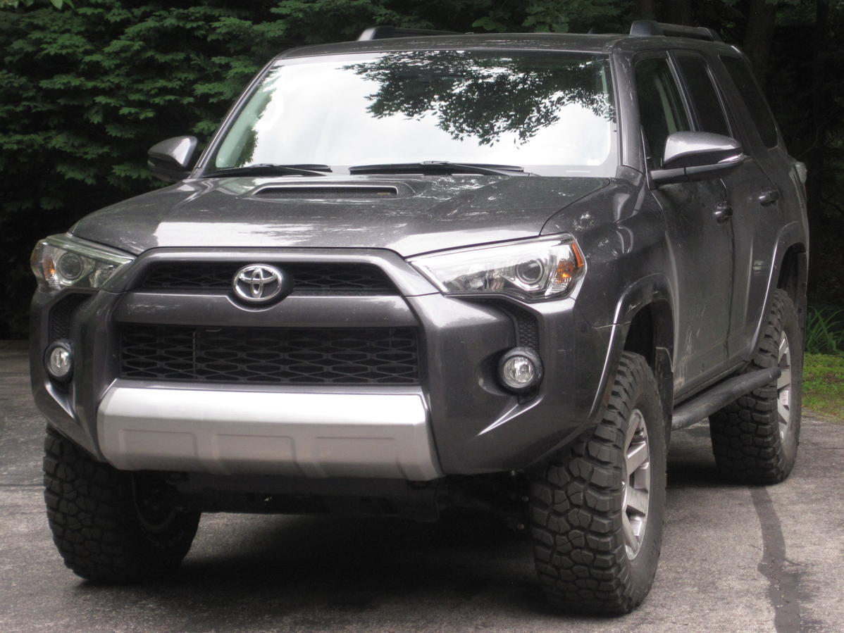

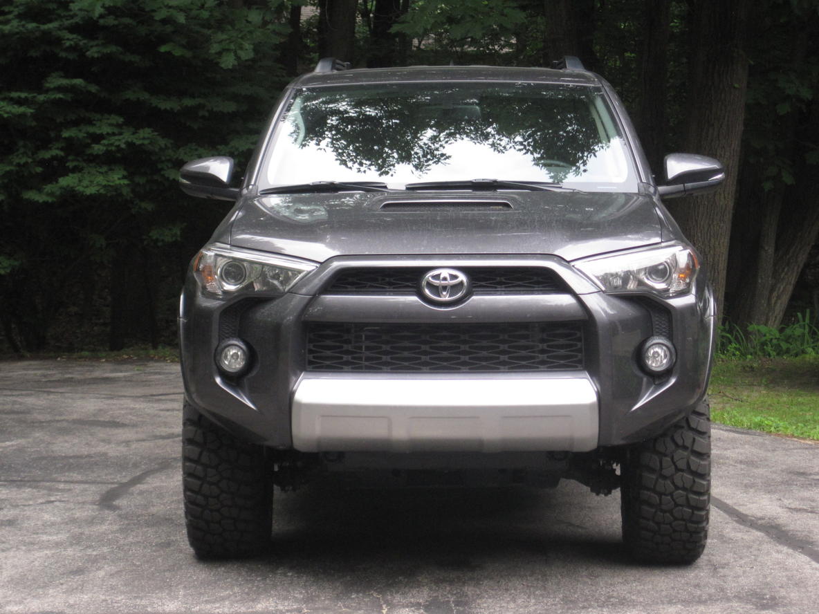

Update:
Thanks to everyone in this thread who helped out when i requested for photos.
Only seems right to return the favor.
285 MTZ on stock TE rims fit perfect.
zero rubbing

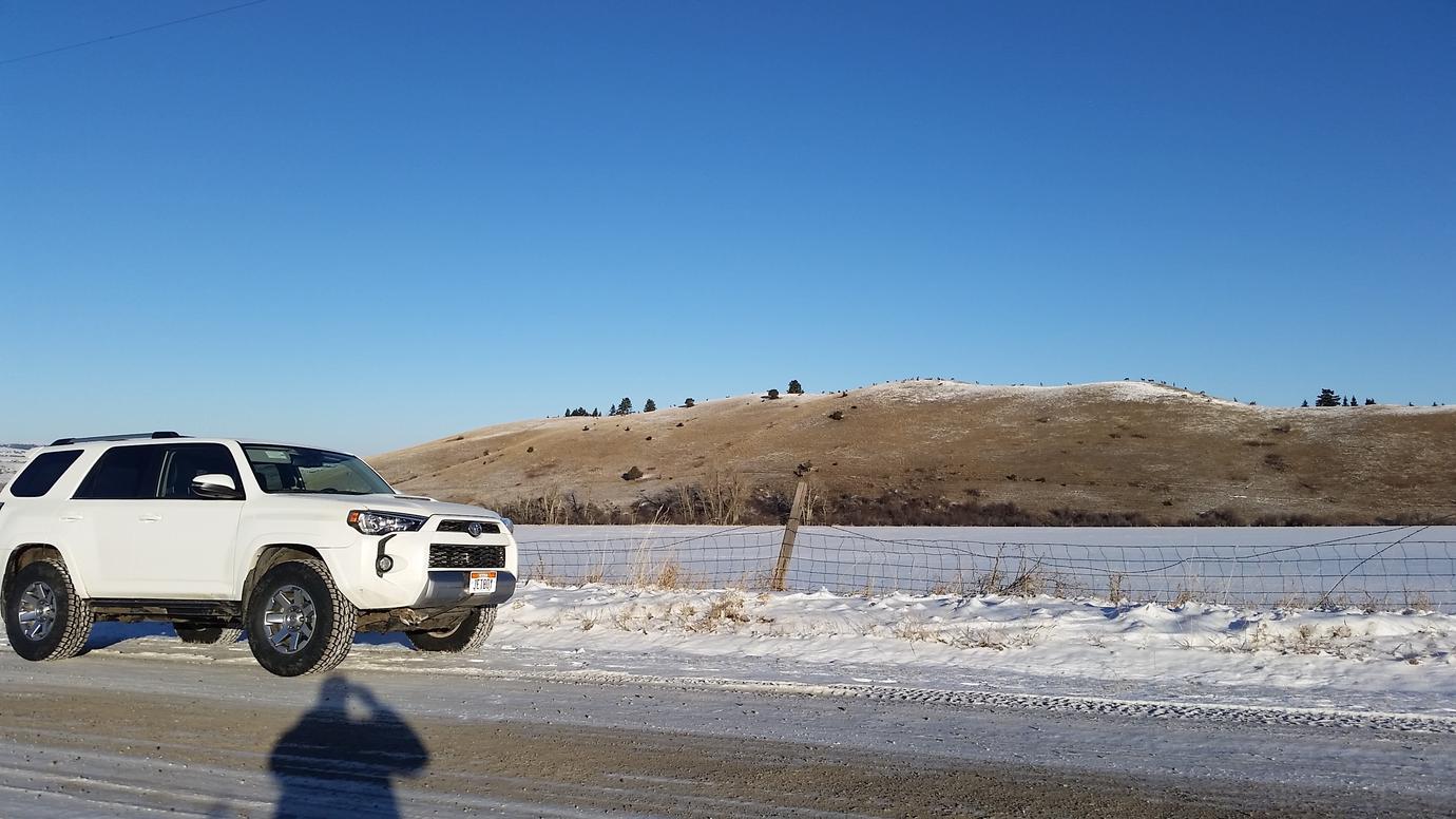

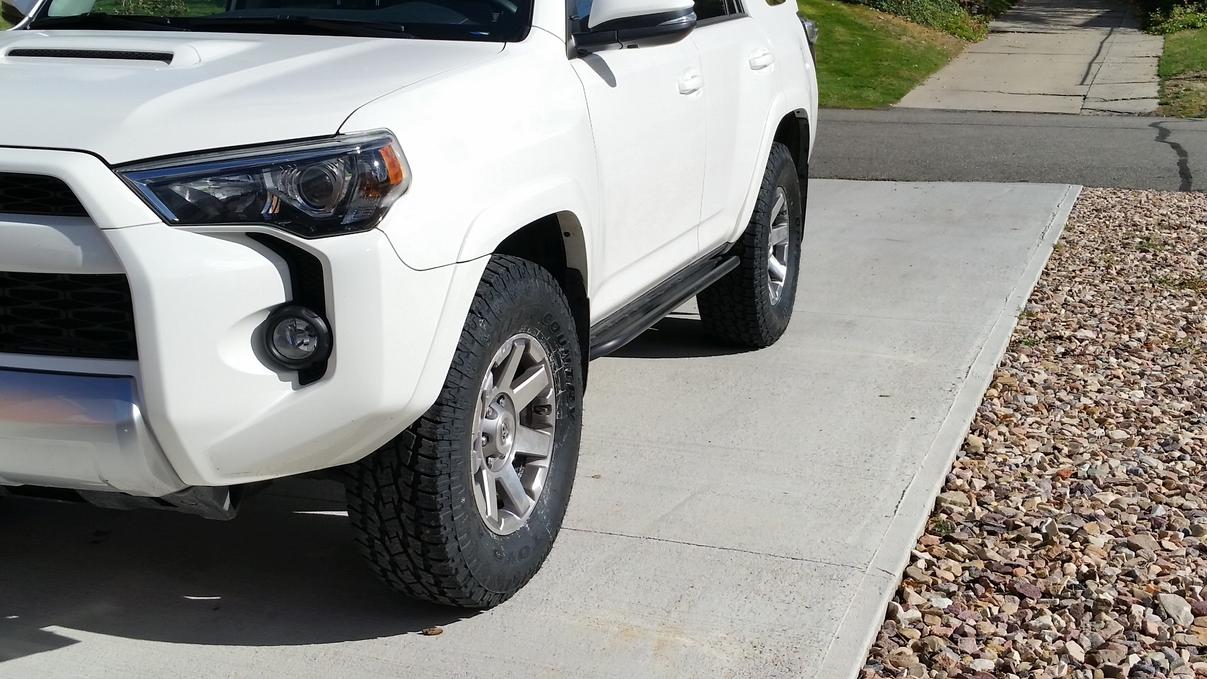

285s on stock TE wheels. Stock height rear, front up maybe .75" with adjustable height coilovers. Pretty close to stock. Just the slightest of rub on the front bumper at full lock in reverse on the driver's side. Stock UCAs, no problems.

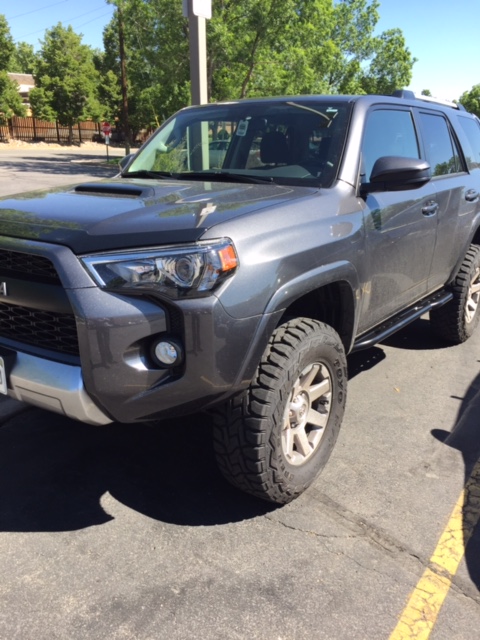

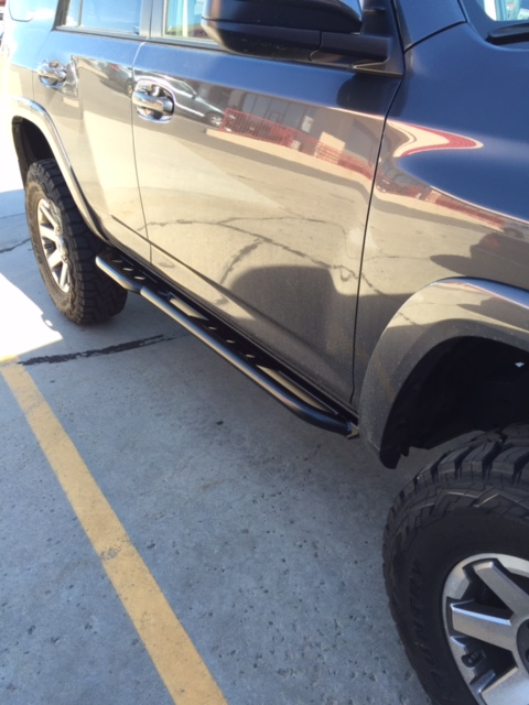

Radflow 2/2.5 give or take for the lift, KM2 287/70/R17
