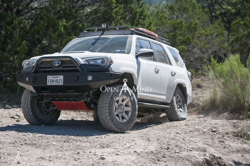

Picture Request: 285s on Trail Edition Rims
Hows your rubbing, if any?
I have a similar setup. I had to heat gun mold the fender liner away and trim a piece of the front bumper (1"x4" - 4inch was a diagonal cut). The bumper trim was on the inner most part of the front bumper so you couldnt even see it.
I also use 1.25" spacers and not the 1.5" spidertrax.

2015 Trail
Tires: Duratracs 285/75/17
Suspension: Bilstein 5100 front set at 2.5, Rear 1.5 spacer
No rubbing at all.

2015 Trail
ICON Stage 2
285/70/17 Toyo RTs
No rubbing
Radflow 2/2.5 give or take for the lift, KM2 287/70/R17

285s on stock TE wheels. Stock height rear, front up maybe .75" with adjustable height coilovers. Pretty close to stock. Just the slightest of rub on the front bumper at full lock in reverse on the driver's side. Stock UCAs, no problems.
Have you had a chance to flex the suspension all the way out with the wheels turned? I'm wondering if the rub is any worse.
Not addressed to me but I will chime in:
It shouldn't be. I just spent some time yesterday moving my fender liners forward and doing some minor trimming. As I was playing around and testing I noticed that on the bumper, the only potential rub spot is when the suspension is "neutral" because at that point the tire is closest to the bumper. As the wheel moves up or down it actually clears the rub spot.
For my AT 285s there was no bumper rub, just liner rub at full lock reverse, but I trimmed the bumper a little anyway. A more aggressive tire would likely have some bumper rub but as I noted above it would most prevalent when "neutral" / uncompressed / unflexed.
No rub. The suspension when flexing up moves back as well. Since the clearance issue is the front bumper on mine at least, it actually moves away from it rather than closer to it. So it's really at full droop that it rubs just a bit.
