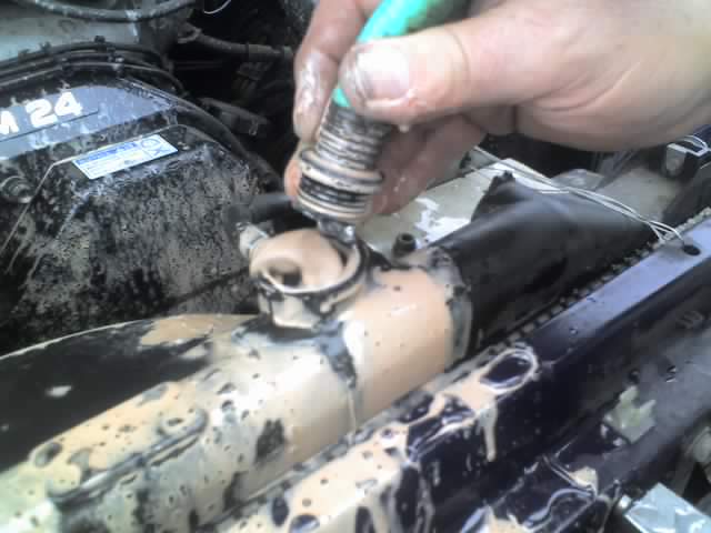

Think that slight red color is probably toyota red coolant but as long as it doesnt look like this then I think you're ok for now.
