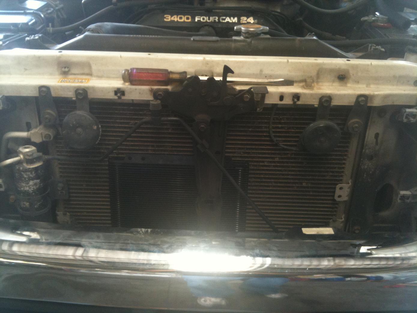

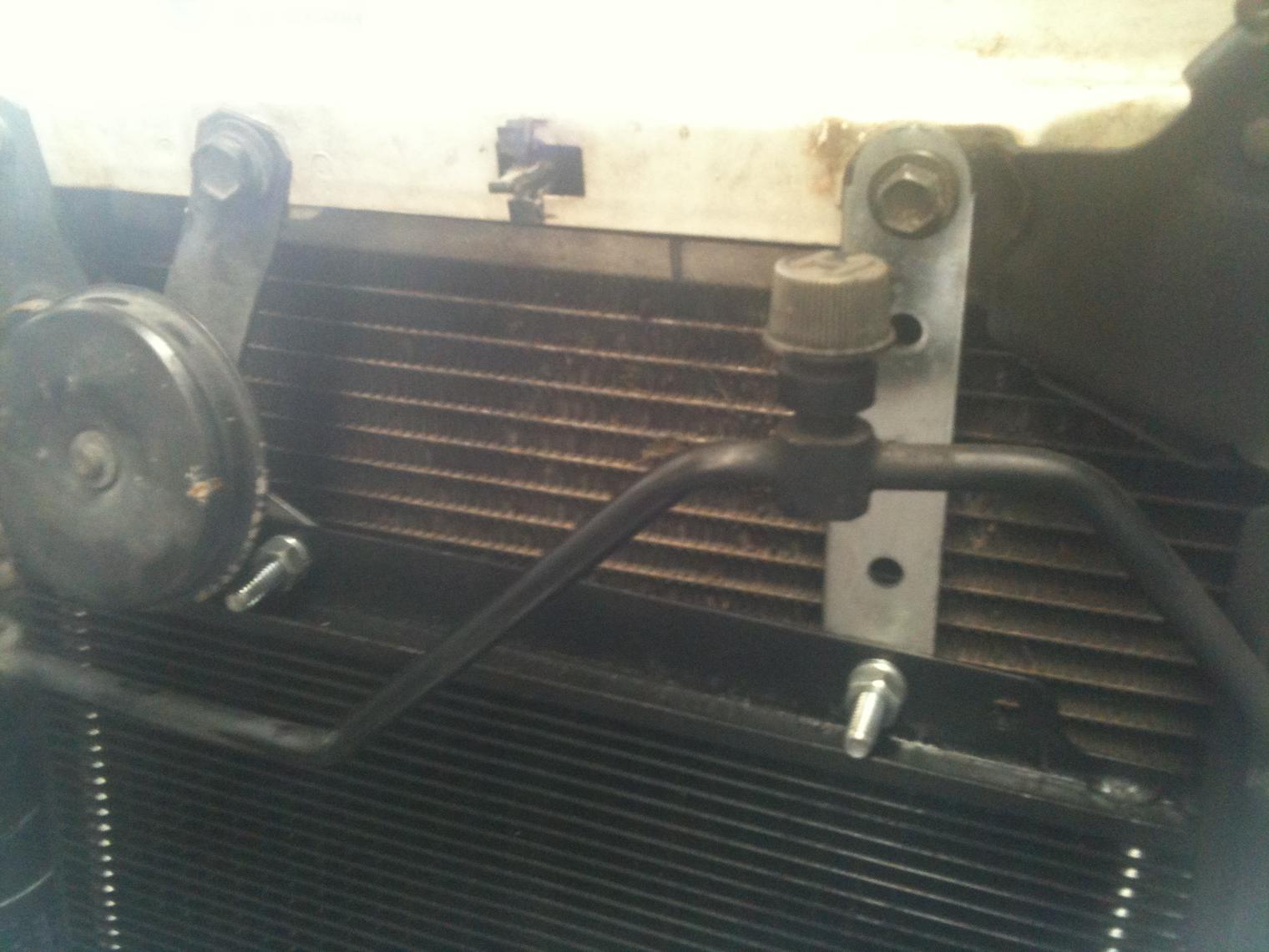

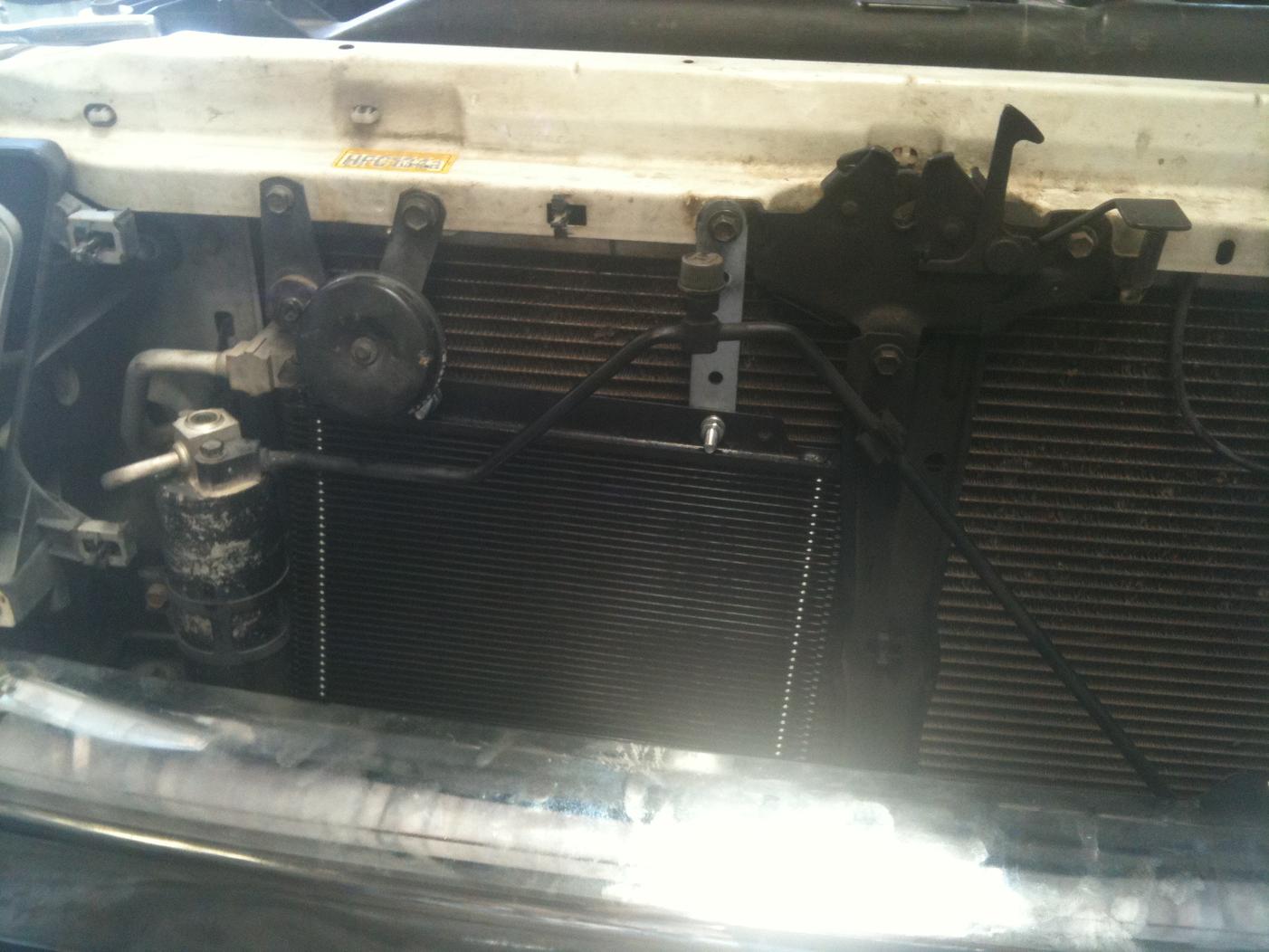

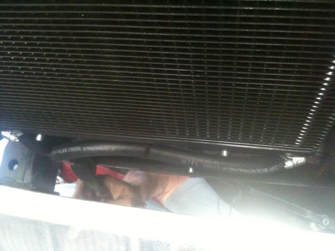

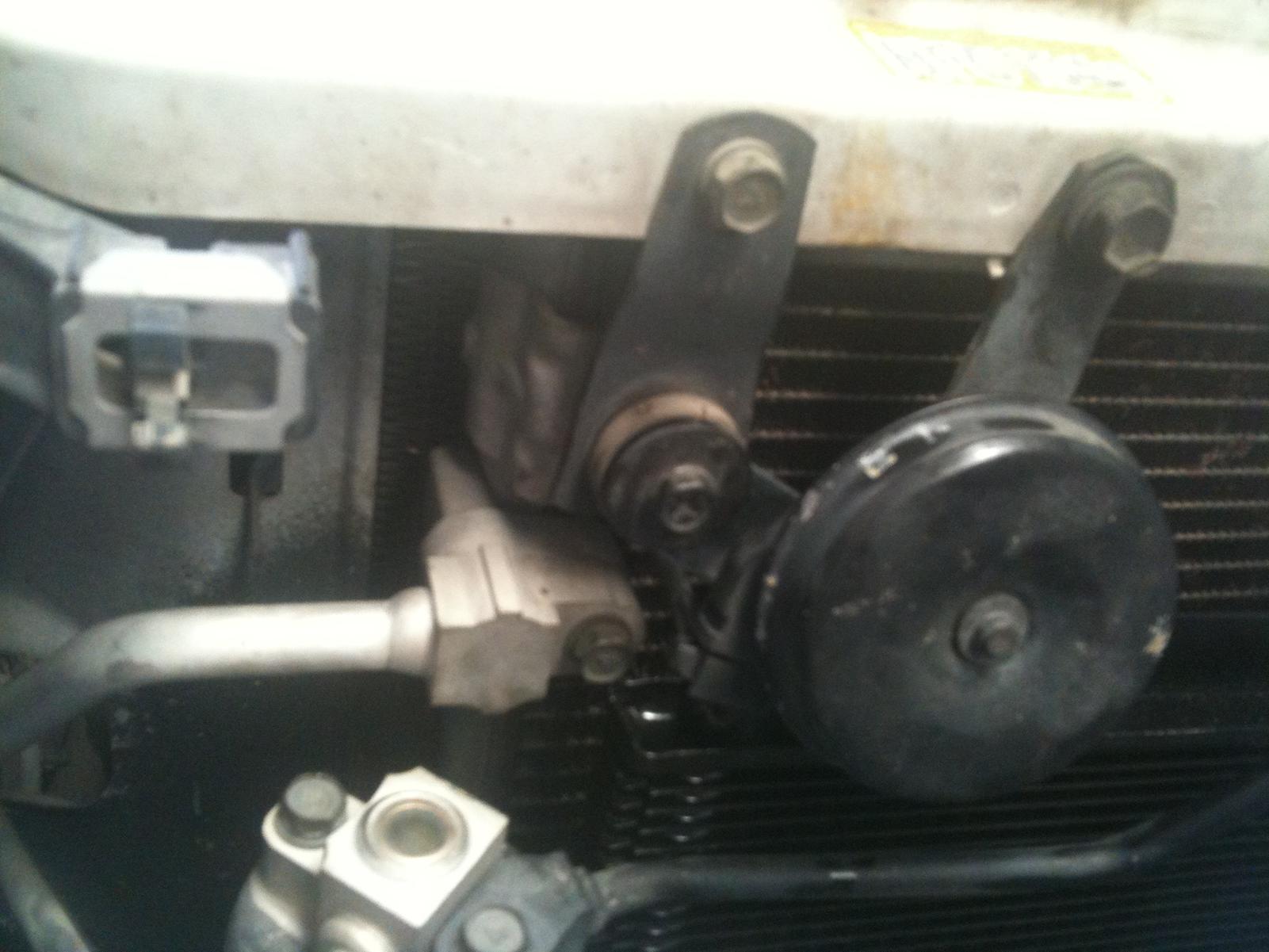

Yeah, I agree, its not worth it to wait and see if it happens, i just got my cooler and Im planning on putting it in next week on my day off, and BTW, I checked and the redish color is from the antifreeze... lol, it scared the s@$t out of me!!!:toilet:
