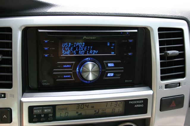

I just purchased and installed this new Pioneer DDin head unit for my 05 4Runner SR5. Bought it from Crutchfield with their included harnesses and trim kit.
Sorry i didn't take photos of the install, but the finished project is attached. For the most part the install was pretty seamless. Here's the steps:

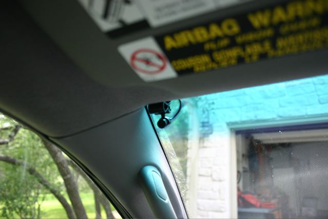

2) The unit comes with a microphone for the bluetooth phone function. I've included a photo of where I mounted the mic. haven't made any calls yet, but the routing was a little tricky at first. I finally just tucked it behind the pillar trim.

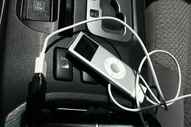

4) The unit comes with a USB cable that plugs into the back of the head (male) and has a female end (with a nice cover) to plug your iPod in. This was the primary reason I wanted this unit. I ran the cable inside the center console, drilled a hole to poke through into the armrest for the iPod. You use your original iPod cable to connect (see photo).
