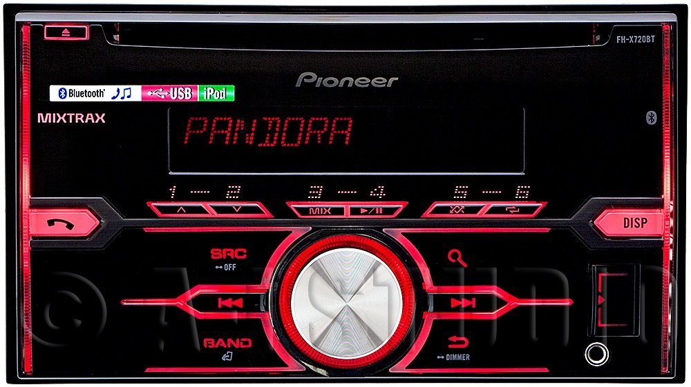

Pioneer FH-X720BT - 2-DIN upgrade?
ThorInc

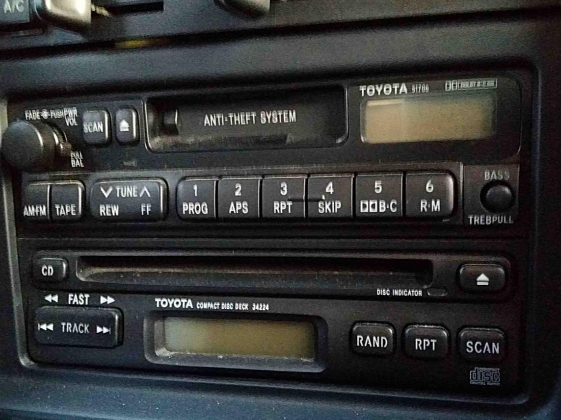

I have been pondering changing my stock radio/cassette/cd player(cd player was added after by dealership) on my 1997 SR5 T4R. Would the model above be compatible with the Scosche TA02B harness and would this unit be a noticeable improvement over the stock system above with the original factory speakers for now? Also, would this be a good system or are there better within the same pricing range? I have done some research but am still not sure of the direction the possible purchase should go. What I am looking for is a little louder and better cleared sound with the stock speakers......
Appreciate all answers/feedback and attached a pic of the stock setup.

I just installed this head unit today and it did improve the sound quality, enough to be noticed but not completely. Im not sure if that harness is compatible or not. I just went to best buy to buy my head unit and had them search the correct harness for our 4runners. ill get back on which one it was

The wiring harness should be correct just remember when you pull factory stereo it only has a one plug harness. You have to pull out that converter thing or whatever it is to get to the real 2 plug harness.
Pull this out - or just reach behind it and pull the 2 harnesses to plug and play. I left mine bolted in just in case I go back to factory

Unless you need teh Bluetooth or Android support, just get the FH-X520UI, exact same headunit minus those 2 features, saves you a bit of money.
Just a quick update, I decided on a Kenwood DPX301U as I already have a Bluetooth speaker system in the truck. The install went well after removing the stock radio/tape and CD player along with the stock amp. I will however be re & re-ing the system once more as I will install a toggle switch for the power antenna and a y antenna adapter and a reducer for the AM antenna connection which is currently no longer connected. Thanks for all the help folks and here is a generic pic of the double din:
Sounds waaaayyyyyyy better than stock system with the stock speakers, tweeters and the radio reception is superior to stock.
