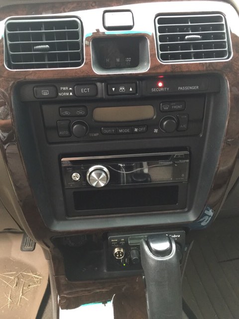

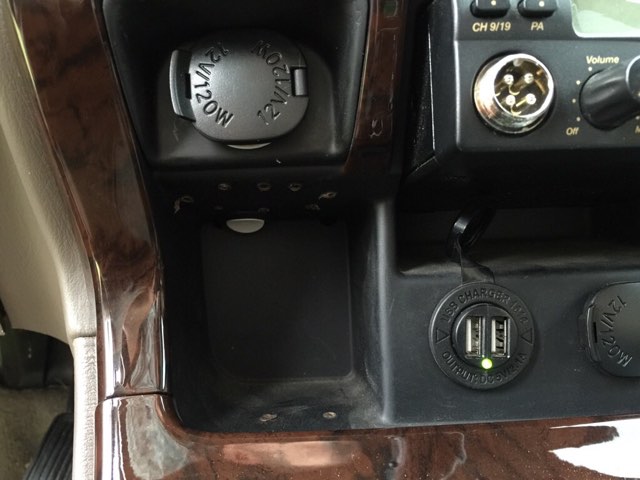

I recently installed a new Pioneer DEH-X8700BS to replace a messed up JVC DVD player. I didn't realize the Pioneer wouldn't lower the antenna when using CD & Bluetooth. But, it wouldn't have been a deal breaker. Yesterday I installed a simple SPST rocker switch inline with the blue antenna/amp power wire. I wanted to use a location for the switch that wouldn't take away from the mostly OEM look of my dash. (Plus, I had a white switch left over from something else and didn't want it sticking out like a sore thumb.) So, I installed it in the top of the small cubby beside the 12V power outlets. Works great and is easily accessible.
