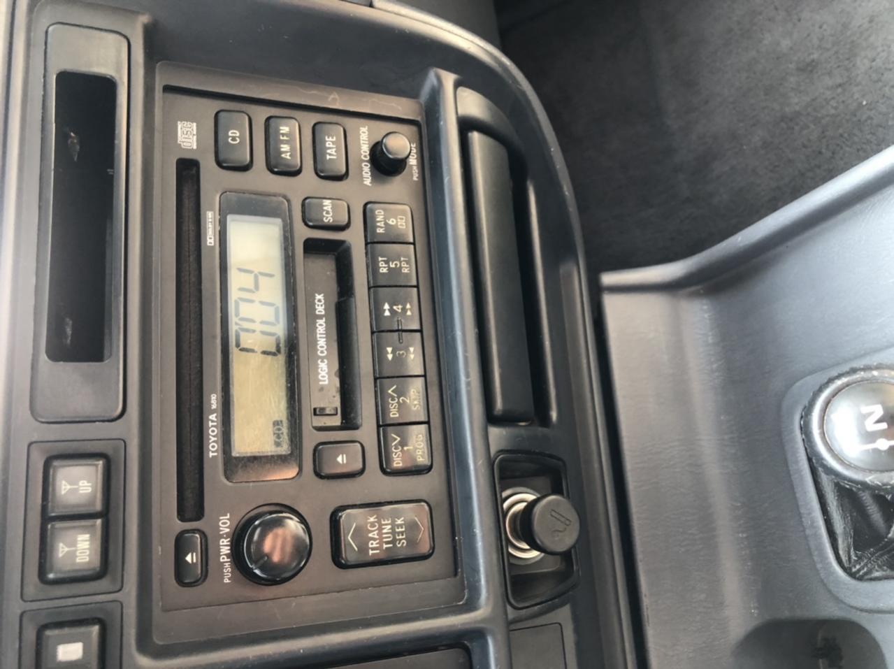

If all you’re looking for is a CD player with radio, there’s an OEM one you can probably find in any 1999-2002ish Toyota that will work great with your stock wiring harness. I had one in my FZJ80 for a while, then went to a single DIN unit. You can also get a Crux Bluetooth unit that plugs into the CD changer controller, for Bluetooth audio if you want.
Apologies for the bad orientation. You can get this at the local pick and pull, or get a tested one off eBay.

I am not sure late model 01 and 02 will plug into the early models as I pulled one out at the pick and pull thinking the same thing and it will not plug into my 1998 as the wiring is different. Maybe you need the matching up too which I did not grab.. :(
my 98 limited had both CD and cassette stock, it didn't work, hence the replacement, but that's another option
