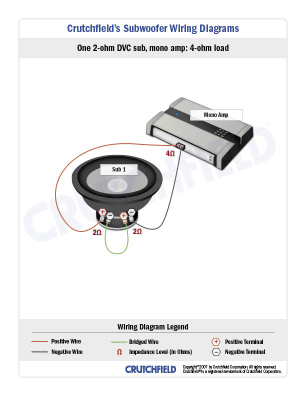

This is the wiring I used
if that's all it is, I'd be really happy!

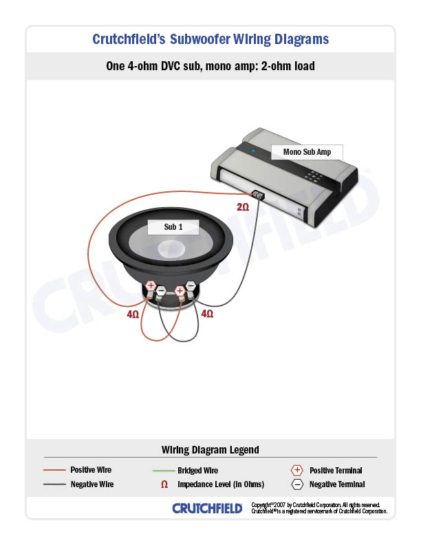

The Pioneer sub is 2 ohm, and I assume your amp is 4 ohm, so you would want the wiring in the first pic.
Thanks
I thought I had it wired correctly. Guess I'm going to continue search for a sub that handles more power. I need to find the box and look at the test measurements, one on crutchfield shows actual 291watts for that amp. They listed the amp at 150w at 4 ohms or 250w rms at 2ohm, if I wired it another way could I only push the 150 instead of 250+??? Thanks again!
