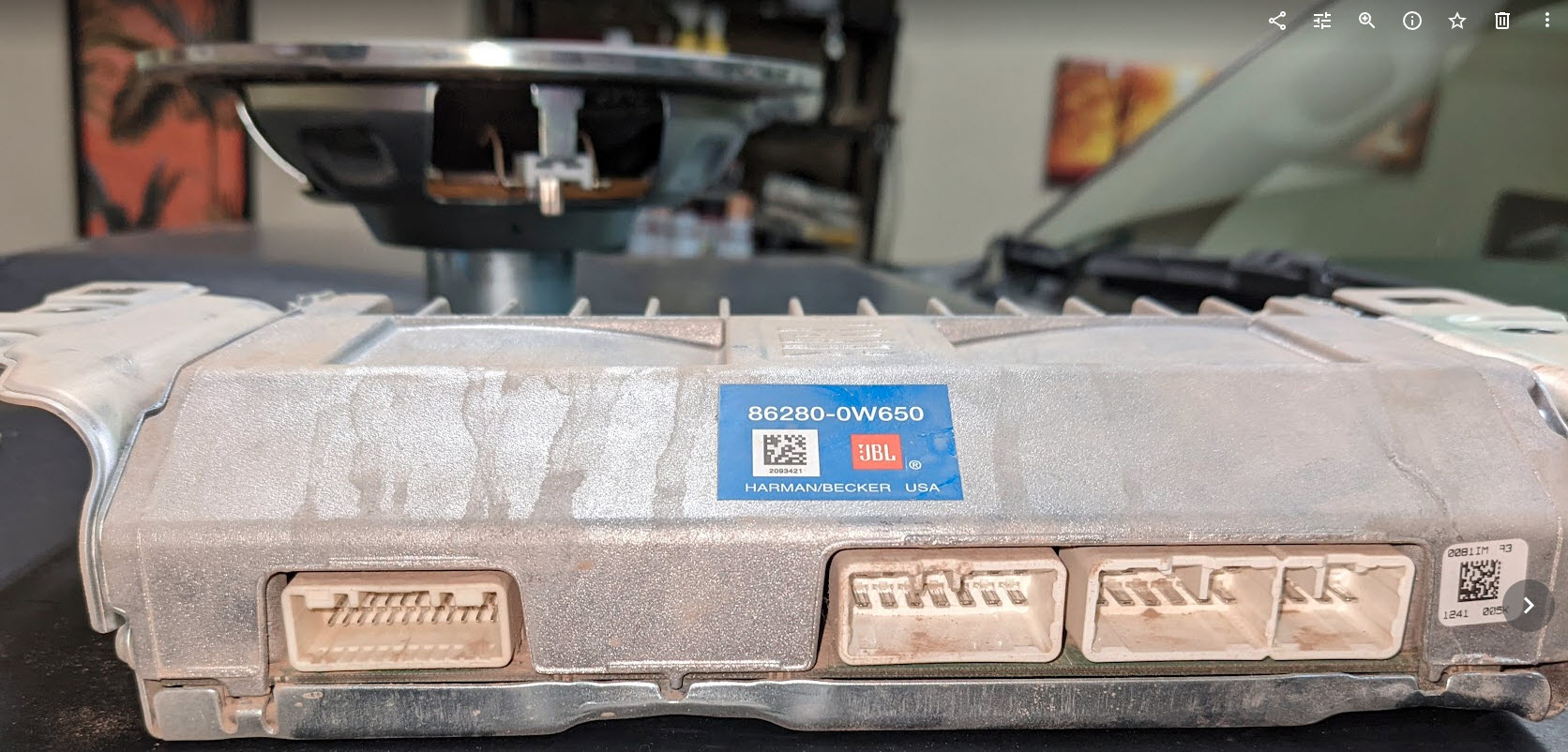

It does. The JBL system uses a separate amp and 8" sub in the rear cargo area and all 2 ohm speakers, which makes replacement with aftermarket speakers difficult to impossible without losing a lot of power from the OEM amp.
yeah I'm just stunned that .3 ohms makes such a big difference.
are the stock JBL's just super efficient.
my buddy brought up a good point too (I think, without fully understanding the tech) that this is a 3.5 inch speaker with a larger magnet, so even if it was same ohms and everything else being equal, there is more magnet/cone for the same amount of energy to push which would probably cause it to put out less volume ie not as loud.
