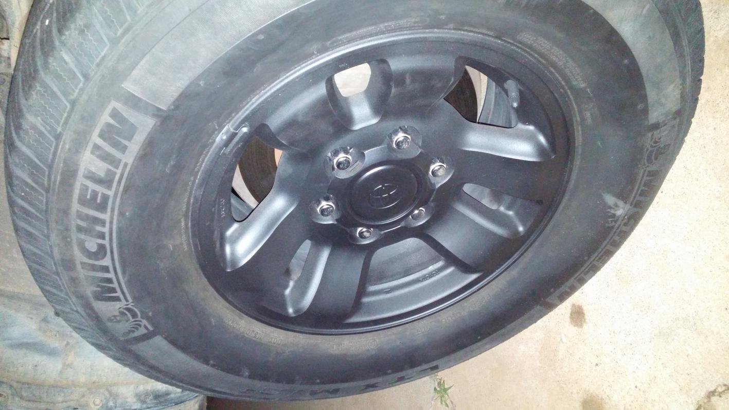

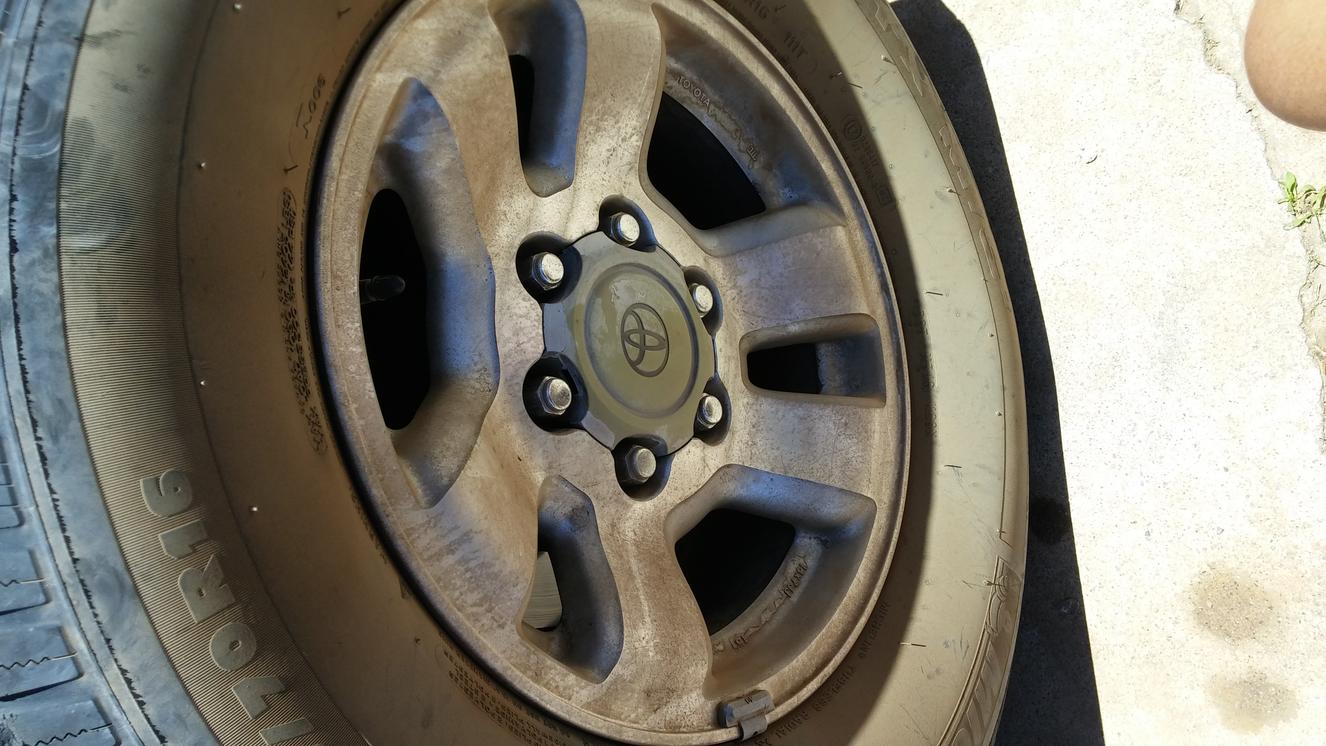

Actually I just did mine yesterday. So I can't say how they are holding up. As far as process I removed the wheels and scrubbed all of the nastiness off of the tire. Then I did four coats with about 15-20 minutes between coats. I didn't cover the tire like some suggest because it is plasti-dip so you can just peel it off the tire. I think it turned out well. uploadfromtaptalk1431961963104.jpguploadfromtaptalk1431961983328.jpg
How did you keep it from peeling off the wheel when you peeled the tire? Did you cut around the rim first or what?
The gap in between the tire and the rim does that part for you. I suspect that unless you fill that gap with plasti-dip it wouldn't be a problem. I just peeled mine off no cutting.
