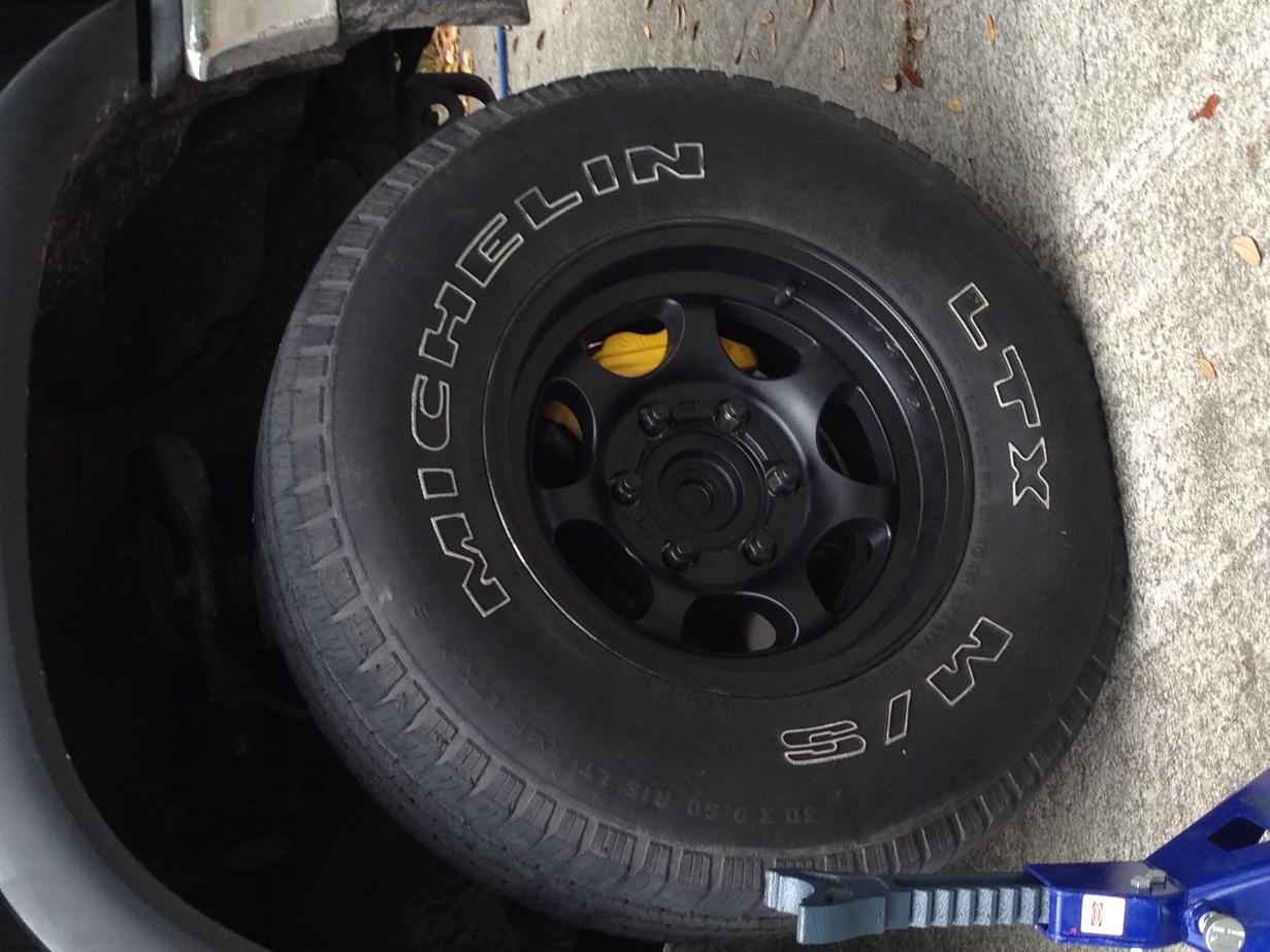

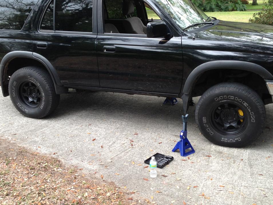

I plasti-dipped my rims and painted me calipers also. Stuff is great. I didn't take off the wheels when I did mine. I used playing cards like a few guys said. I found if you CAREFULLY take a box knife and run it along the outside of the rim, it stops it from possibly peeling all of it off.
I just put newspaper behind the rim spokes so it didn't get on the calipers or rotors or anything. Used 3 coats, then clear coated it with some chip resistant stuff i found at autozone. All in all I think it came out well. Really changed the look of the truck.
I also painted my calipers. just wipe it down with rubbing alcohol and let it dry. Then I used a heat resistant black as a base, then did 3 coats of yellow.
Sorry I don't really have a before picture.
Opinions? Questions?
