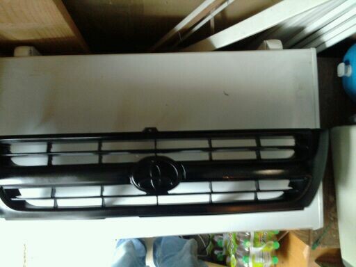

Here is a pic of my grill. Sorry I don't have one of it on the car yet or a pic of the smoked tails. (to smoke tails btw take them off and spray them with "VHT night shades" until you get your desired darkness and if you mess up buy some "goof off" and take it off"

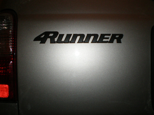

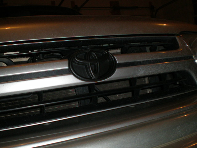

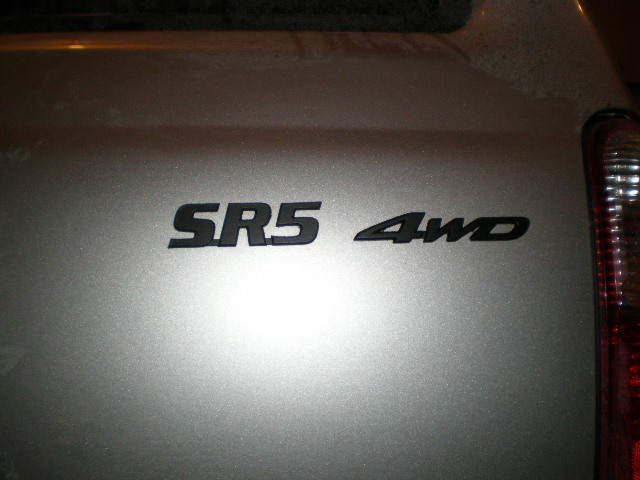

I did my front symbol last night and rear's tonight. Taping everything off takes most of the time. Before taping off I just wiped everything down with some simple green and a damp wash cloth (trucks dirty from recent snow/salt), then dried it with a heat gun. I found using a heat gun in between coats really speeds up the drying time. Directions say wait 30 minutes between coats but with a heat gun you can pretty much do one coat after another. Plus I think it prevents any runs in the paint because it doesn't get time to run, if you put some low heat on it right after you spray it begins to dry immediately and practically self levels. Total time approx 2 hours per night.
It was dark in my garage when I took the pics so they're not that good, but it should give you an idea:
These look great! gives the vehicle a great look, How many coats did u use?
Did 4 on the front last night, but I only used 3 on the rears tonight.
Since I figured out from last night that once I put a mild base coat down for the 1st coat and then to use the heat gun (basically keeping it about 12"-16" away and keeping it moving at all times) on each coat after that, I laid the 2nd and 3rd coats on pretty heavy and made sure to get heat on them right as I finished spraying. No runs to worry about, and left it slightly tacky in between the coats. Then as I was peeling everything off, I put a little bit of heat back on them as I was going along just to keep it warm and so it would pull off easier. Used toothpics to essentially "scrape" along the edges and then just dug out with the tip of the tp in between the tight areas.
