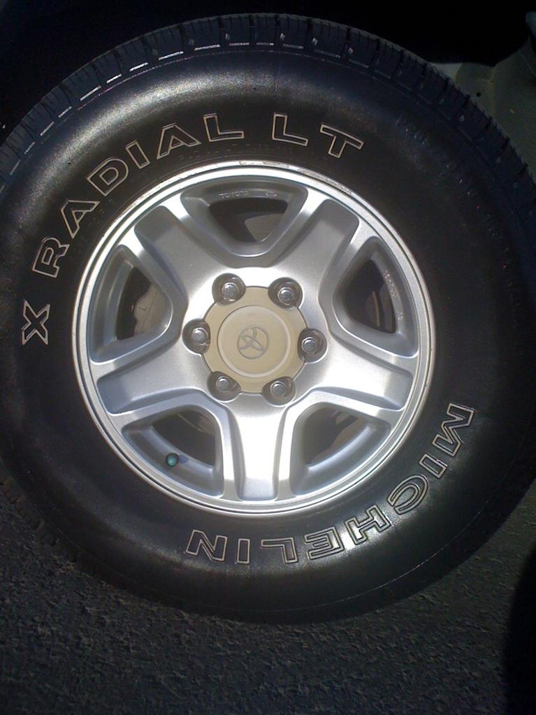

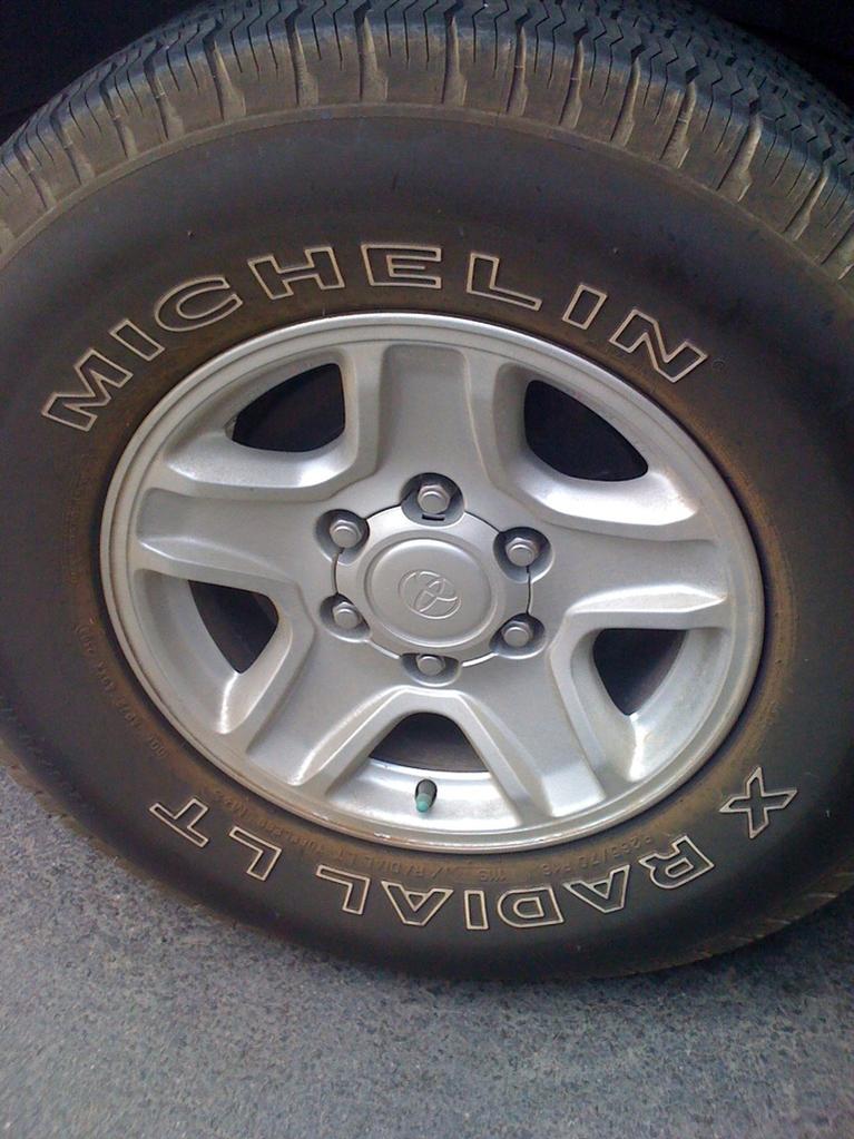

My center caps were wearing also. Use a flat head screwdriver and pop them out. This is what I did and the outcome was superb! Looks as good as they did when they came from the factory.
1. Spray on Dupli_color Prep-Spray Grease and Wax remover. (surface is already rough enough to where the color will stick, just spray on the Prep and it will get rid of any grease or wax, at least my caps were that bad).
2. Wipe with non-lint rags and let dry. Aprox. 2 to 3 mins.
3. Spray on Dupli_color Wheel-Coating Silver. (it is the exact match for our toyota stock rims) 2 coats then let dry for 10 mins. Add another 2 coats then let dry again. I repeated this process 4 times.
4. Let dry (approx. 1-2 hours depending on condition, temp. during painting was 90+ degrees, if much cooler then drying time should be increased, you be the judge) then install using a piece of cloth or terry towel as cushion to push the center cap back into the rim.
Before and After pictures below:
(rim and tire are dirty from after picture)
