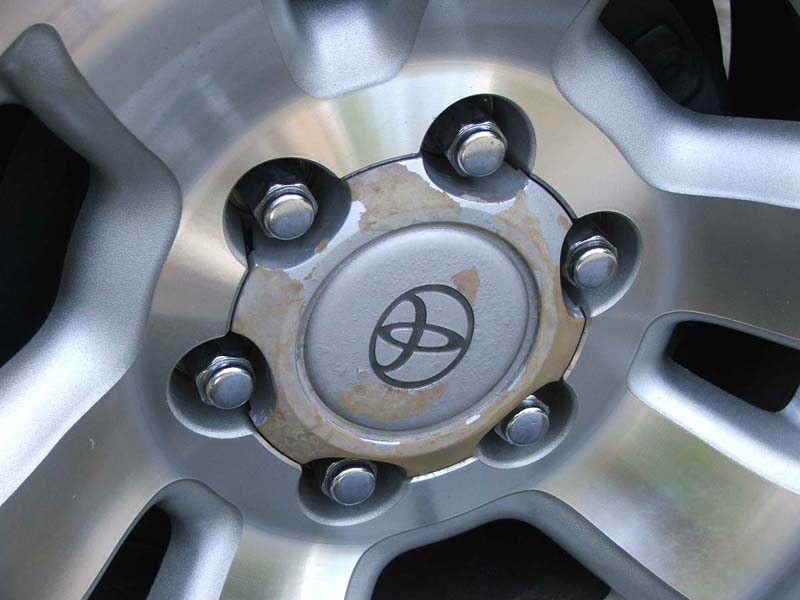

plastic center caps are fading , real ugly...

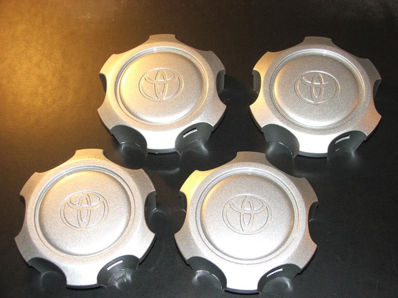

Just painted my center caps
What store did you get the paint at? It looks awesome and I need to do it!

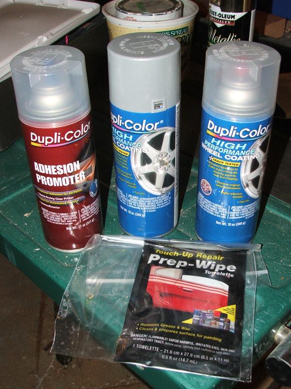

I actually just did this yesterday. Like many others, I used Duplicolor brand paint and prep wipes (got mine at Pep Boys).
First, I stripped the remaining paint off the centercaps with brake cleaner. It’s cheap, it melts right through paint, and leaves no residue. (Unfortunately it also melts through plastic and flesh, so wear gloves and be careful.)
Then I applied one coat of adhesion promoter (CP199), four coats of Duplicolor silver wheel paint (WP101), and three coats of high performance wheel clear (HWP103). All eight coats were shot in 15 minute intervals, so it’s basically one thick homogenous hardcoat of plastic. Not sure if I'm going to repaint the Toyota "Bubble-T". I'll wait to see how they look first.
I fouled up one of them when some big spits came out of the rattlecan, but I was able to rescue it. You’d probably have to get on hands and knees to see the error. (Didn’t want to start over.)
The real trick to rattlecan paint is if it says to wait one day to handle the parts, multiply that by at least ten. :lol:I won't be reinstalling these for at least two weeks. Others have had very good results with this paint so I expect them to be fairly durable. Only time will tell.

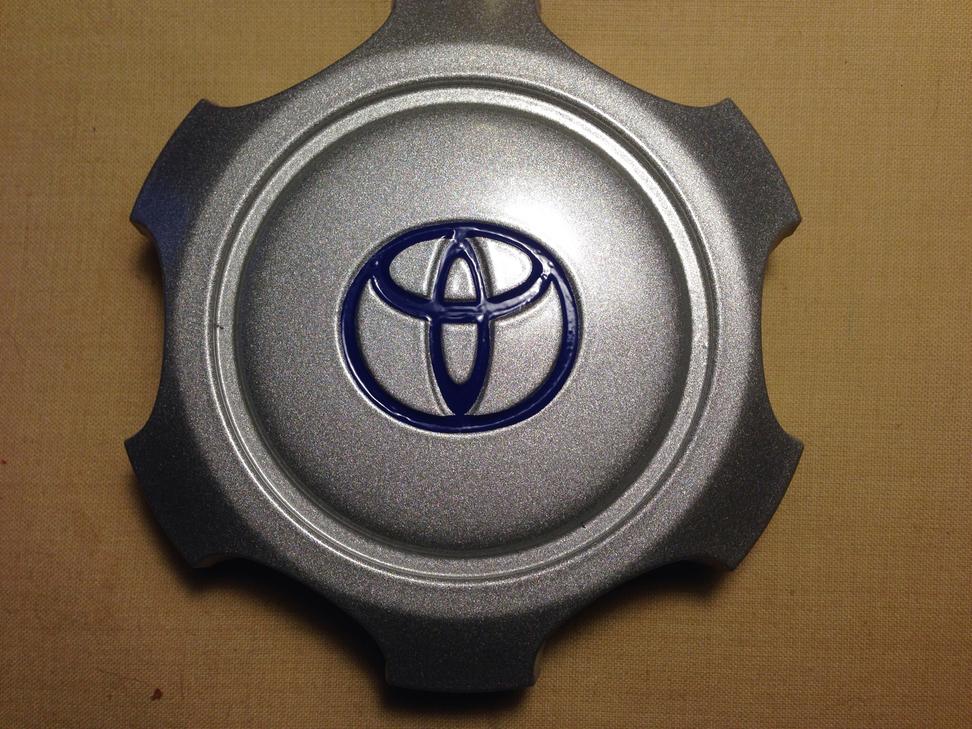

I used the same Dupli-color silver wheel coating and clear gloss as well. Made a Huge transformation. I found a website of a vinyl Graphics business in New Jersey that makes the Toyota logo. I called and gave him the height and width of the logo and he made me 5 of them and shipped them to me for $7. Here is how they turned out:
The dimensions for the logo are:
Height = 1.52"
Width = 1.72"
I used PayPal (available on his website. I called him first with the dimensions). Zach printed them and mailed them the same day. I received them in the mail two days later. Here is his link:
-Rockford SIGNS- GRAPHICS-VEHICLE WRAPS- - Signage Rockford,Il Got Signs? 779-770-5661 Vehicle Wraps - Graphics - Banners - Lettering - Printing
Tip: when applying the logos to the cap, peel it of the paper, position it as close as you can to where you want it, and then hold a blow dryer about a foot over it to soften it up. This will allow you to be able to place it in the engraved area of the logo. Sounds elementary but make sure you have the sticky side down. DO NOT BLOW DRY IT BEFORE YOU PULL IT OFF THE PAPER, because it makes it too stretchy and hard to get it off the paper backing. I CLEAR COATED THE CAPS AFTER APPLYING THE LOGOS.

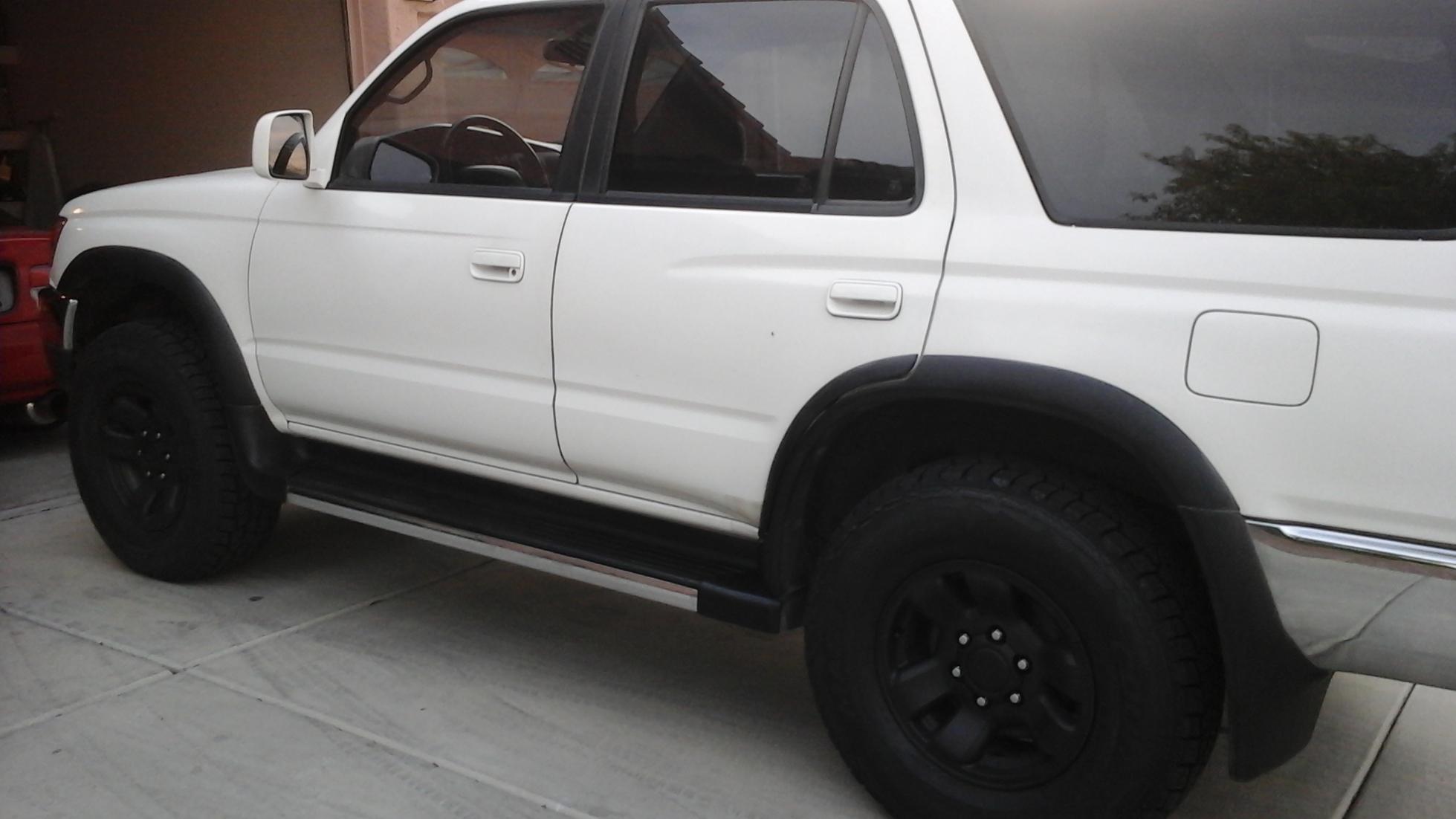

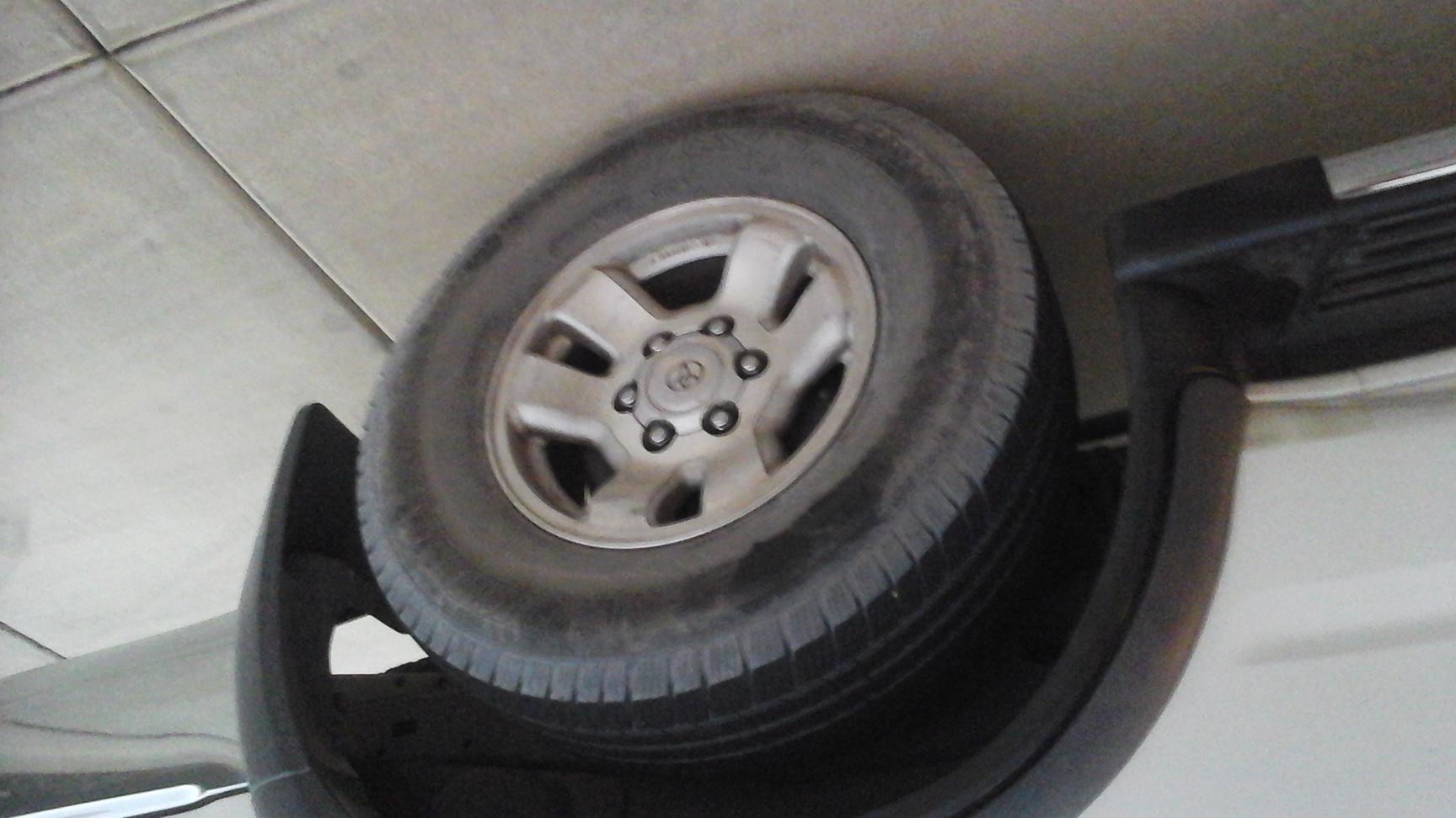

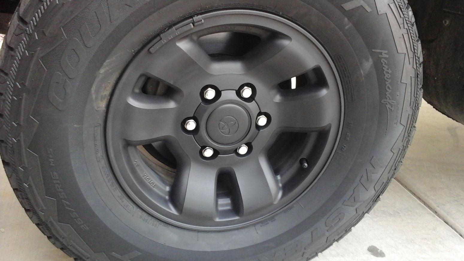

This issue is super common. Mine where pretty bad when i got the 4runner. I endedup spraying the caps and rims with black plasti dip and it turned out great. I will be painting them satin black when it comes time to redo them. Changing the wheel color gave the rig a totally different look. Before and after pics.
The plasti-dip looks good! Considering plasti-dipping my rims too. Did you remove the wheel when you sprayed it or did you leave your wheels on and cover the brakes?
