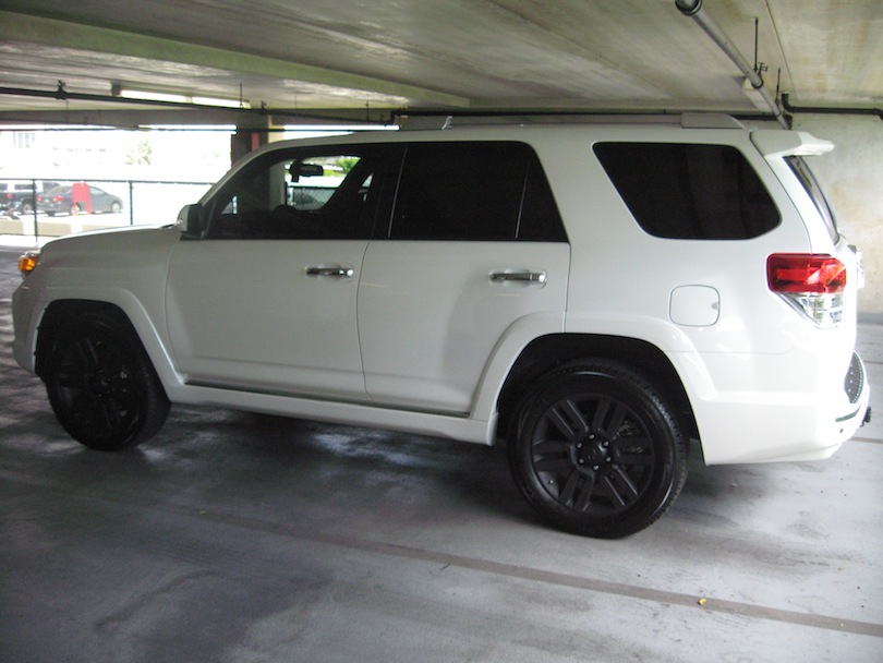

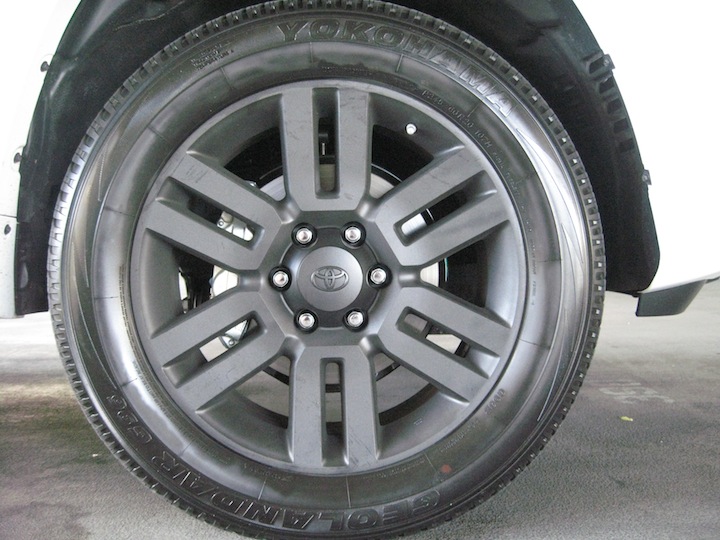

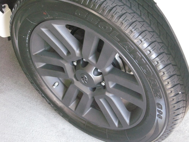

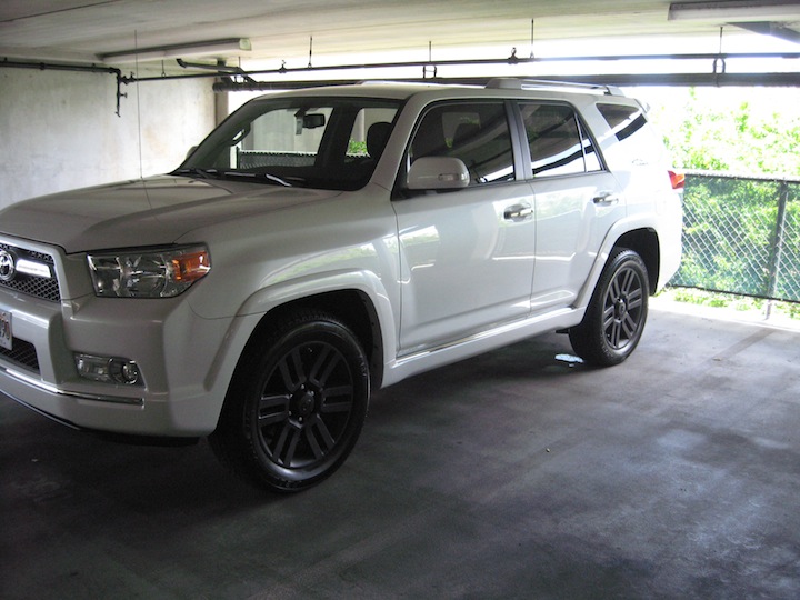

I just did mine 2 days ago! Bought a set of Limited 20's from a forum member (excellent transaction) and used the plasti-dip. Worked out real good. I will take pics tomorrow when it's nice and sunny outside.

Note that the first wheel has some tire shine that got on it. I was real easy to do. I sprayed 3 coats of the plasti-dip. I will peel it off and retry to do it again. My first coat was real heavy and when it dried it came out really nice. Smooth texture and it was actually shiny and not flat.
