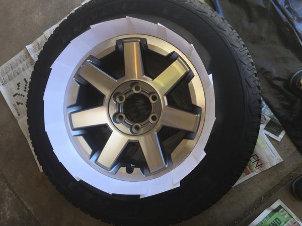

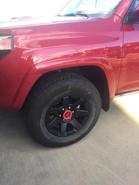

Weekend PlastiDip 5th Gen TE Stock wheels
Index Cards, great idea I saw here.
Four Coats, 4-1/2 cans.
Not bad for $30 in paint. Nice look and pretty simple.
