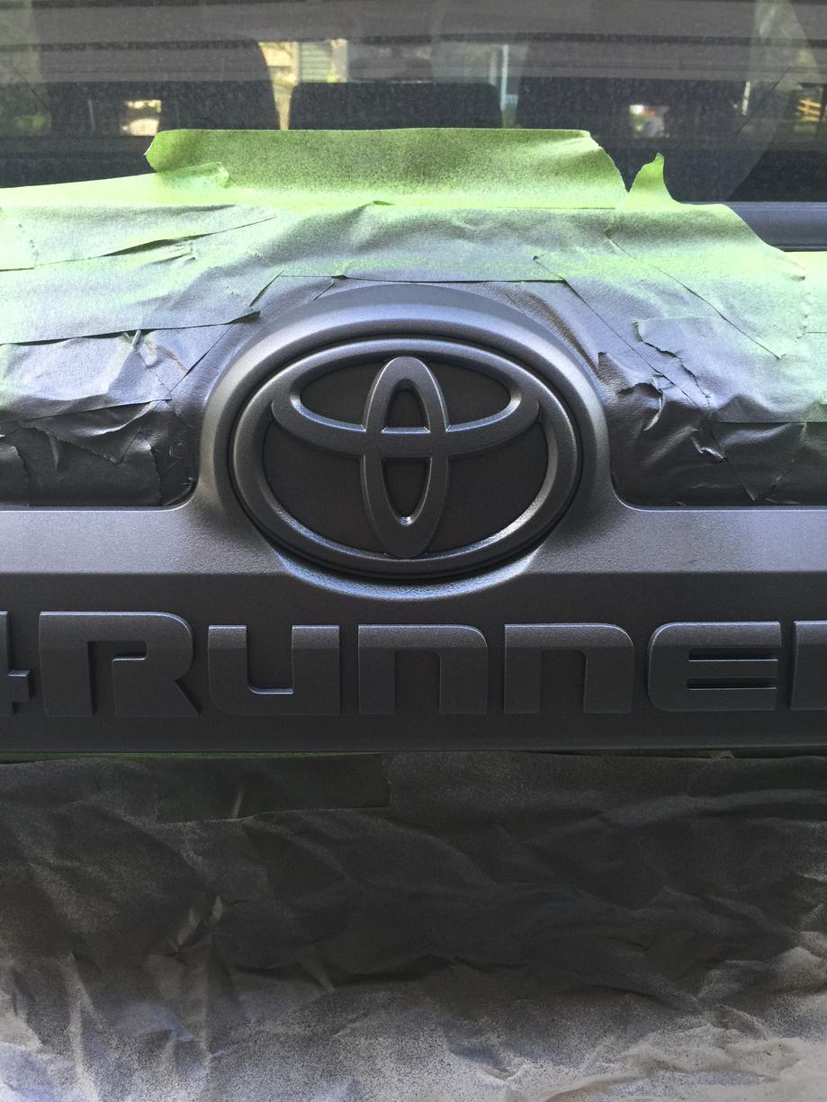

How well does this work when you Plasti Dip the rear emblems of the Trail Editions?
I ask because the 4RUNNER logo is on a black plastic rather than chromed piece so I'm afraid the plasti dip will stick to all of it and not pull off like in the Tundra YouTube video.

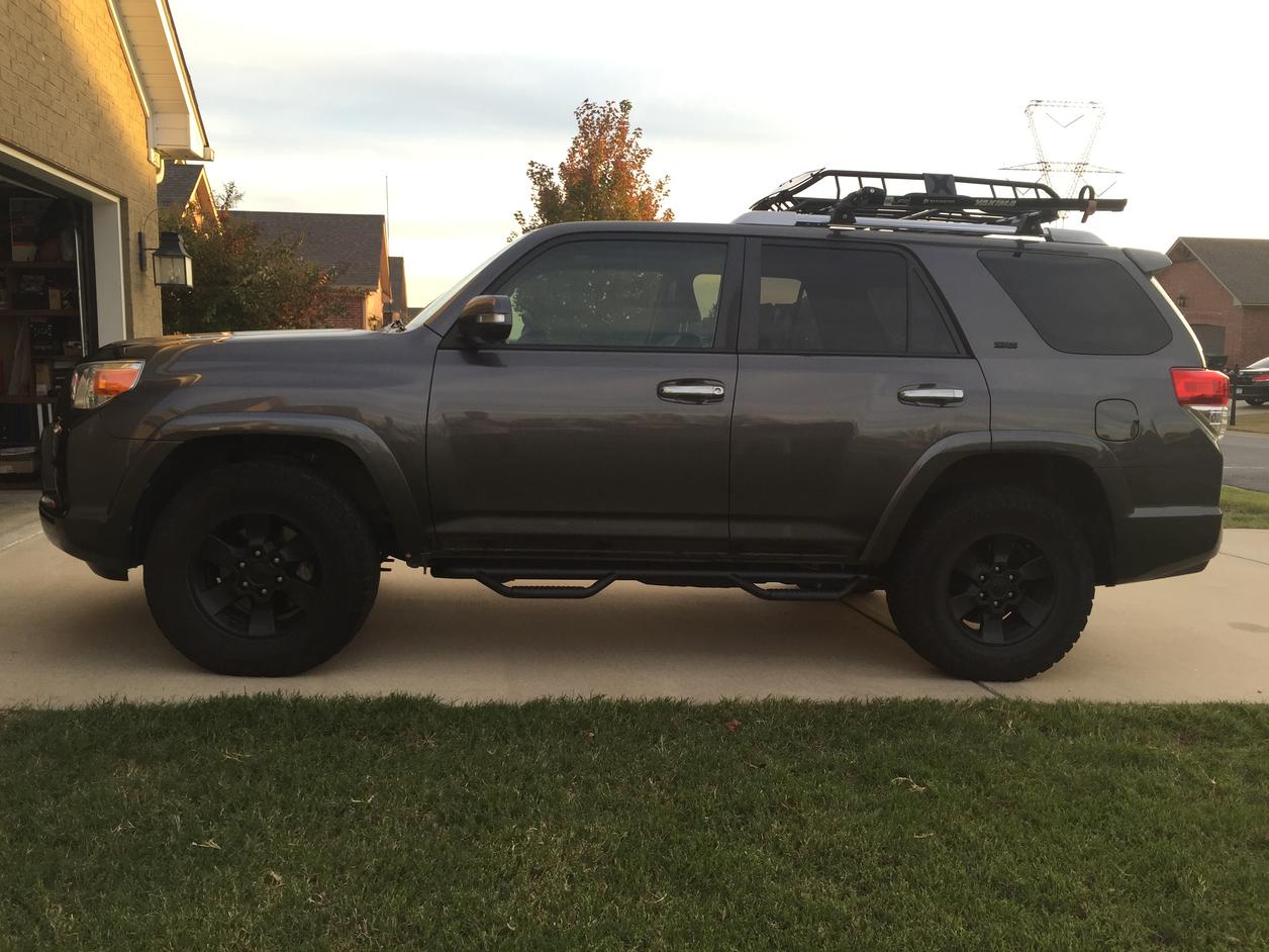

Would love some advice on how you accomplished this. I tried about a year ago and had trouble with the lines. I did my wheels and handles this weekend and got to considering this again. Is there a specific tape I should use? or did you remove the masking after each coat until it dried? Here are my wheels.

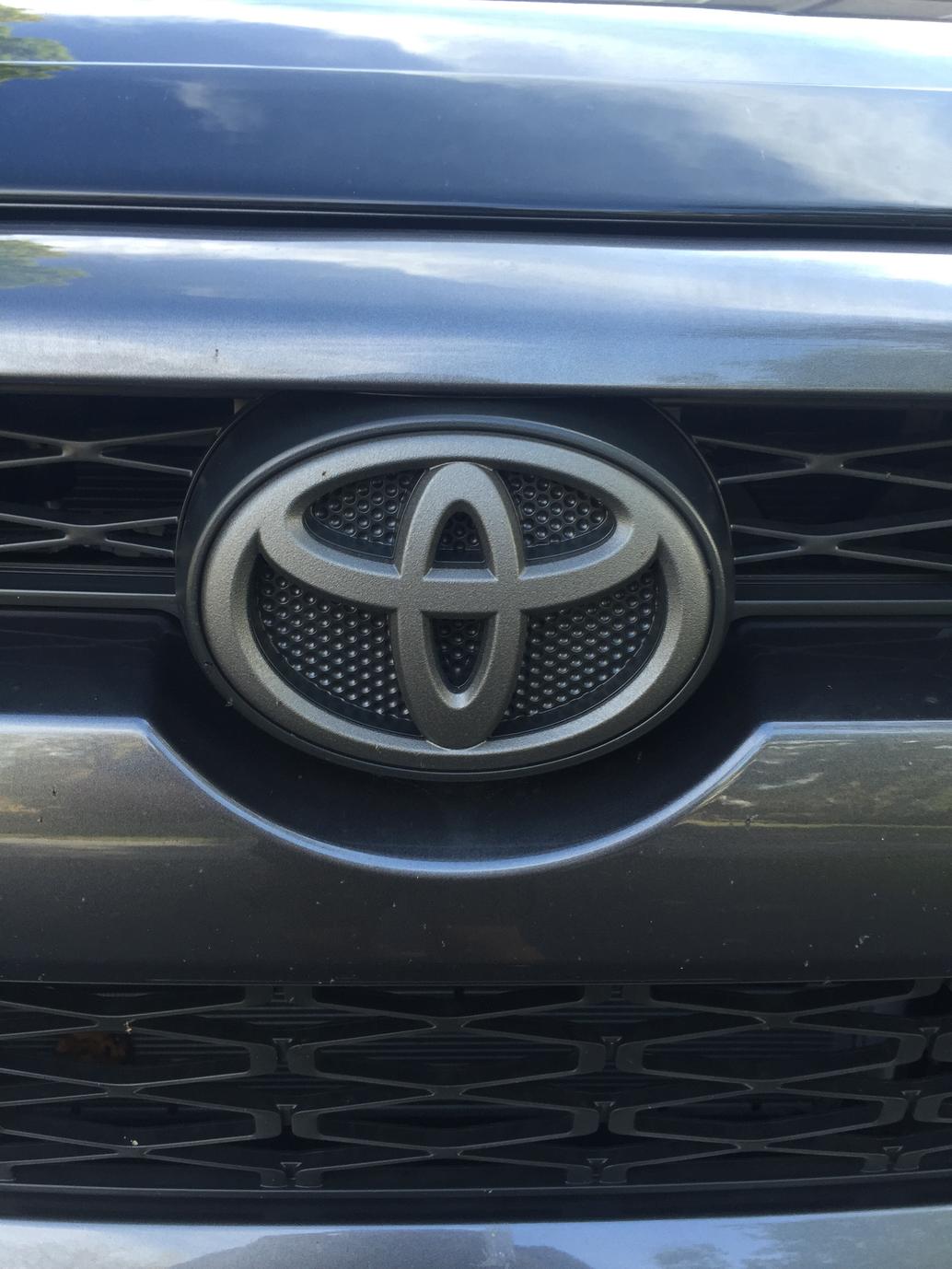

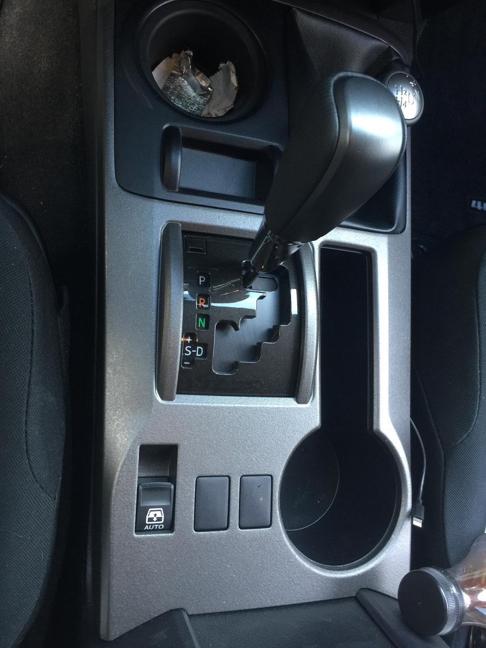

Here's picks of the TE logos and center console...I did remove the plasti dip on the rear so it was just on the logo and lettering. Forgot to take a pic though .
