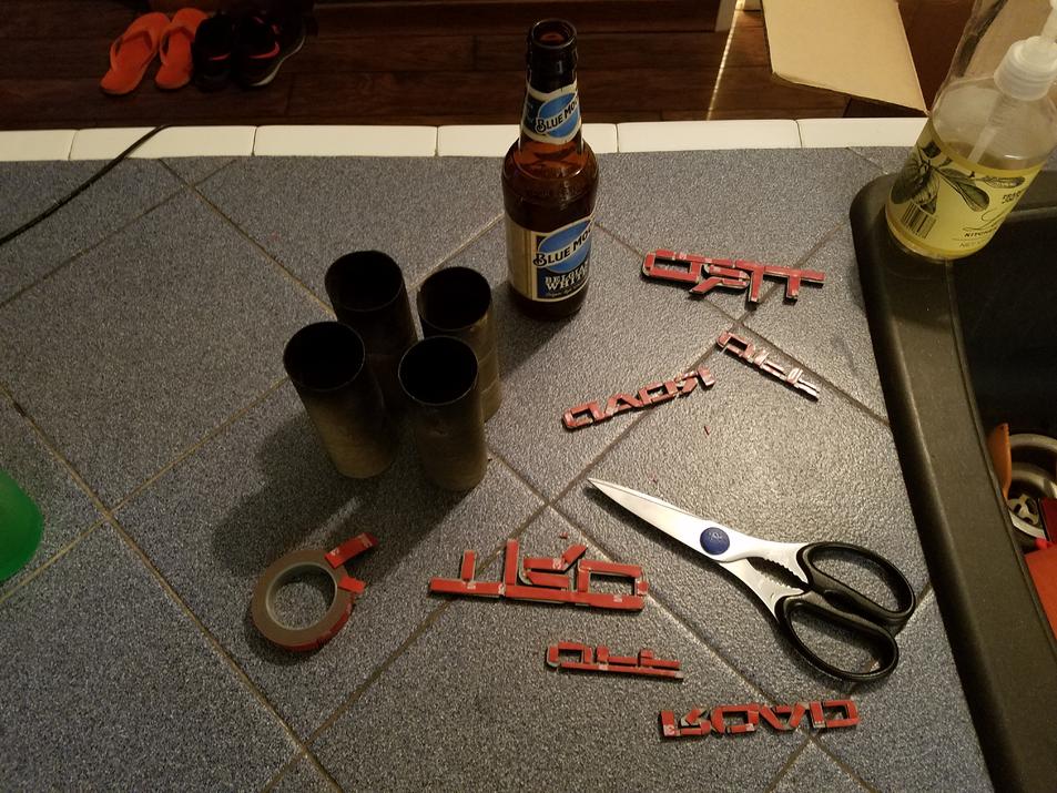

I did this a couple weeks ago. I was having issues with consistency and realizing a few coats in that it was the wrong texture from what we were going for. I don’t remember brand off hand but it wasn’t the plasti dip brand and the finish was more rough than we wanted. Ended up buying a different finish but same company and the finish was much better and more forgiving Among that and other trial and error issues I ended up taking the badges off, spraying them then reapplying to the truck.
I went to Walmart and bought goo gone, fishing line, and some 3M automotive molding tape.
I ran blue painters tape around the badges real close to mark their place before removing them with fishing line.
I was going to hang the badges using fishing line then spray but I didn’t want lines from the lines (lol) so I used empty toilet paper rolls stood up on end the placed the badges on top. Worked very well. Between coats I went and used goo gone to take the adhesive off the paint.
Once the dip dried I took the tape and very tediously cut the strips to fit on the back side of the badges, making sure to cover every surface.
At the truck, I simply removed the backing of the tape and aligned and place the badges back where they came from.
Sorry for the crappy collection of pics but I wasn’t planning on a write up. I hope you see enough for it to make sense. 1 set of badges came out ok but the other set not so much. They all look alright if you don’t look too close. Lol.
I wish I had decided to do it this way in the beginning because I do agree that the little gaps proved difficult to peel from between but i am going to just buy the black badges and apply them soon.

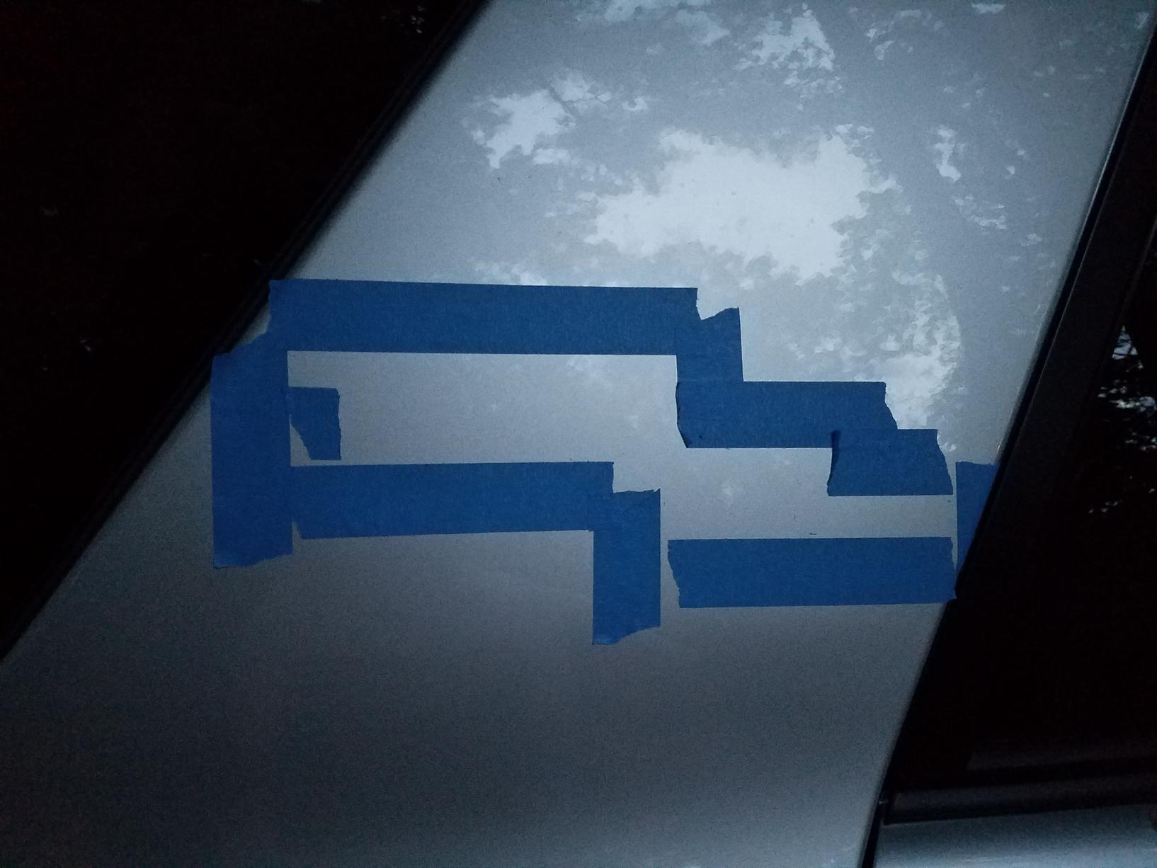

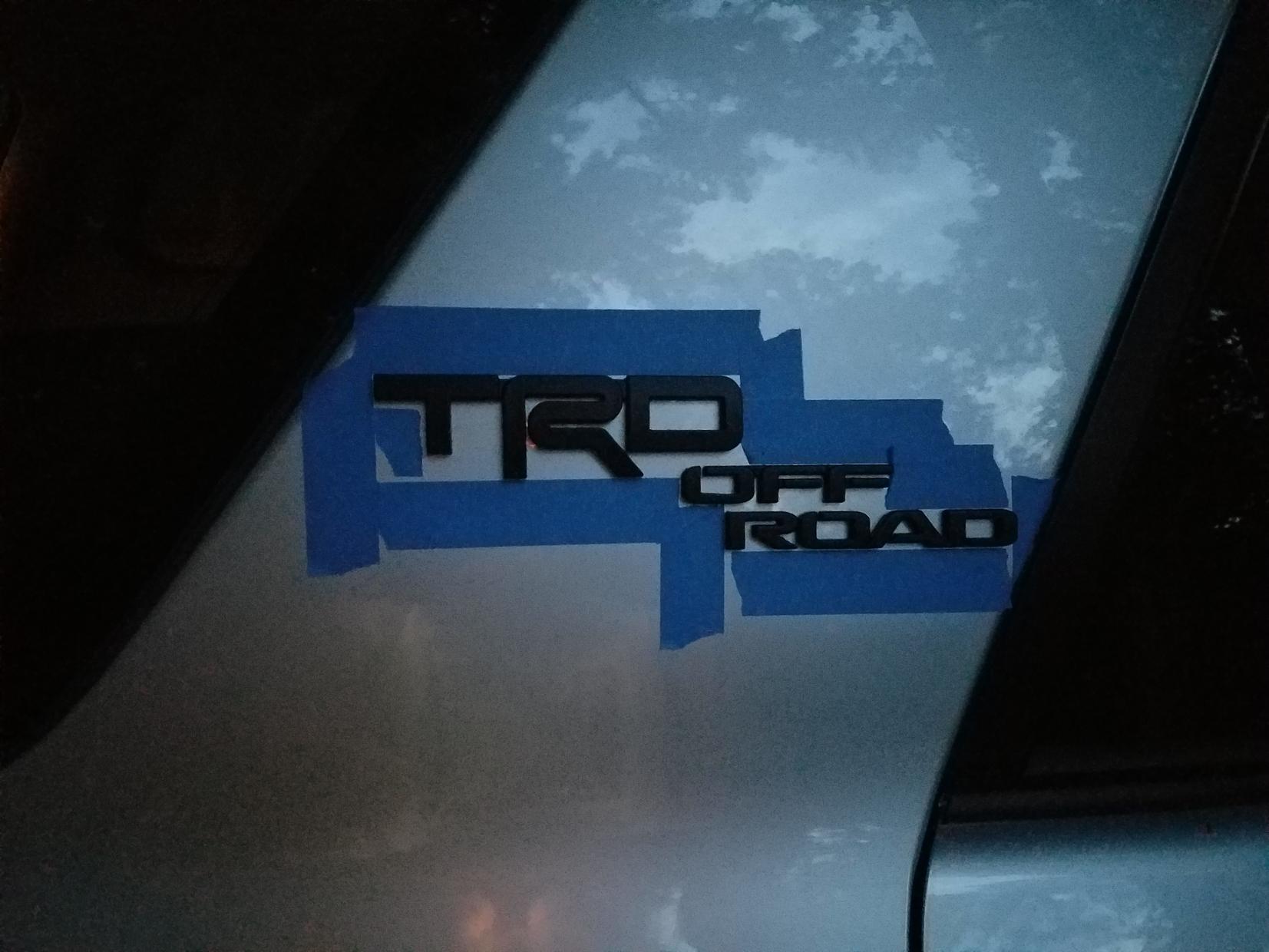

Didn't feel like searching for the one that I used. But you want about an inch of the vehicle's paint exposed away from the badges to give you enough plastic to grab onto when your peeling off the excess dip. Most videos have the tape really close the bag itself, which makes it a pain to remove later on. Also, use a spray wax or get your car waxed before you start the process then remove the wax on the badge itself with an alcohol swab.
Remove the hard to reach pieces of excess plasti dip with a wooden toothpick so you don't scratch your paint.
