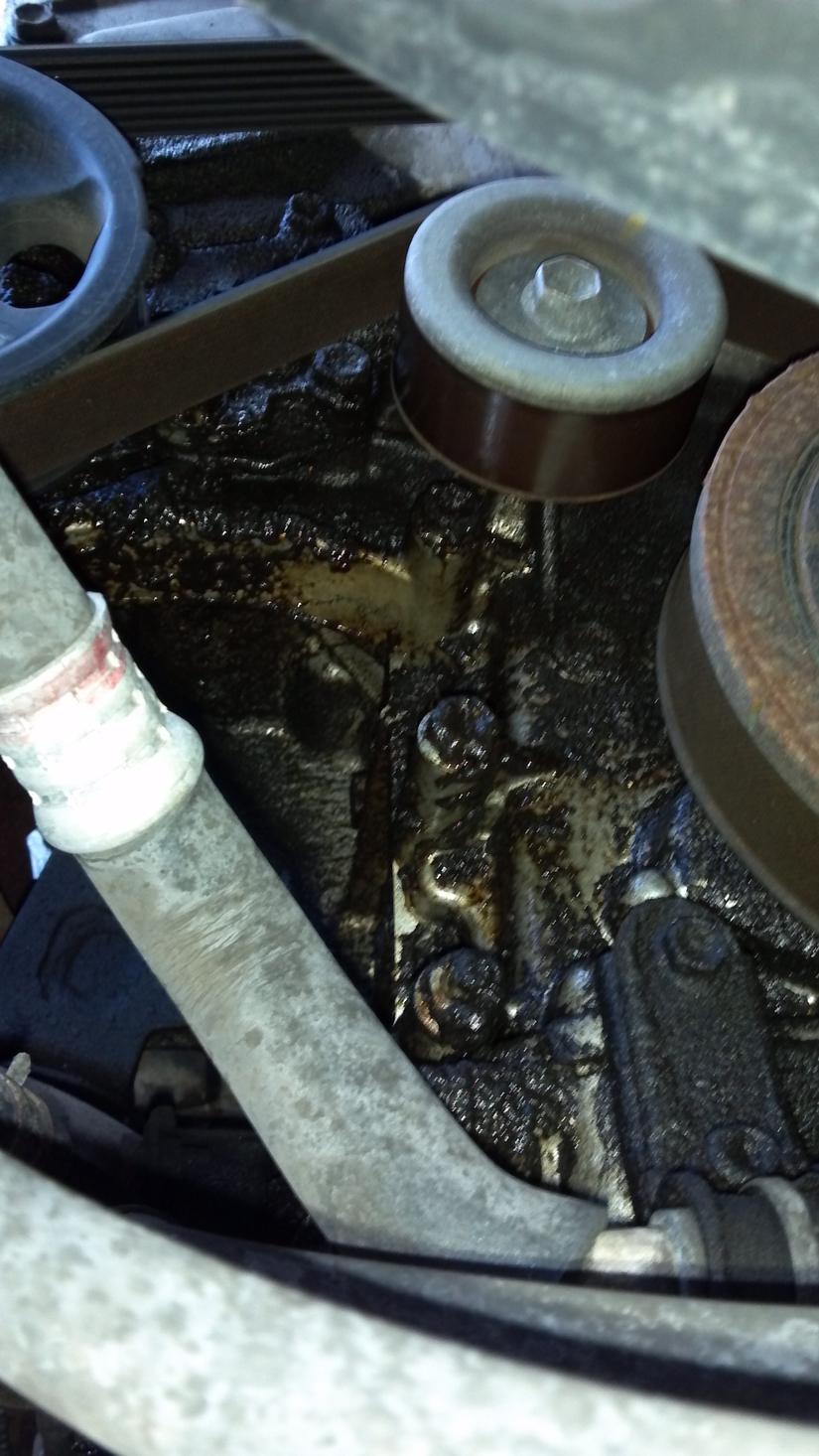

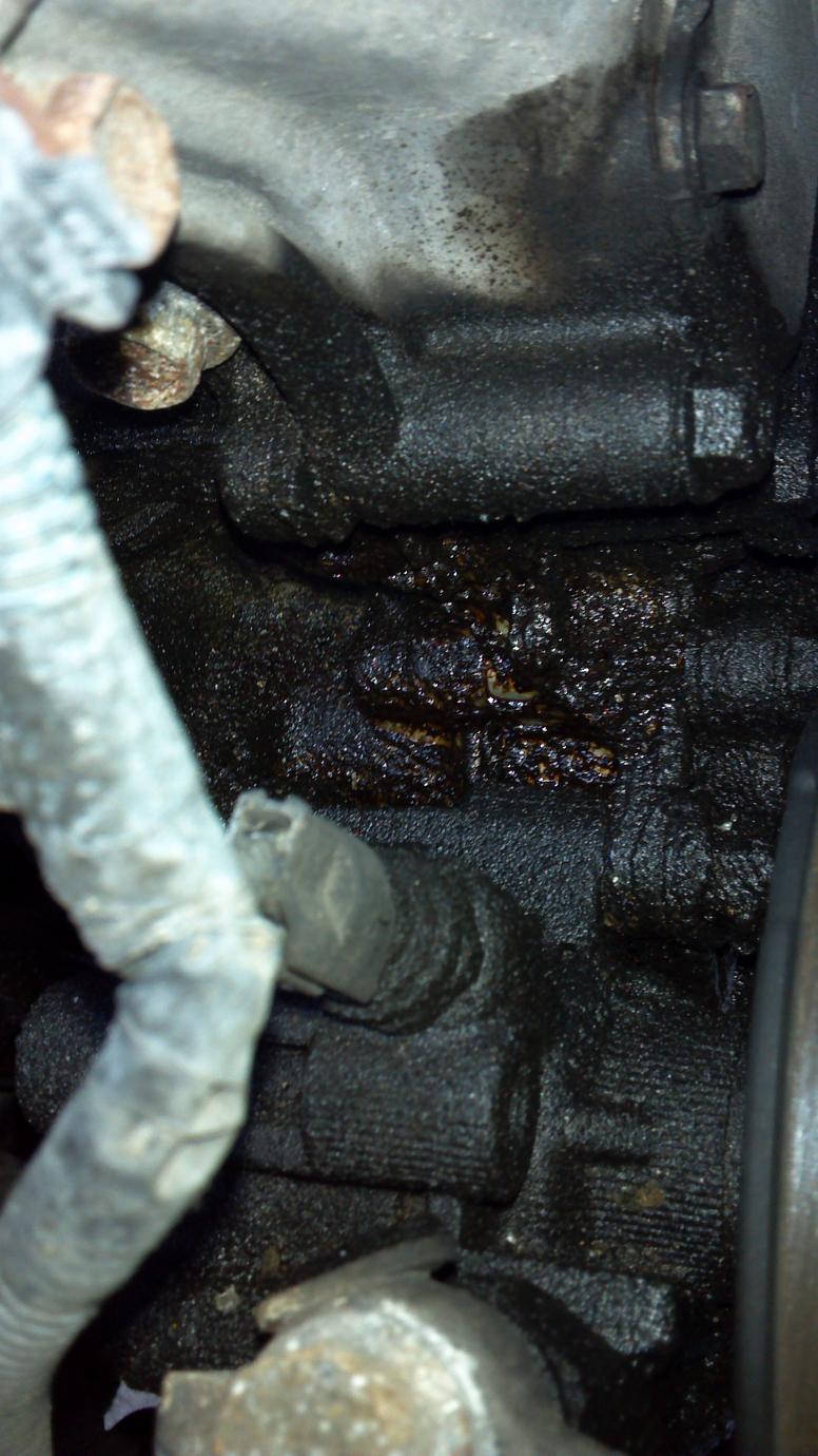

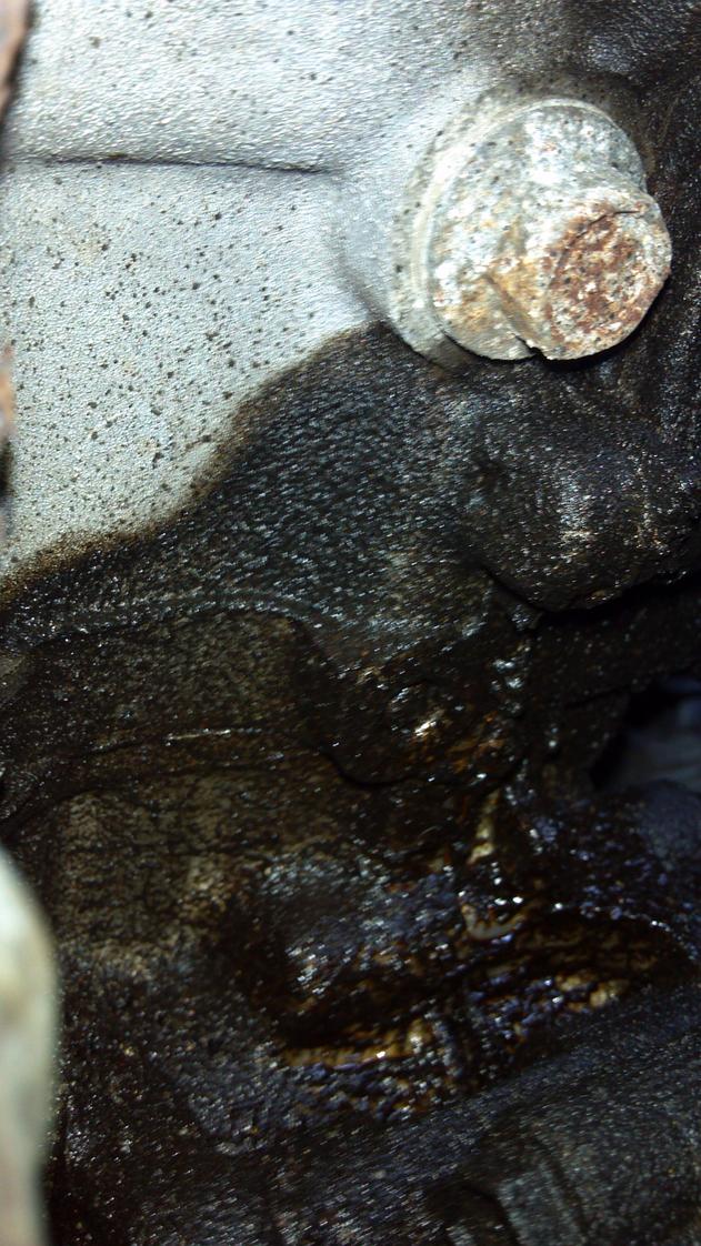

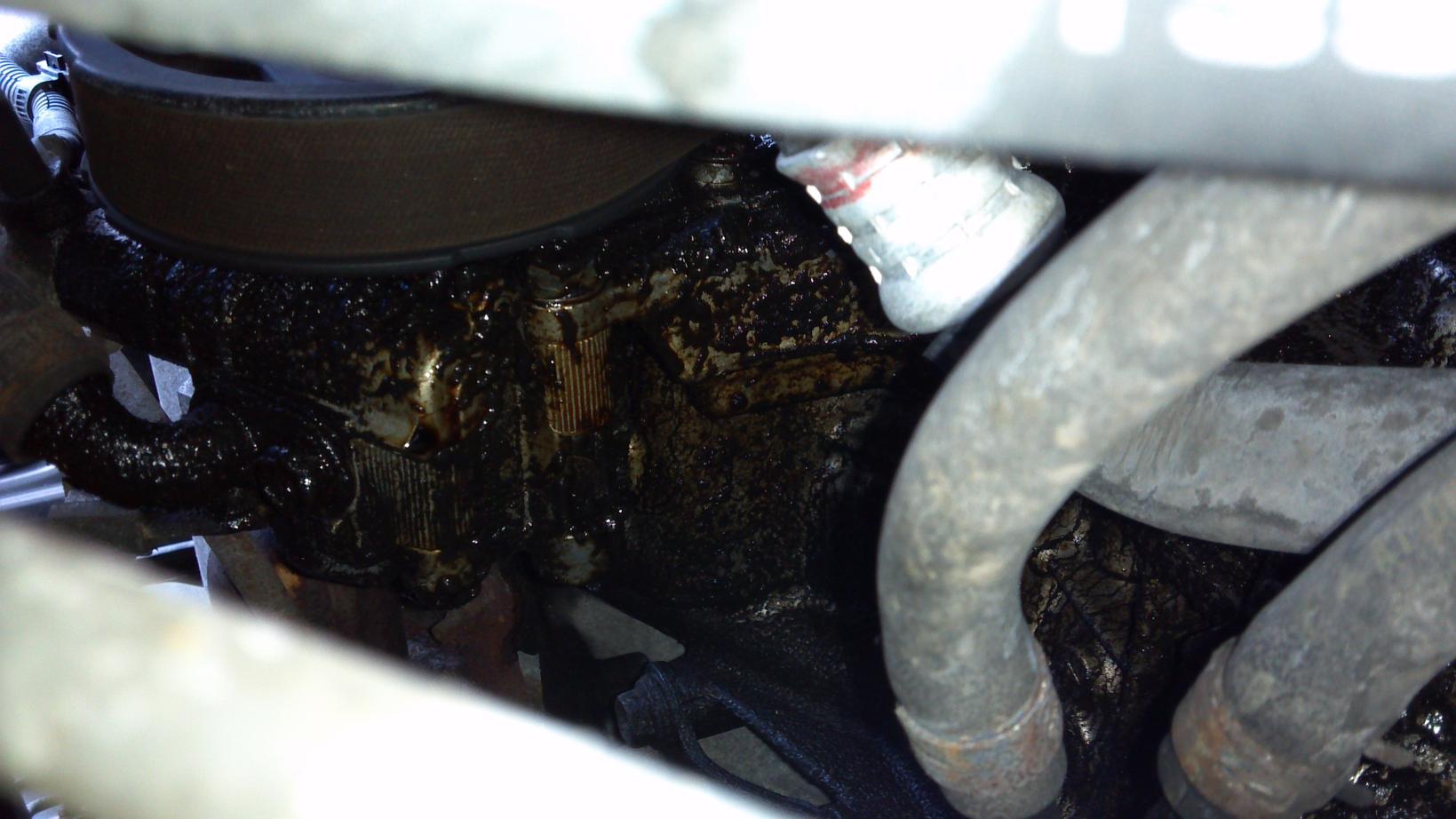

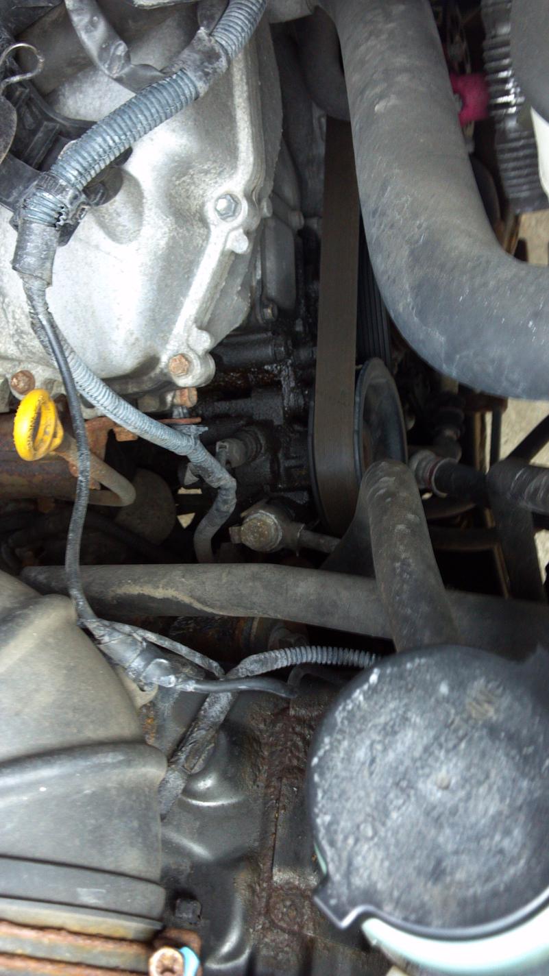

Changed my oil this weekend and saw a lot of black sludgy residue on engine around power steering pump area. Here are a few pictures from above and below any input greatly appreciated.

guessing it's a v8 based on PS pump location?
Wipe that crap away and see if it comes back, get a leak down test. coolant levels? overheating issues?

That is way to much oil to figure out where it is coming from. Clean it off and keep your eye on it.

Yeah I really havent experienced any other symptoms. Im going to clean it up this weekend. One thing I should add...I recently had issues with the steering so I flushed the power steering system, still had issues. I eventually tracked the issue back to the u joint assembly portion of the steering. However, my thinking was maybe the PS pump blew gasket or something awhile back. Although the sludge is black and chunky not red.
I had the exact same mess last spring that had been bugging me for almost a year it's from the steering pump bearing pretty sure just slings it around. I used some stop leak since I think it's just seals and then some degreaser and a a brush got looking pretty spiffy, I have only had to clean it once since but doesn't seem to be leaking anymore.

On a more serious note, I would keep an eye on the oil level and power steering fluid levels. That could be a valve cover gasket leak, but it does seem like the power steering pump could be the cause. The 1GR-FEs do have a history of leaking timing chain covers, which could be the culprit as well.
At this point I would buy some strong de-greaser and clean the engine off as best as you can, top the fluids off and keep an eye on the fluid leak. If you're really feeling adventurous, buy some engine oil dye and add it to engine oil, then drive about 100-200 miles and use a UV Light to see if you can find the source (if the UV light doesn't show the engine oil as this sort of highlighter yellow, it would point to the steering fluid being the source since you only add dye to the engine oil).

I had oil in the same spots when my valve cover gaskets failed. I had them replaced along with the timing chain cover seal and the water pump under warranty.

I wonder if the gaskets would still be under warranty. I registered with toyota awhile ago and havent seen any recalls and I am the second owner. Either way I have done valve cover gaskets in the past, so once I clean it up hopefully I can get a better idea where the leak is...
