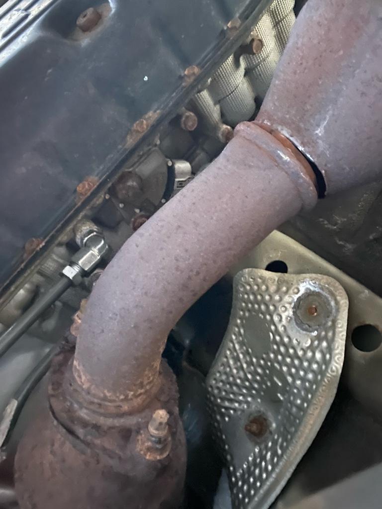

There was one minor leak and I was able to fix that, but that wasn’t the problem…
Looks like all that jarring has cracked this pipe connected to what I believe it’s a cat.
Could I temporarily fix this with some kind of exhaust tape? Or what should I do?

Have a look for "exhaust repair sleeve" or "exhaust repair wrap", slide it over and seal with exhaust paste. That's just what I would try others might have better ideas.

No, don't bother with that temporary goop and wrap. Take it somewhere that does exhaust work or a welding shop and ask them to re-weld it. They will need to tack weld it, then most likely remove that section of the manifold and catalytic converters to completely weld it, then re-install. Fix it right!
I would guess the cat would get hot enough to heat up any exhaust wrap enough to blow a hole into it at some point. Yeah I would take it to a shop for a more permanent fix.

Yea that’s the end goal to get it fixed properly, just looking for something to temporarily hold it over. The sounds terrible and with the shops around here it will probably be a week or two before they can get me in.

Another possible option would be to check the salvage yards for a 4runner, Taco or FJ for the complete manifold and cat.
A good welding shop/exhaust repair shop should be able to repair that on the vehicle, just weld it fully around

Oh no… well, ive got a temporary patch on right now and it sounds decent at idle. We shall see what it really sounds like after the patch cures…
Yea hopefully so… I want it to last for a while since I just put $ into the cat back
