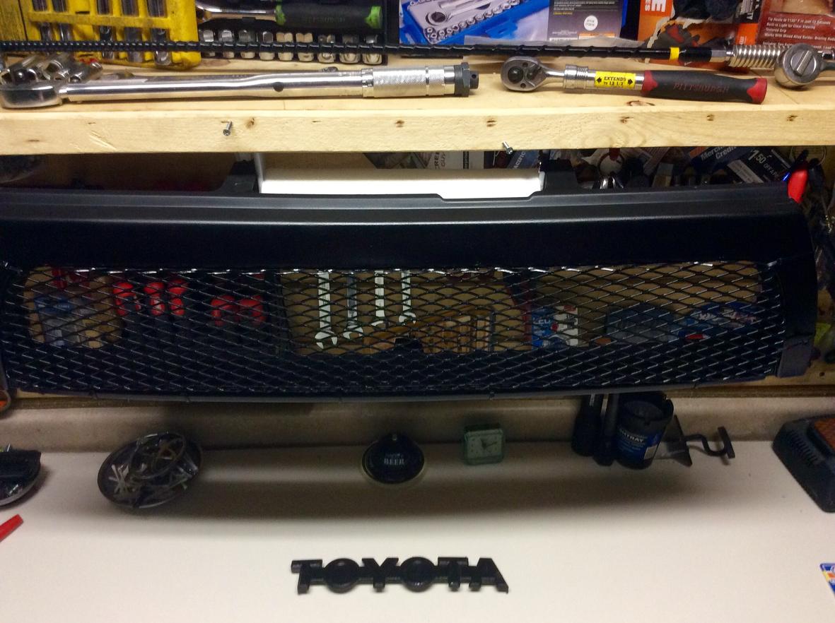

Flush to the front

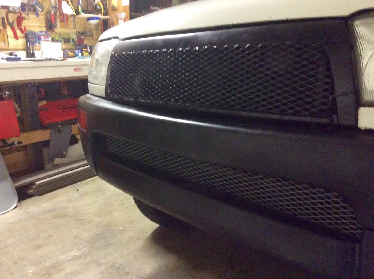

[MENTION=92603]NasaE30[/MENTION] Heres one I did about a month ago top and bottom flush
You will see zip ties in the first couplke pics looking closely that was just
to get it lined up in place before flipping the whole grill over and using Permatex Black Plastic Welder bonding the mesh to the grill frame.
It only took a couple hours to complete everything.. If you need and help with the details let me know if this is what your wanting to do.

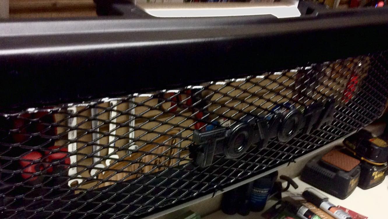

I bent my metal bit to fit inside. It doesn't come out nice and flat as it would the way MStudt offered, and requires some patience...
flush:
satoshi.jpg~original
and inward some so the letters are slightly recessed and vertical:
P7183585_zps2868a25e.jpg~original
1fb1ba97-fbea-4af8-ba12-e73bf9d602df_zps80708842.jpg~original

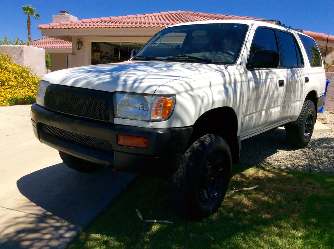

I appreciate the feedback guys. The pictures are a big help. Im going to try this after I get back from vacation. I've got a 98 grille, and just bought a 98 front bumper set to fully backdate the front end. Ill order the grille mesh here soon, I like the round hole style. Ill post pics when I finish up
