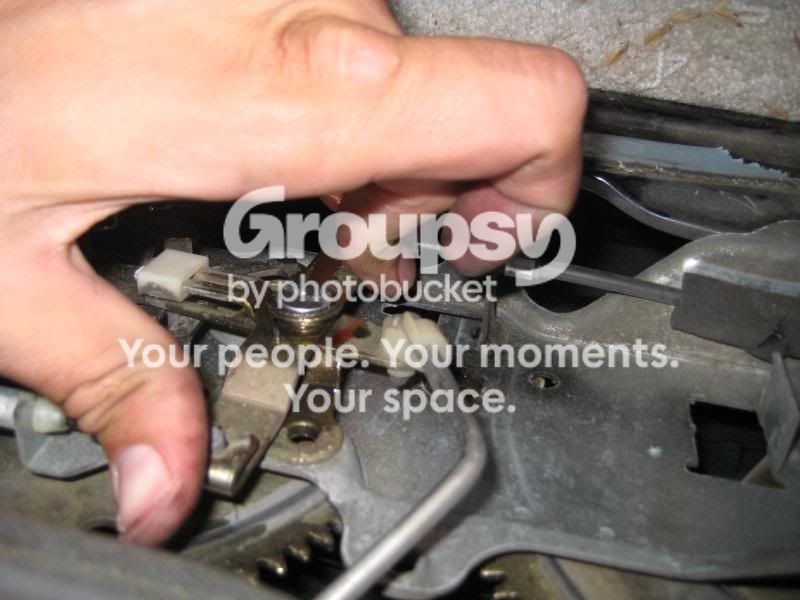

This is the "master wheel" (more of a "cross" really) with the flat head screw/nut with spring in the middle. note the cables at the top and bottom of the "t" - they do not appear adjustable.
IMG_2027.jpg~original
This is me MANUALLY turning the "Master wheel" to open the 2 latches at either end:
IMG_2030.jpg~original

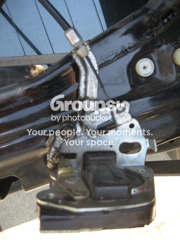

Here you can see one of the latches I took out - and the cable attachment (again, no way to adjust it I don't think...it looks to be fixed):
IMG_2021.jpg~original

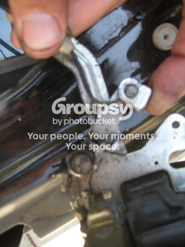

And this is what's supposed to happen with the latch when the handle is pulled - but you'll notice the "slack" on the cable - nothing's happening:
IMG_2022.jpg~original

My lock was a little sticky a while ago and caused a similar problem. Lubricated the lock bar where it attached to the "wheel" and it all seemed to work after.
You might want to check the cables to make sure they move smooth,y in both directions, may have a fray inside one of them.
Looks nice and not rusty in there. Hope this helps.

So, the "coat hanger style" arm that loops into the "t" or "master wheel" shown above - grease that connection up?
I'll take a closer look at the cable movement this weekend - how would I diagnose/treat a fray? Can I just work some general oil/grease in there you think?
The post that comes down from the finger lock part, lube all that moves when you move it.
If the cable is tight inside it may just be a little rusty. If so, you may be able to lube it and wotk it back and forth a few times to get it working better.
If it is frayed, you might have to replace it, if you are able to pull it out from one side then you might be able to get away with removing the broken strands and re-using it.
Good luck with it.

Success!
Just an update.
I took out both the cables tonight and lubed them up with general purpose oil. I worked them back and froth in between oilings. The drivers side one was really sticky - this was the culprit and making the whole mechanism stick. I really lubed it up and moved the wire in/out several dozen times...there was some rust/small debris inside that had to work its way out. Once I made some progress, I reattached everthing. It works like a charm now!!
Thanks for the help :)
