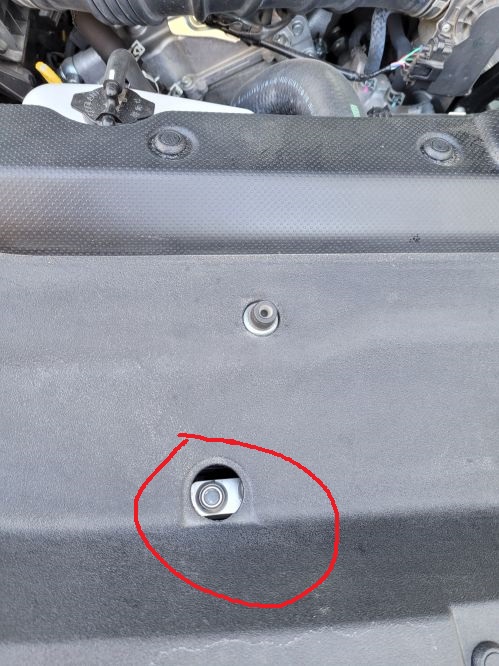

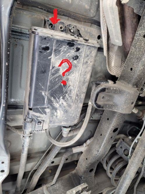

Tyrying to figure out what these components/things/ are.
First is located above the spare wheel - and looks like it's missing a bolt.
Second is under the hood in front of the radiator - looks like a check window of some sort.

Yep,
1) evap canister and 2) refrigerant system window. (no bubbles should be present there. If your AC stops cooling, check for bubbles there)
Technical term
The first one is your Evap canister it's job is to store gas vapors and burn it later in the engine. The second one is a liquid sight glass of your HVAC system it's there to check for air bubbles in the system small amounts of air bubbles are normal when the system is running.
