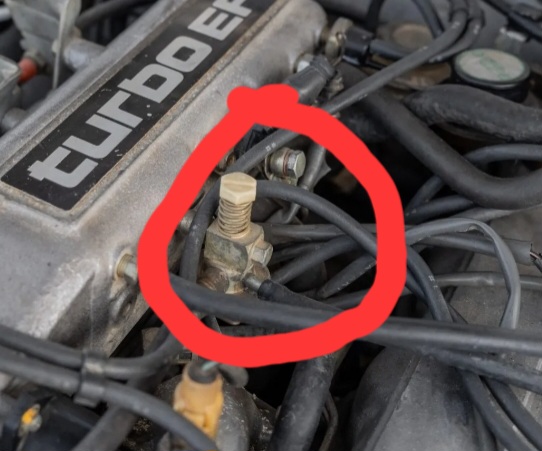

Sorry, kind of new to these engines. Could someone tell me what this is and what it does? Thanks.
One goes to the throttle body, the othe goes down into something.

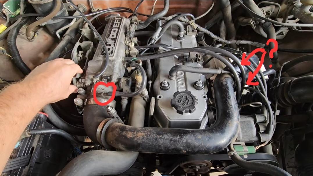

The 1986 4runner turbo I just bought doesn't have this, plus a lot of other parts. I've seen it in pictures of turbo engines and I'm just trying to figure things out.
It came from Oregon to California and I need to get the smog stuff put back on. Thanks.

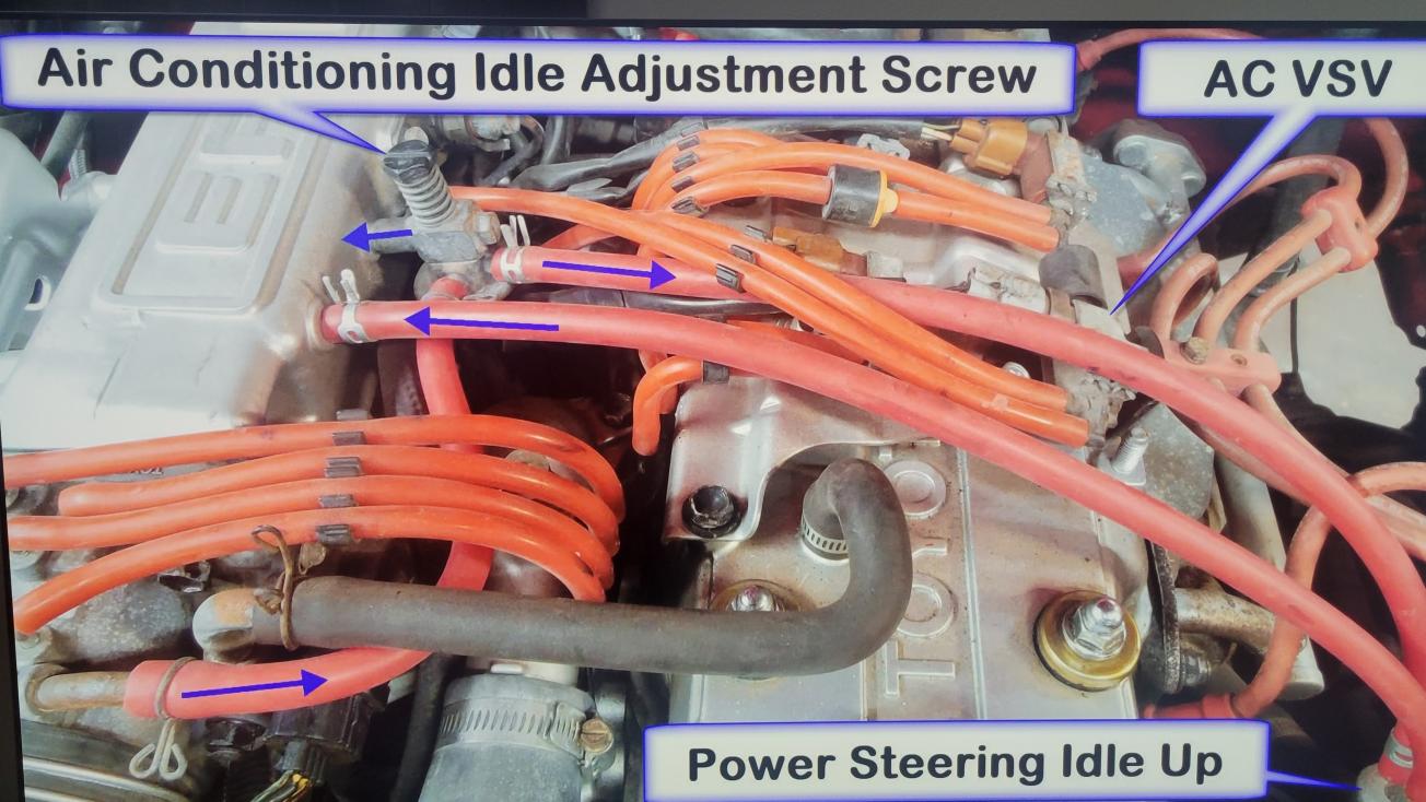

The part in question is the idle-up adjustment screw for A/C and Power Steering.
I highly recommend:
"Toyota 22-RE Engine Overview" by California Trail Map on YouTube for a class on basic understanding of these engines.
