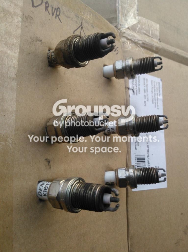

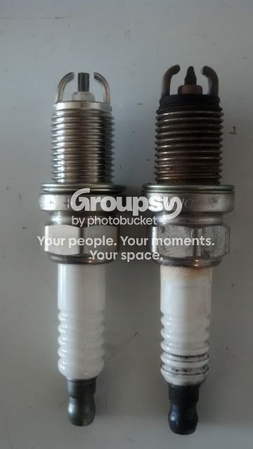

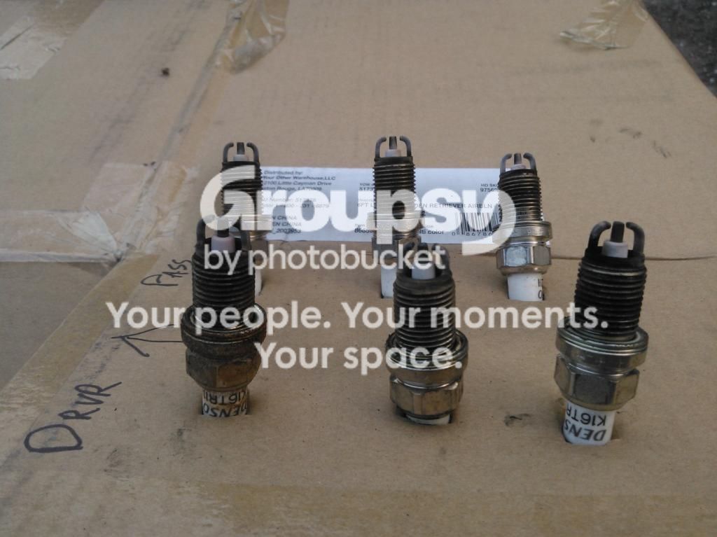

wow your plugs look a lot better than mine! (as far as wear on them, look at your gap compared to mine.
DONT MIND THE FUEL ADDITIVE BUILD UP, JUST LOOK AT THE GAP
notice how worn down my electrode it (the nipple in the center that is supposed to be more of a circle.

Wow I can not believe the wear shootmymime!
I have never seen them that bad.
