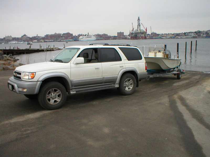

My 99 limited has a hesitation when accelerating after a stop or shift into drive. While pulling my boat at a ramp I have almost rolled backwards in the water. Woah. Not funny.
A colleague recommended new plugs and air filter.
While the filter was easy to replace, how the heck do you get at the plugs?? Sheesh.
Do you have to pull stuff off first. While mechanically inclined, would appreciate very specific steps. Any photos you could point me to?
Thanks.
First 14 inches of snow of the year (average +/- 100). Love my 4 Runner!
