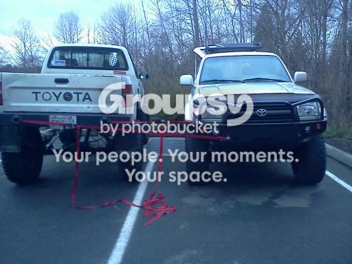

And a shot of me trying to use the wheeler to try and pull my bumper over to its correct spot, unsuccessfully. Almost got the tires off the ground though, its pretty solid.

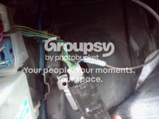

Finally did the grey wire mod today. Works great and now I have full control over my e-locker. Also changed out a worn out rear LCA

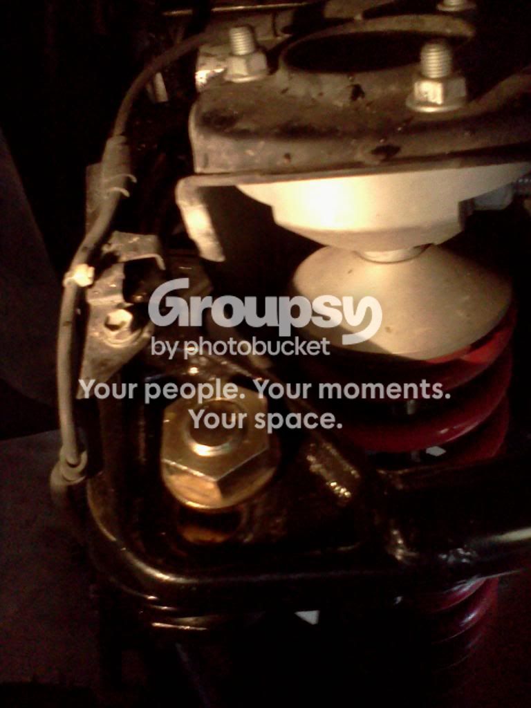

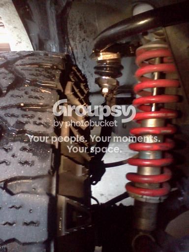

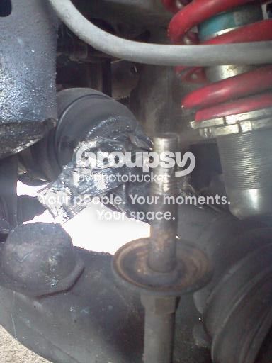

Thought I busted my LBJ today, but turns out I de-threaded one of my swaybar endlinks up front. Made a crazy loud noise, and now is perfect time to install my wheelers poly SB bushings! Dont mind my attempt at the ol duct tape CV boot...

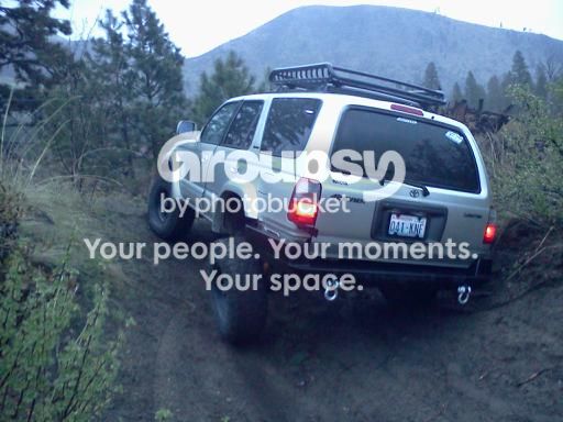

Went to visit the parents on the other side of the state today, finally got to flex it out and make sure it doesnt rub on the body anymore. Looks like I need longer shocks now.

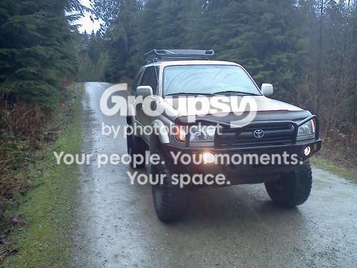

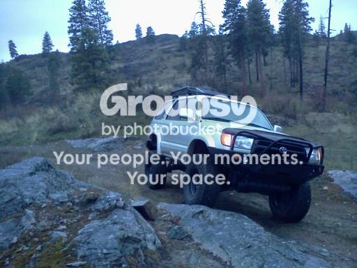

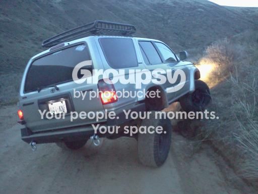

Did some light wheeling today on my way to a secret fishing spot. Also got my 9 wraps but bought another project before I could install them. I'm currently using my shocks as bump stops right now, they probably wont last long that way so I will wait until my LC shocks come in before I throw the 9 wraps on. The added travel is much needed.

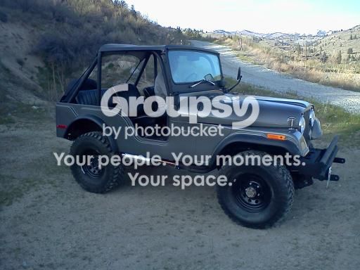

And heres my new CL find I just couldn't pass up for the price, my "new" 1973 CJ5. Boo jeeps I know but I love the 304 V8 and the short wheel base. Its going to be the new hunting rig I guess. The wiring is a mess and the undercarriage could use some work, but it will get me to stop dumping money into my DD 4Runner.

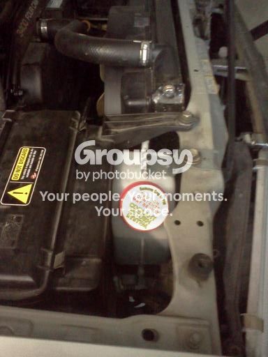

Relocated my washer fluid reservoir to clear some room for incoming 35's
Write Up

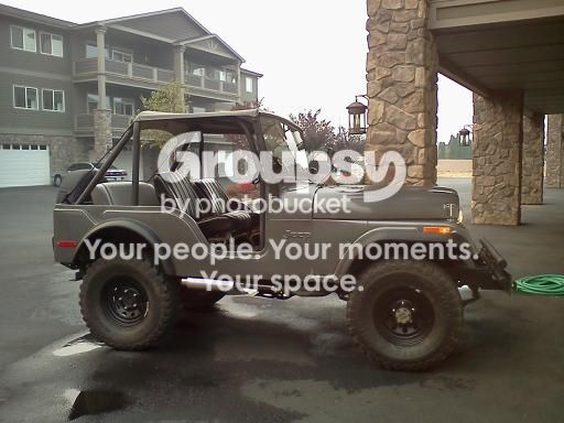

Sold my CJ5 yesterday. Tried the jeep thing again, still didnt like it.
cjfive_zpsb3f3e124.jpg~original
Now that the heep and the wheeler are gone, its time to get my UCAs on to make room for 35's. I abandoned my manual trans swap to keep multi-mode for lots of on/off melted, bare road, and hardpack snow during long winter trips. Manual hubs are still in the works.

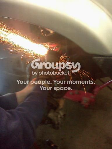

Finally got my Light Racing UCA's in today. First side took about 3 hours due to a busted rental BJ press from Oreilly's, so we ended up cutting and notching the ball joint until we could pound/press it out.
UCAon.jpg~original
The other side went alot smoother and alot quicker, busted it out in 50 minutes. Going in for an alignment tomorrow morning and advancing my caster 2 degrees. 35's here I come!
