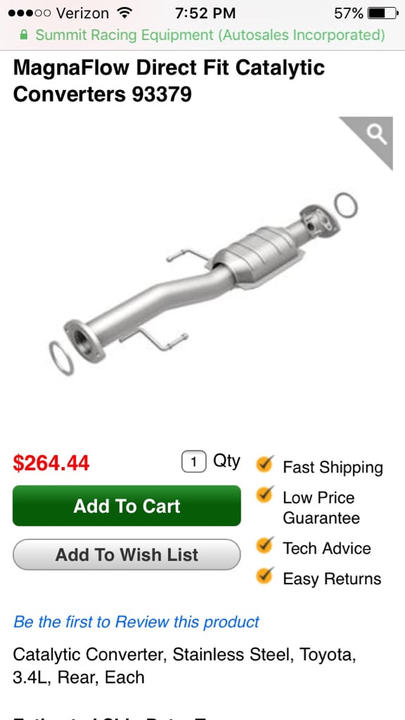

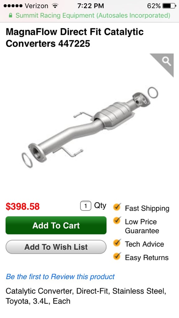

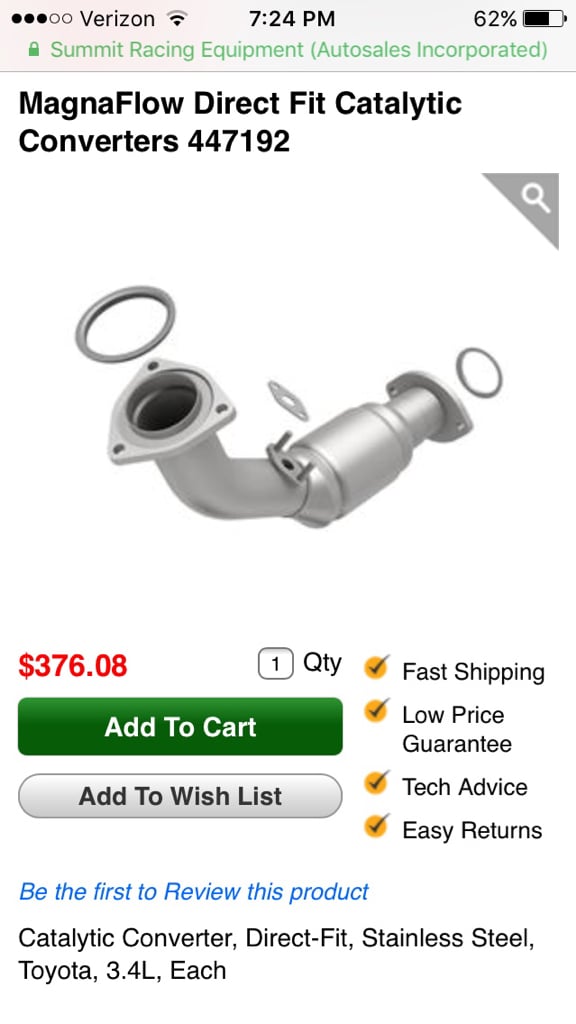

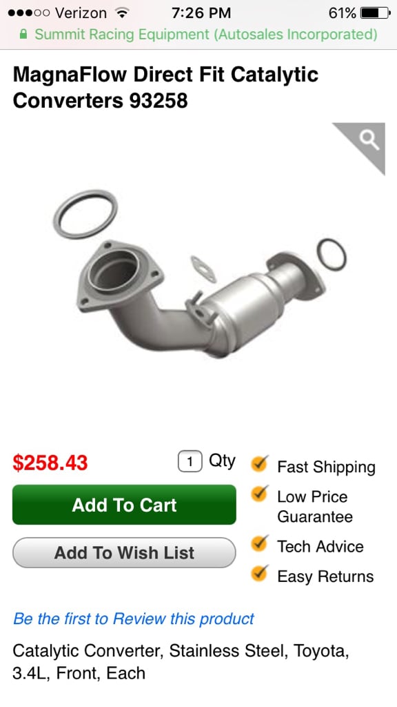

I will be fixing this myself and need to know which if aftermarket cats will work or if these are like other Toyota parts where only oem will work.
If aftermarket is ok, I plan on using magnaflow direct fit parts.
Has anyone used these and knows the difference between the different Downpipes and mid pipes?

what year is your 4R?? If you have a 2000 and below, these Cats will work. If you have 01-02 you have an 18mm threaded type sensor. You can get an earlier (flange type) but don't know if the j-connectors are the same.:shrug: Magnaflow only sells 'flanged type Cats'.... just thought you should be aware of this.....
Thank you for noticing that, I didn't catch it
I called walker customer service and despite was summit racing says, walker has both kits in the correct fitment for my 2001.
