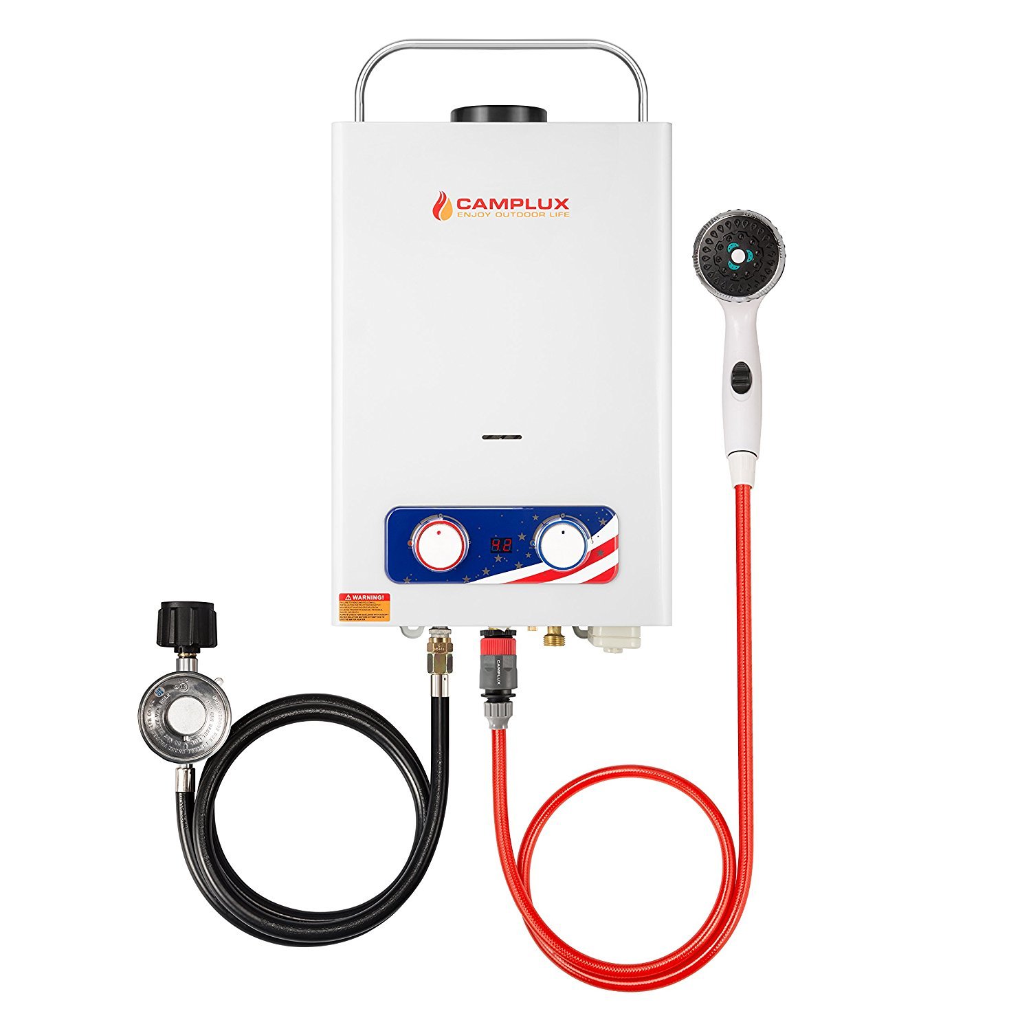

A part of me wants to make a portable setup for this and take it camping haha.
Like this ?
