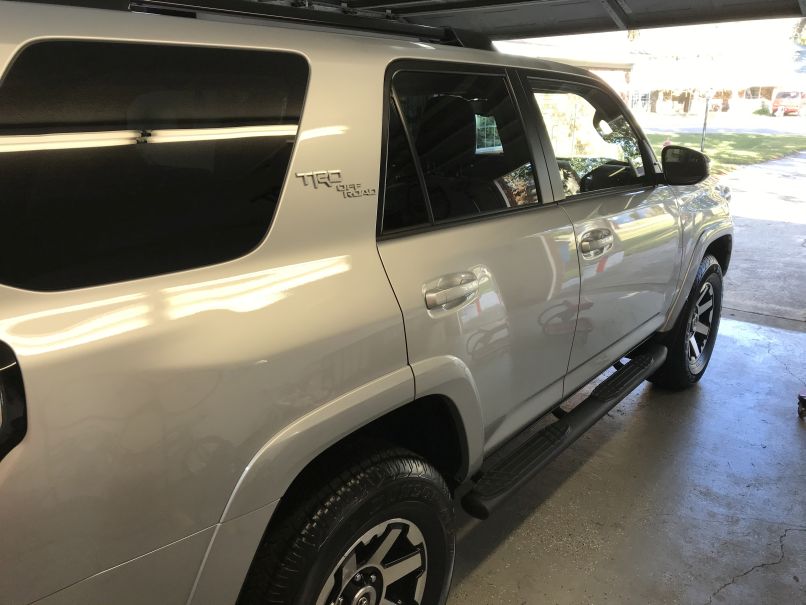

4runner related, I used it to give a good polish and extra shine before I ceramic coated my TRD OR
