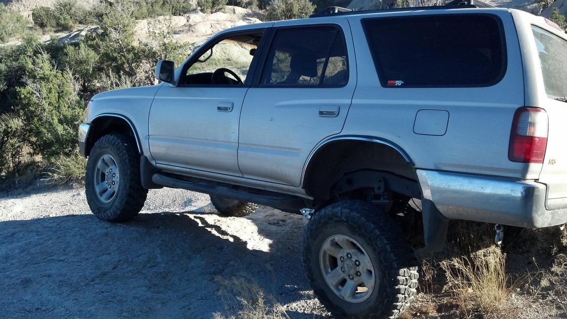

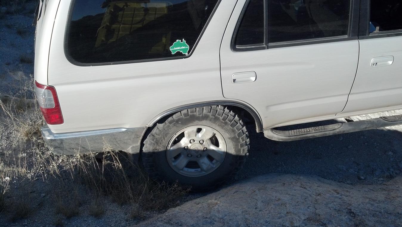

Off road, I disconnect the rear only. When the rear is disconnected it feels so much safer off road. So much more articulation and wheels stay on the ground. When the rear is connected I feel like I am going to tip over on rocks.
On road, I have them both connected.
