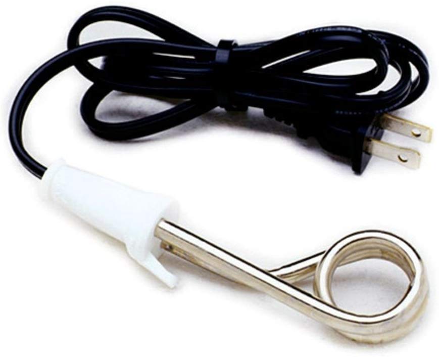

Do you guys think this will work out from 400W power outlet located in back
Norpro 559 Electric Immersion Heater Warmer 300W For Water Tea Coffee Soup
Thanks

I've actually been looking at getting one of those myself. I don't see why it wouldn't work, pulls less than 400w
I have the 110V one and the 12V one.
The 12V is way less wattage (around 120W) and takes way longer to heat water.
The 110V one should be fine at 300W on a 400W inverter.
300 Watts will heat up 2 gallons from 60-120 in an hour with no thermal losses. What are you going to use it for?
The problem is that you can only pull 300W from the inverter when the vehicle isn't running. While it's running, that outlet is clamped down to 100W. 300W is a battery drainer, and could leave you in a no-start condition in relatively short order (depending on the capacity and condition of your battery).

IMO - The 120v unit should work fine. Engine running, shift in park. It will take 2.5 amps from the inverter and the inverter will take 25 amps from the T4. The inverter is on a 40 amp line and fuse.
I expect the alternator will keep up and the battery will not be discharged. If concerned, run it for another minute after the heater is finished. :tea:
