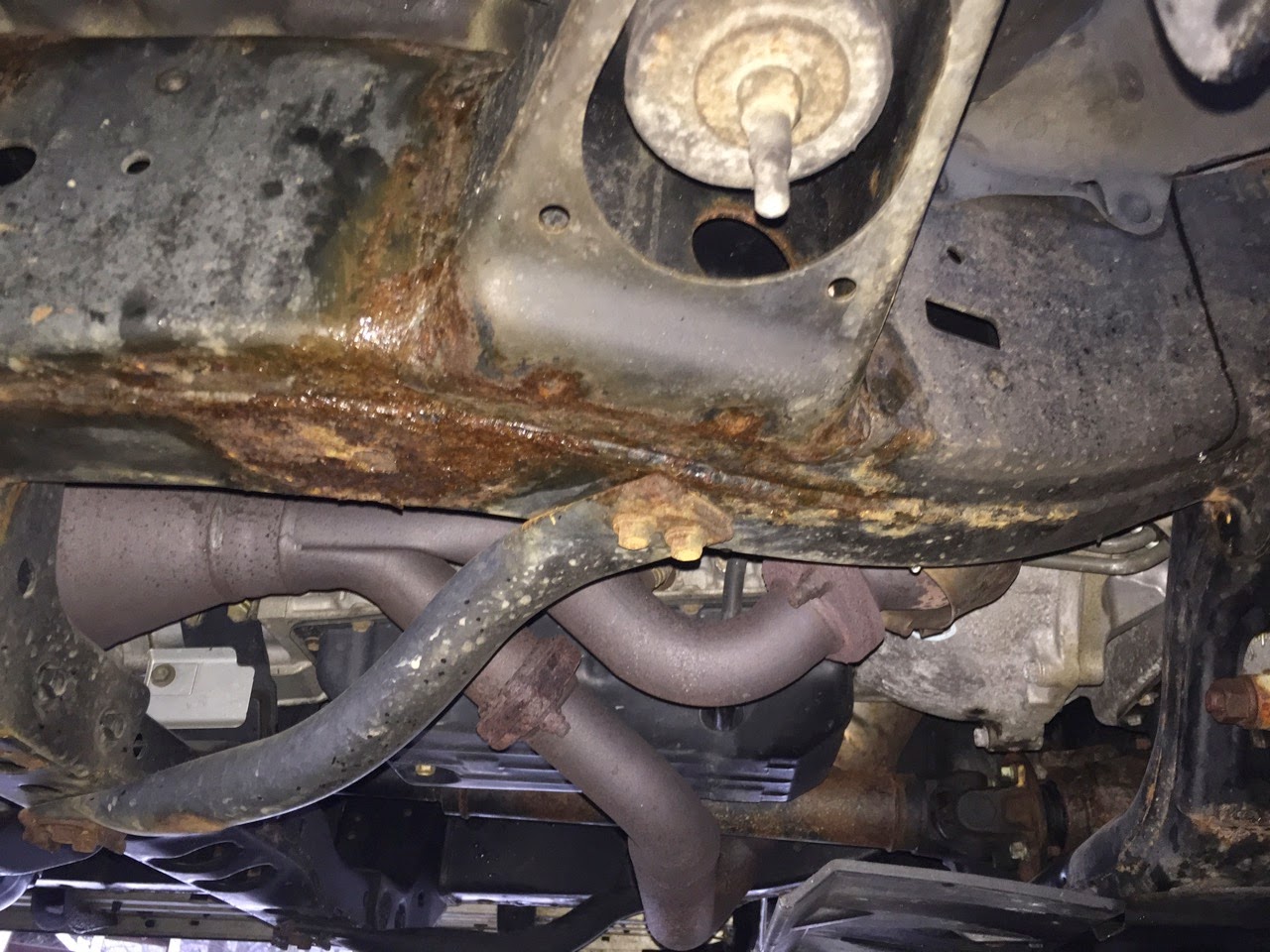

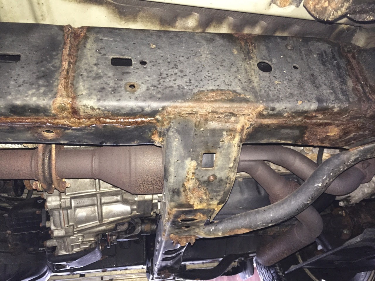

Everything sounds pretty good. Had seller send photos of the frame and I'm wondering how much rust is acceptable? The one side seems fine to me, the other...hmmm. I'm just not used to trucks or Toyotas on this issue. Thoughts welcome.
Thanks.
buy it and immediately service it with fluid film or POR-15... add $50 for the former and $250 for the later if you apply it yourself.
that's not bad to be honest, looks like surface rust to me...and that's common on every undercarriage that uses salt in the winters in northern states. It's pretty much unavoidable if you actually drive the car in the winter untreated/ unprotected.
