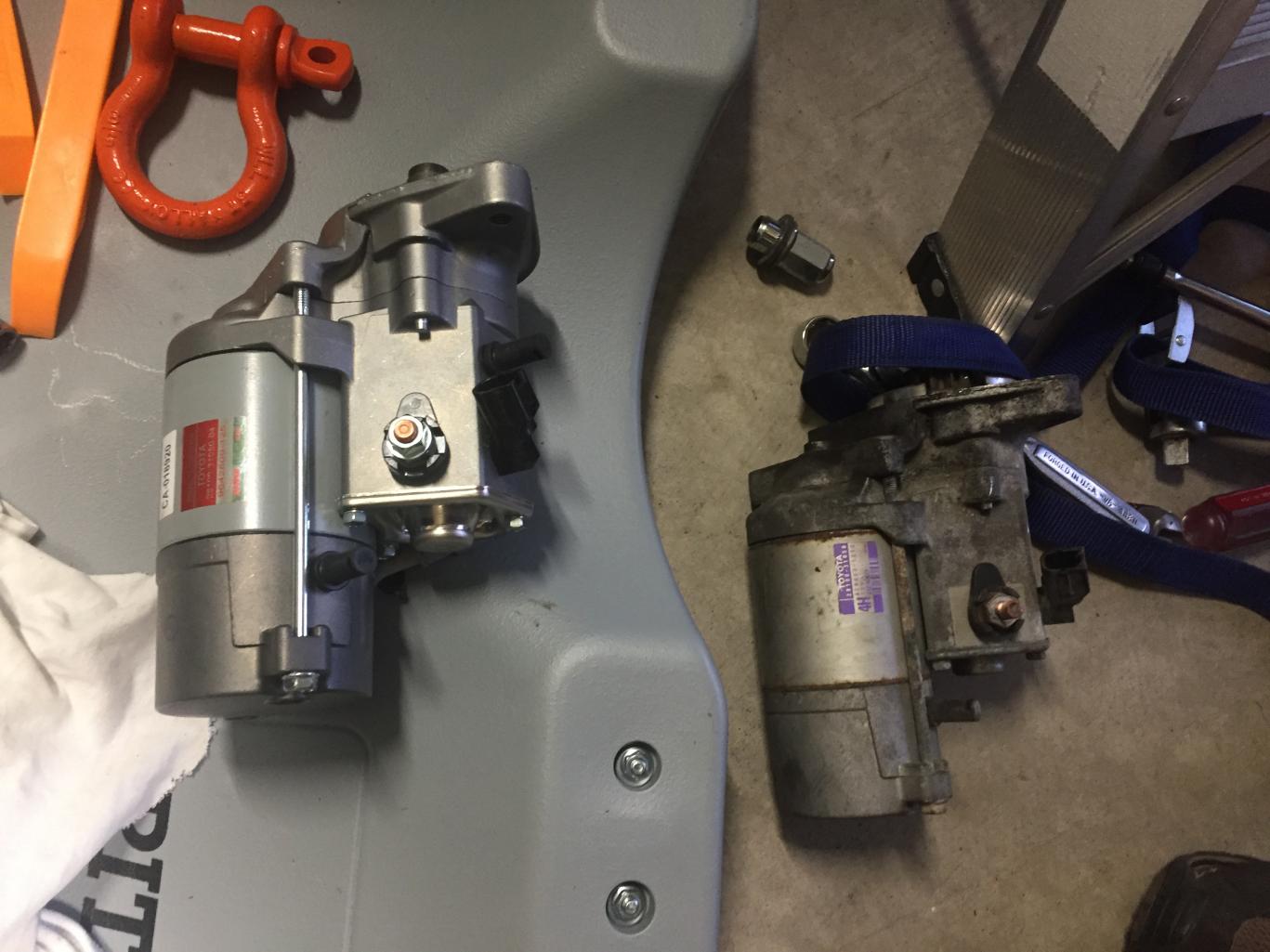

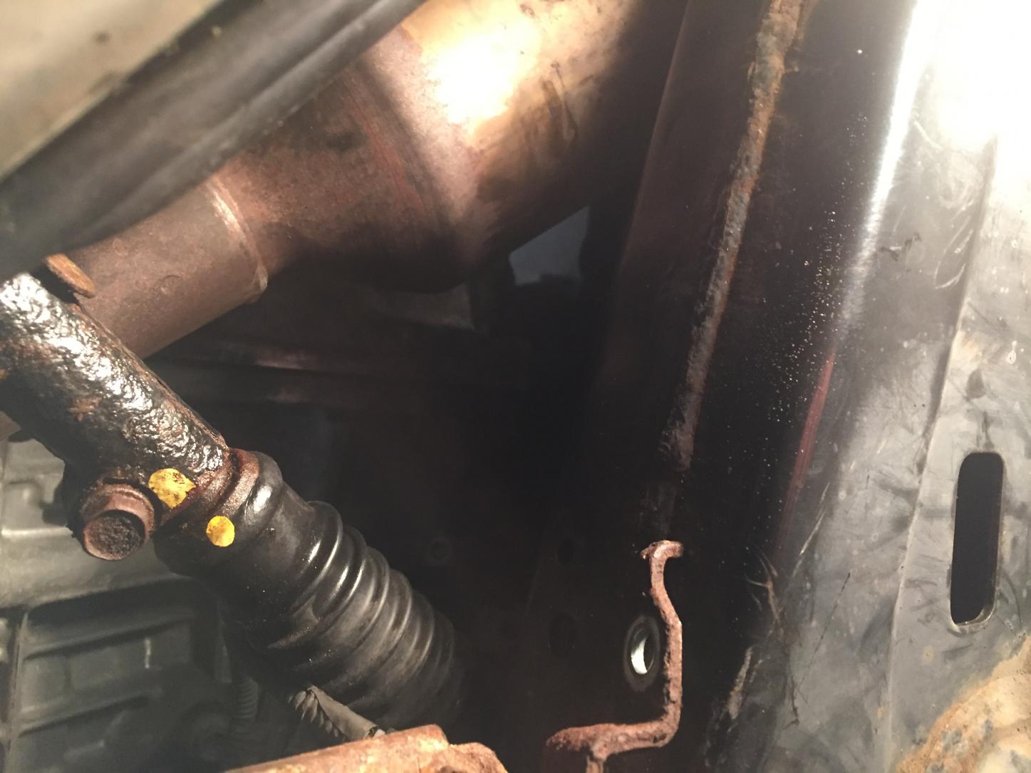

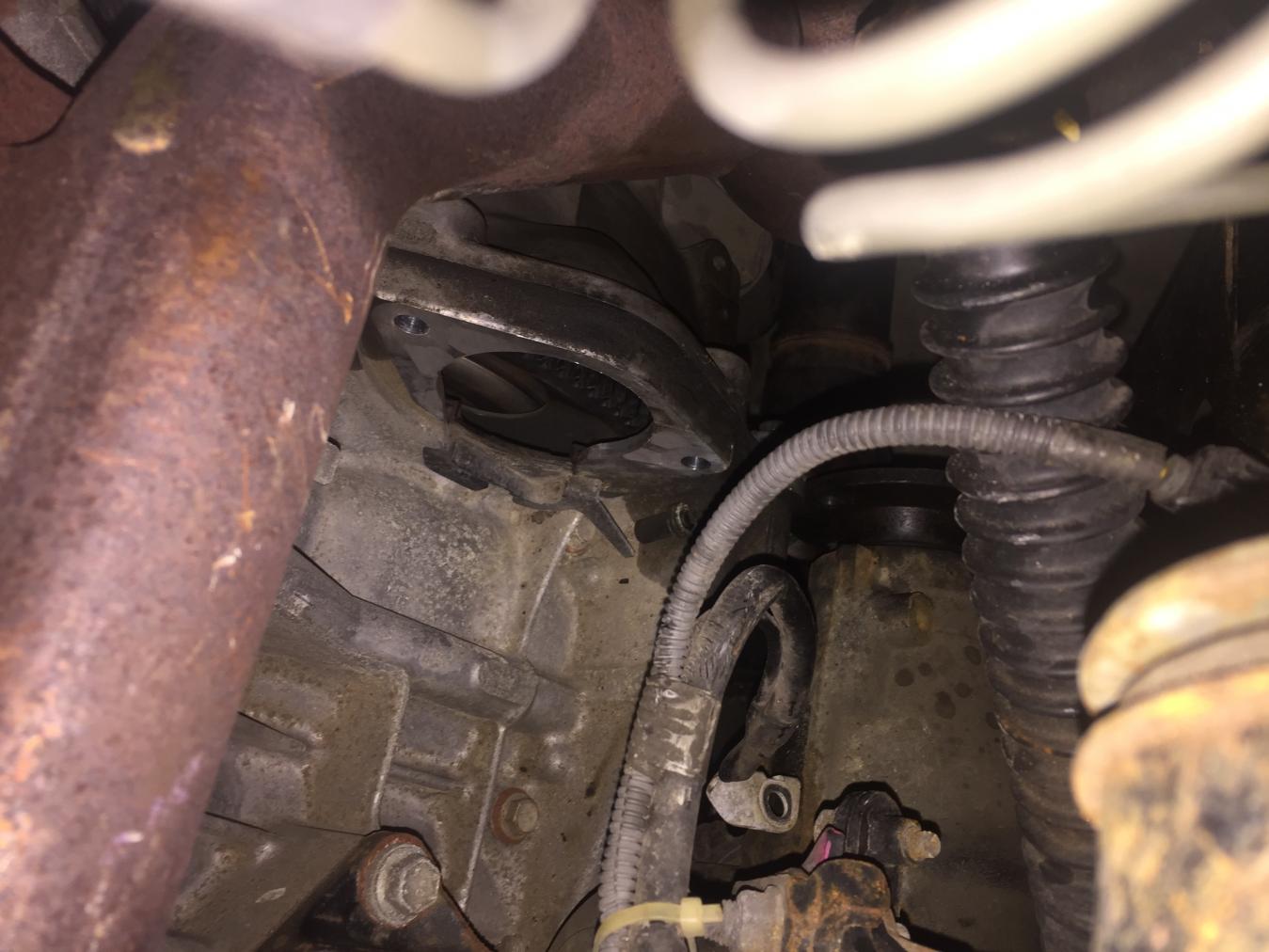

I replaced the starter on my 2006 a few months ago. It is really in a tight space, but accessible through the wheel well. I removed a brake line bracket to get it in out and in. The hardest part was getting one of the bolts off the back. You’ll need a ratcheting wrench, I forget the size (a socket didn’t seem to fit).
It is doable. I watched a few videos first.
Conicelli Toyota (partznet.com) is having a sale right now. The code is Partsmadness10 for 10% off. Their prices are good to begin with and they provided a fedex shipping label to return the code.
Good luck.
In these pics you can see the starter and how it bolts in at the rear of the unit. The next pic show the brake line bracket I removed. The last pic shows what the area looks like after the starter was removed. You can see the hole where the rear of the starter (with gears showing) goes in.
Sorry the pics flipped to the side.
