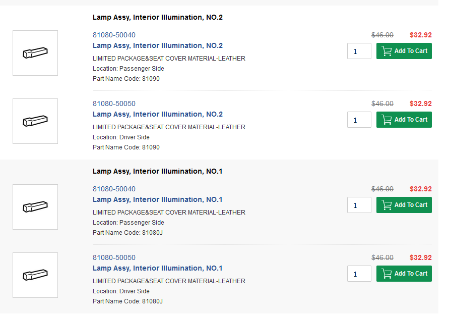

I may have found the part numbers for the footwell LED modules
My mom has a 2012 4Runner Limited. It has the amber/orange LEDs in the footwells up front. I noticed her passenger side one was not working. Not sure if these are it or not, but cross referenced them on Google images and they look like the module I pulled out from under her dashboard. I am going to give it a shot. If I can remember, I'll post an update. I know it's a few years late, but maybe this will help someone. I found the following part numbers on toyotapartsdeal.com:
Lamp Assy, Interior Illumination, NO.2
81080-50040
81080-50050
Lamp Assy, Interior Illumination, NO.1
81080-50040
810800-50050
