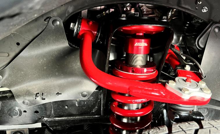

Love the ride, only thing I can compare to is Eibach pro lift that I had on my 19 GMC Canyon and to be honest, that ride sucked after a 3" lift. These Toytecs rides smooth even on highway dividers/transitions, takes bumps, man holes, pot holes like a champ. Like others say that it rides more firm but not stiff, and drives more sportier compared to the soft ride it had. I'd buy it again. Along with the JBA uca, the color compliments each other. (see pic)

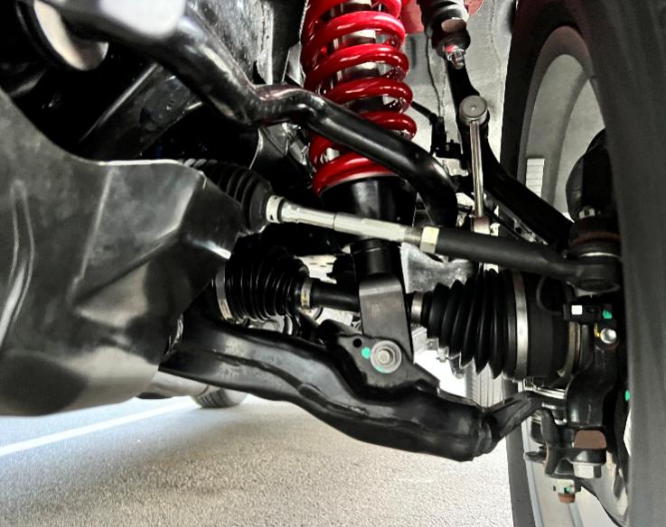

Correct. Im hoping that my diff isnt screwed up while riding with it. The angle of my axles are about the same with it. (see pic)
