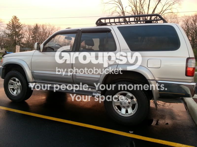

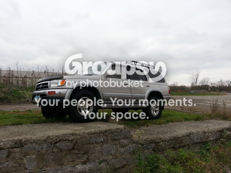

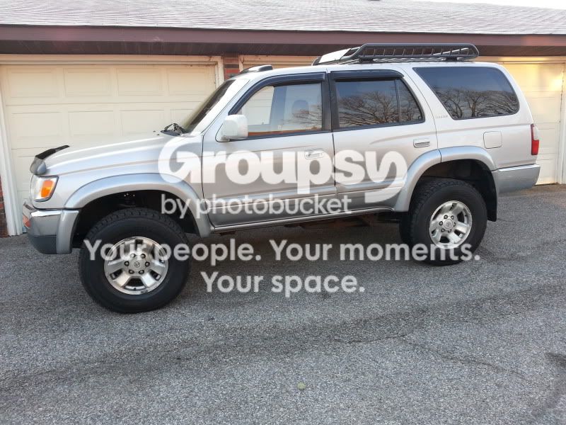

Wanted to update you folks. After settling I was 1/2" lower on the driver side (front and rear) I bumped up the Bilstien 5100 one notch in the front tonight. Now it's almost perfect! I'm only about 1/8" lower on the drivers side rear than the passenger rear.

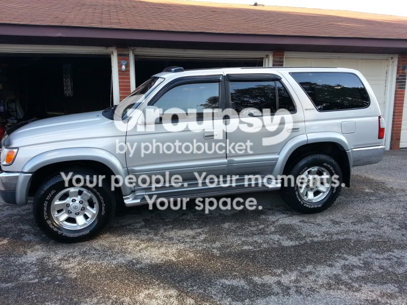

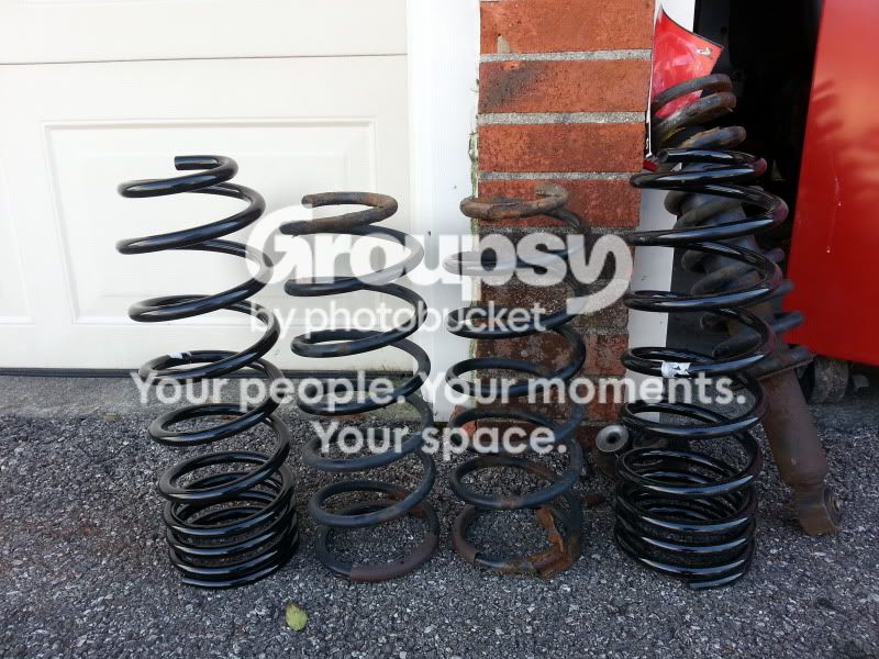

As promised, here's a few pics from before leveling.
Before it all started..

New tires and rack
20121027_162325.jpg~original

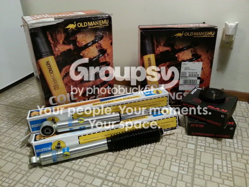

Lifting fun begins
20121109_180013.jpg~original

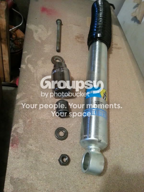

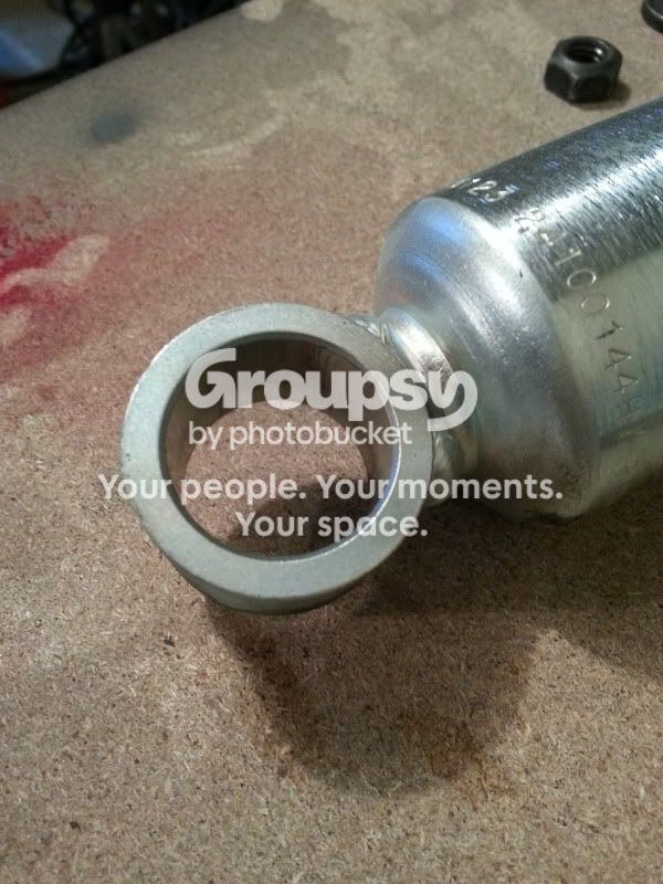

Socket worked like a charm for pulling rear bushings
20121108_203843.jpg~original
20121108_203931.jpg~original
Old and new
20121111_120944.jpg~original
JACKED (with and without running boards, I think they'll stay off :) )
20121112_171358.jpg~original
20121114_080432.jpg~original
