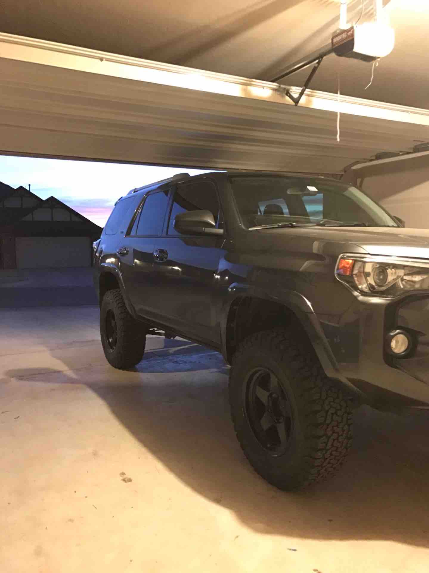

That being said, I had my Toytec/Bilstein 3" lift installed last night. They said the rear axle sits off to the right about 1/2 inch after the lift. They said this is common after a lift is installed on any vehicle and can be corrected with another $300 part from Toytec.

Thanks in advance, below is a terrible pic of the lift, wheels and tires. Sorry for the garage pic and dark lighting

Yep, common. Many manufacturers sell adjustable bars, so take your choice.
The axle is also move back in the other direction when the rear end squats, etc.

When I lowered my Mustang years back it did the same thing ... had to get a Whiteline adjustable Panhard bar to center the axle.

It's not necessary with 3" of lift or less. Most of us on here do not run them. I have had zero issues without it.
