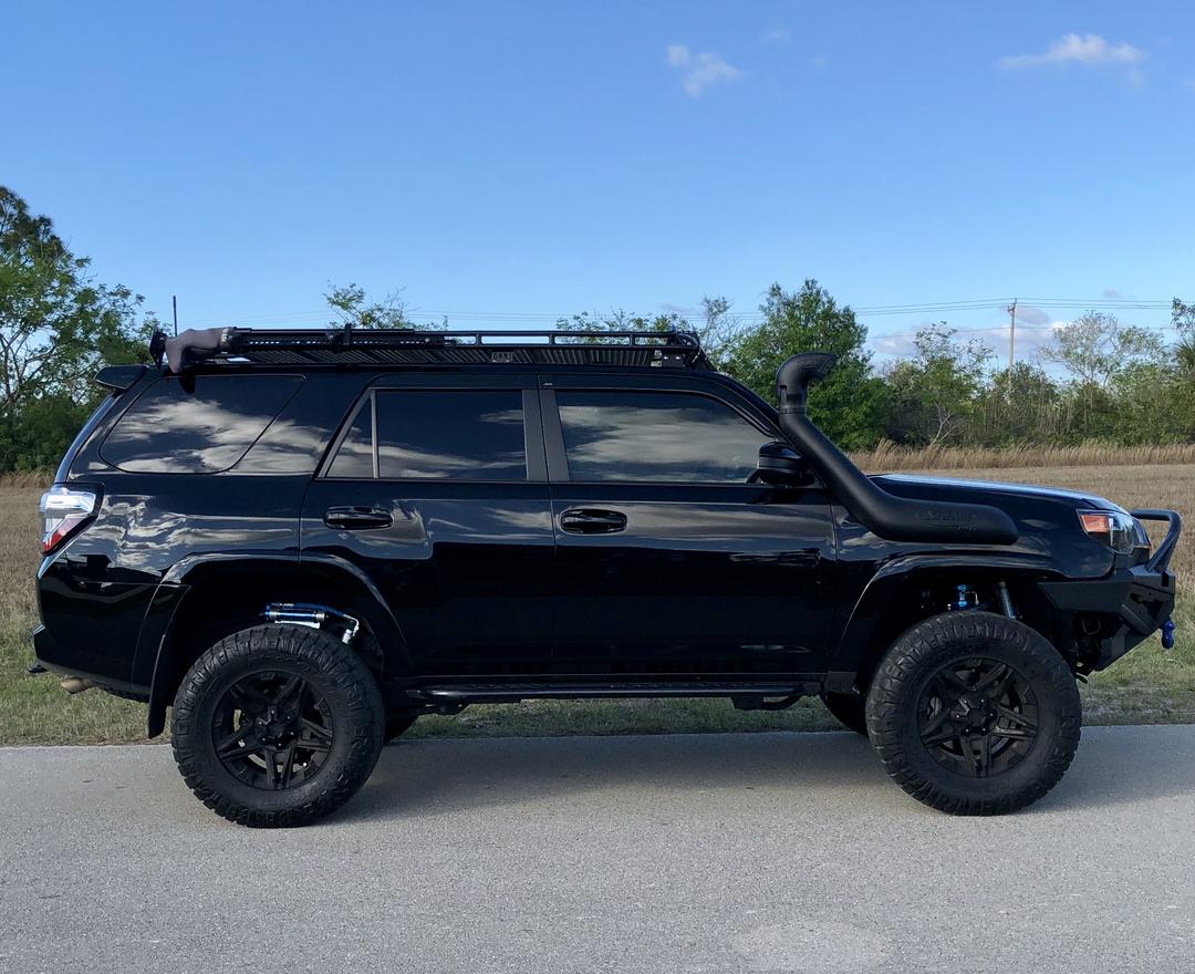

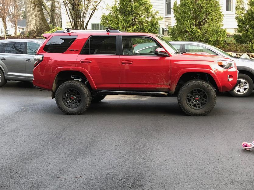

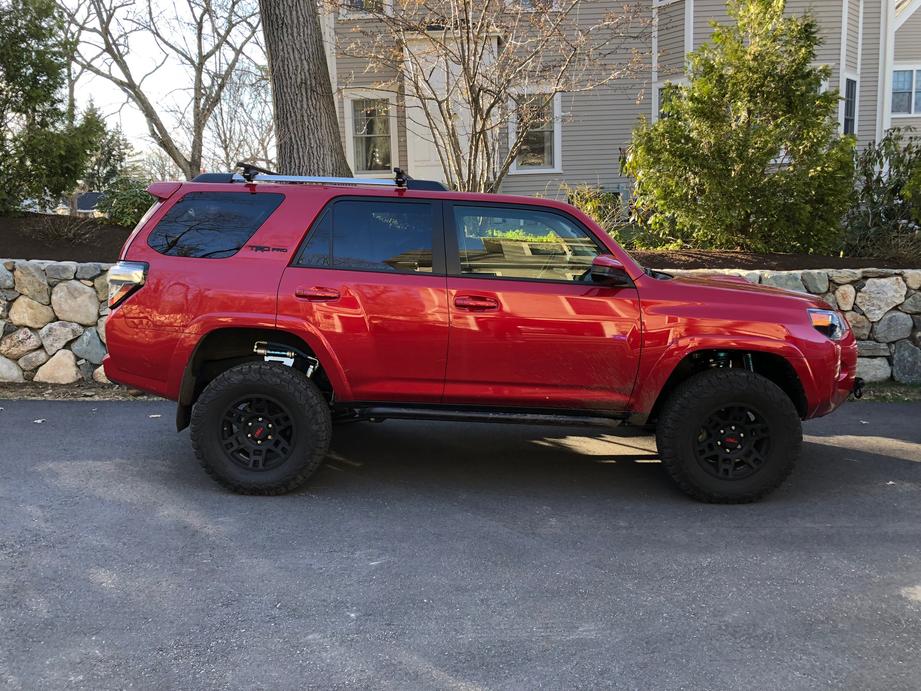

Hi folks. Lifted my 2017 TRD Pro yesterday.
Front
King 2.5 wRes. Extended travel(center spacer removed)
SPC UCAs
Rear.
King Custom length
OME 898 Heavy(440lb) rear springs
Pre measurements
Driver Front 20.1" Rear 23"
Passenger 20.5" 23.1/4"
Post 21" 25"
Driver 21 1/4 25"
Additional weight is RCI aluminum skids except the gas tank which is a C4 steel skid, RCI sliders, Front SSO slimline with a warn winch, Arb drawers, arb fridge
I'll try putting the front on a lift and see if I can adjust the shocks. My guess is I may just pull them off and adjust.
Any comments/advice appreciated. The TRD setup is available for local pick up..cost=a case of sam.

Heavier springs up front or close to factory spec with just a lift? That SSO bumper and a winch (~130 pounds) lost me 3/4" up front until I replaced my factory springs with medium weight OME 885's. Adjusting the front shocks MIGHT help by adding preload to the springs, but another pair of springs to offset the extra weight up front would probably be a better bet.
Unless you add a bumper or run it loaded all the time, those springs are going to feel like a sledgehammer on rough roads--and they're not going to settle down ever.

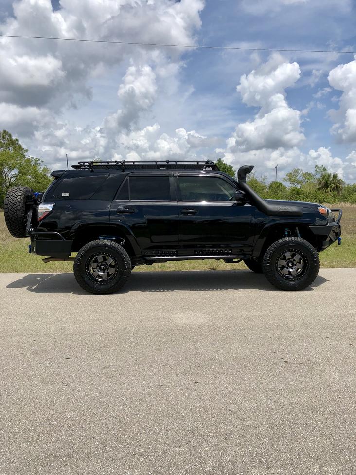

I agree with the others about needing to go with lighter rear springs if you are not doing a rear bumper. Your ride is going to feel crappy. I have similar lift Kings 700lb springs in front set at 6 threads showing. Rear I have dobinsons 2” 327’s. Had small rake until I added the bumper. Now it is even but I wish I had had the small rake back so I might switch to 3” 701v rear springs. I do have a 3rd row as well. Before and after bumper pics.

Thanks...Any other advice on weather I should adjust the preload or go with stronger springs. Its only another 140lbs additional with the bumper and winch.
And sliders and skids split between front and back. THere is way more rake than it looks like in the photo

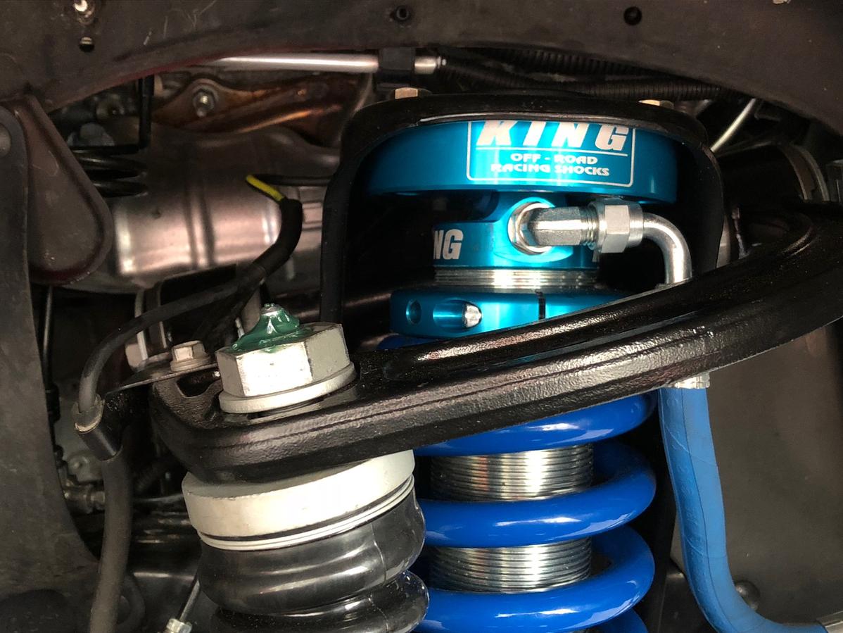

Thanks Mike! I'm going to add 1/2 an inch of preload to the front coilovers and see how it looks. Curently I have no threads showing. If there is still too much rake and since I have the Toytec RCC 2.0 rear springs I may swap out the 440s until I get a rear bumper on. I was planing on the CBI last month till I saw the Pelfrey stuff come out.That should drop the rear some. Currently I have the RCI alum SKids, C4 Steel gas tank skid, ARB drawers and a portable second battery/solar generator in the rear..so about 300lbs before I load any weekend gear.

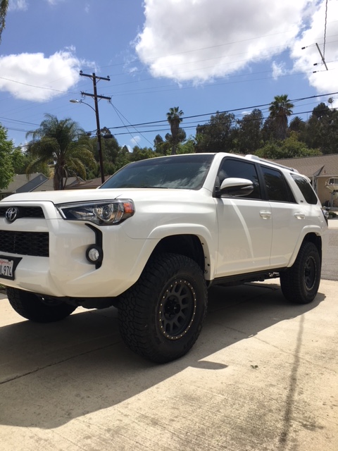

Bilstein 5100's set at either 0.85" ( very slight rake), or 1.75" (body level, but frame reverse rake. My first mod was this at 1.75". Note the frame angle in relation to the ground. If you do this you will also need to adjust your headlights down.

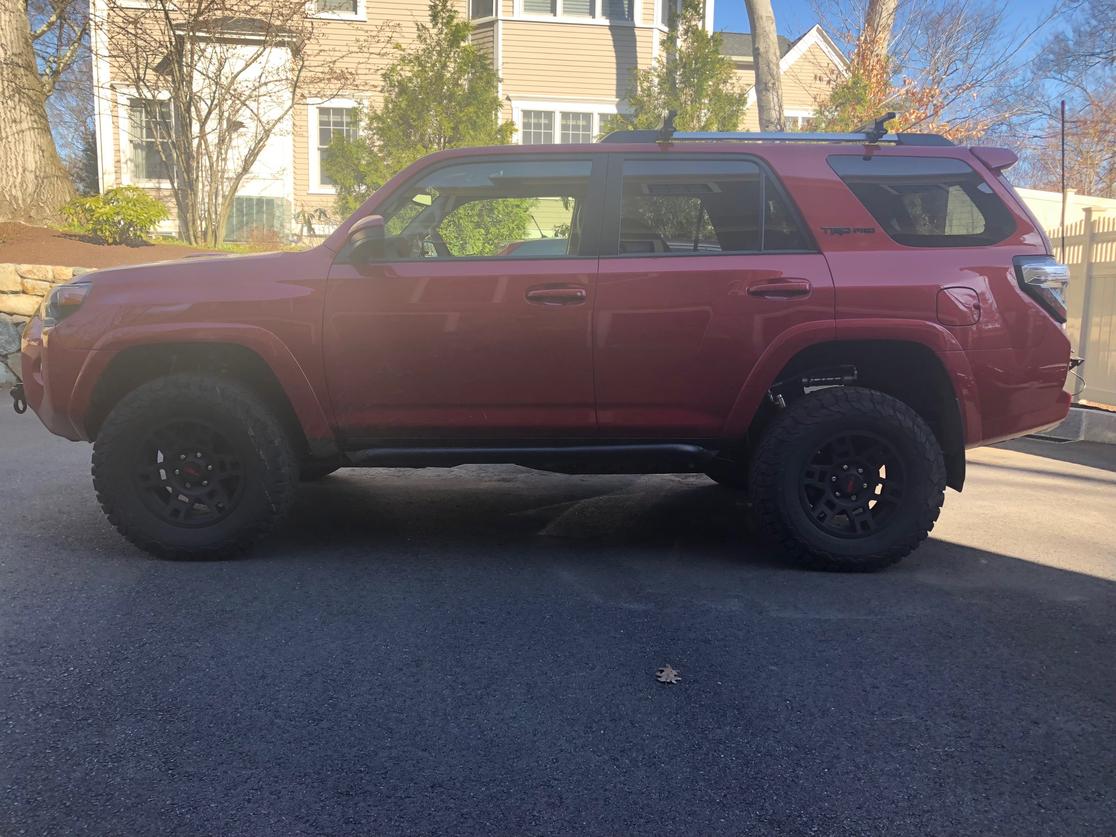

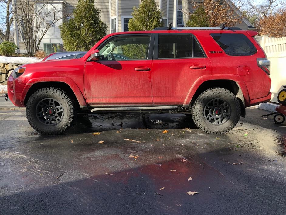

Received the tool to adjust the coilovers. Jacked up the rig and was simple to add some preload with very little effort. Added about 3/8" and got some great lift out of it. I'm sitting around 25" in the rear center hub to fender and 23 3/4 up front.....I'll prob drop the front a touch for slight rake, and I will be adding a rear bumper. Waiting to see what the pelfrey looks like in person vs if SSO gets their version 2 out vs cbi.......
First pic is the preload I added. Second pic is of the truck before I added preload and last pic with preload. Makes the 275s look a bit slim!

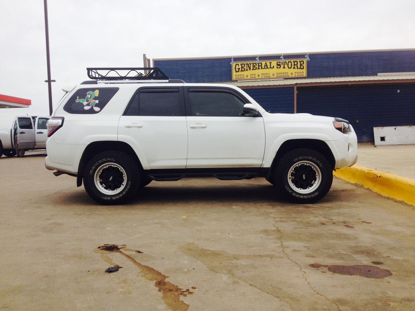

Installed kings a couple weeks ago. I don't have exact measurements but from what i recall the front is about 3/4" higher than the back. After install i was pissed i didn't take before measurements. My driveway is slightly slanted so don't let it throw you off.
