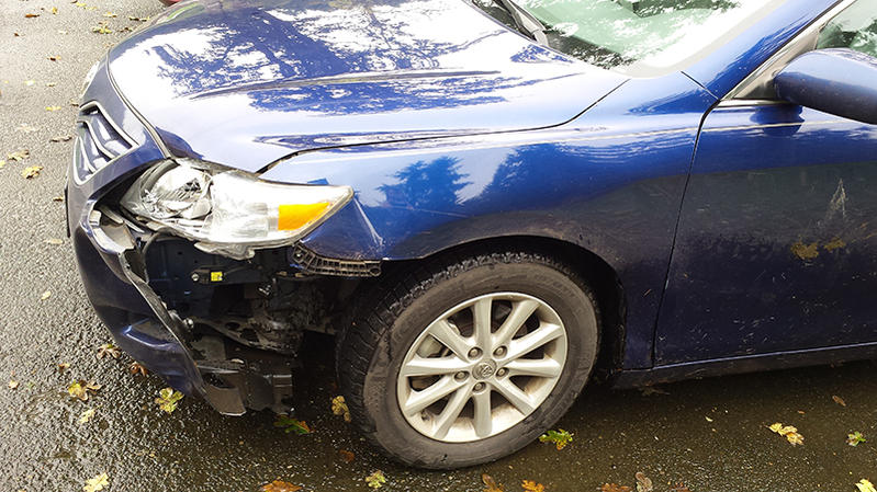

My front plate bumper paid for itself on August 13th 2016. I'll guarantee you that I would have had to get a new front end if it wasn't there. My trip would have been over.
Unfortunately, my Camry wasn't so lucky when a deer ran out in front of my wife. The county removed the "Deer Crossing" sign so now the deer won't cross there anymore.:thumb3:

Bottom line is everyone on here modifies their rigs for various reasons and they tailor their mods to meet their own environment and purpose for their build. If you plan on going off road then you should expect to make some sacrifices in your DD road experience.
I try to ask the following question every time I try and justify a mod to my rig "Do I really need this for the type of off-roading I'm doing?" "Is it functional and worth the investment?"
You should tailor your mods to your type of driving, both now and in the future.
