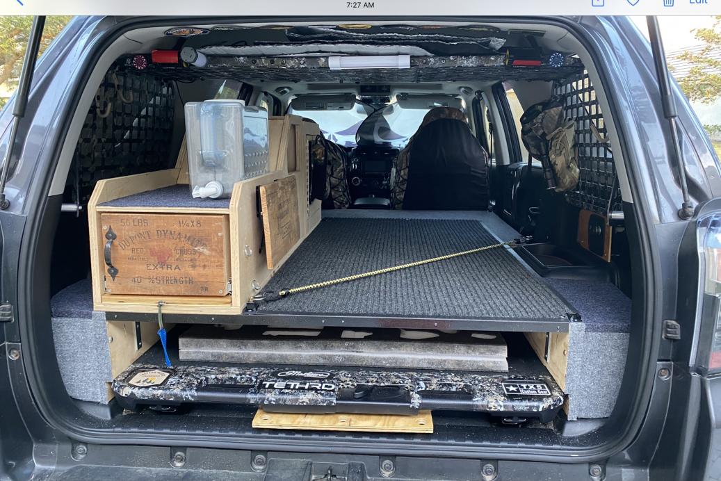

just needed a low profile storage solution so i went with the plans from trail4runner. i made the stupid mistake of using too thin of a plywood for the floor (1/2"), so it curls a bit in the summer. for that reason, i'll probably do it all over again next year with a more sturdy build. overall though, still proves useful and really comes in handy at times. i added small toggle latches to the side of each drawer front to keep them from flopping open when going up steep hills. i also added a 42" marine cargo net to help hold random grocery bags in place for errand running and a lip on the opening edge to help hold things from sliding out on an incline.

I am wanting to make a smaller set like these. Good job!
thanks! you got this - its not too tough and can be done fairly cheap. just be sure you get nice thick ply for the floor, if that wood warps it throws all the drawer slides out of alignment.
What thickness did you use on the top? Will you use the same thickness on the floor?
either 3/8 or 1/2"...i'd go 3/4" on the top next time. i might even be tempted to go with hardwood ply vs the cheap floor-grade stuff. the rest i'd leave exactly as the tutorial builds it.
