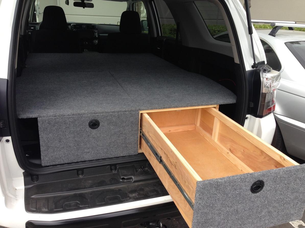

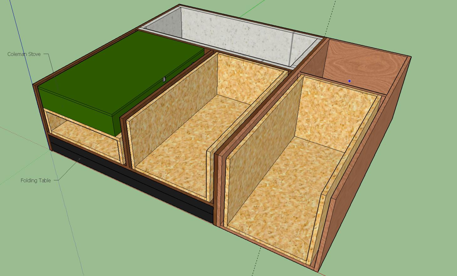

Send me your email addy and I'll get you the Sketch Up file file. I know you asked about the material cost, and I don't know what your expertise is, but I used all 9 ply Baltic birch ply, Accuride 24" full extension slides. On the new set I built for 2016 Trail, I used a locking handle that worked well. I have links to everything except the plywood, that could be had trough a wholesale distributor or a cabinet shop. I'd steer clear of big box store plywood.

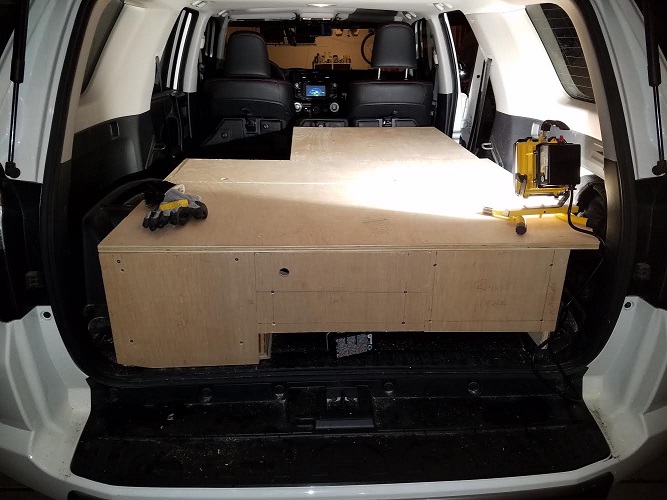

Still a work in process but this is what I've got going so far. It was very uncomfortable to lay in the back due to the step up where the seat would fold down. So the idea was to build this box to level out the trunk. It is only 4" deep but the plan is to get foam cut out for my gun's to be secured below a hidden door. So far it works out nicely to sleep evenly in the back while on the trail.

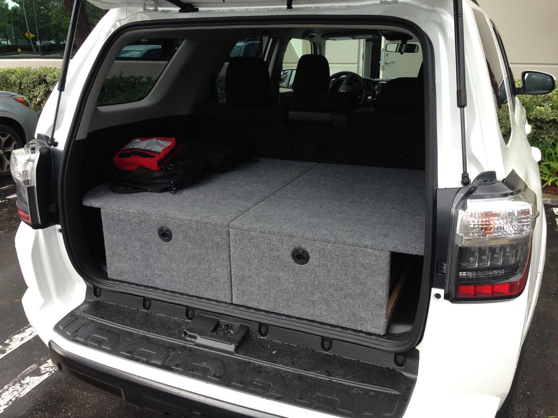

Threw this together before heading to Utah. It doubled as a sleeping platform which was really nice on a few cold stormy nights.

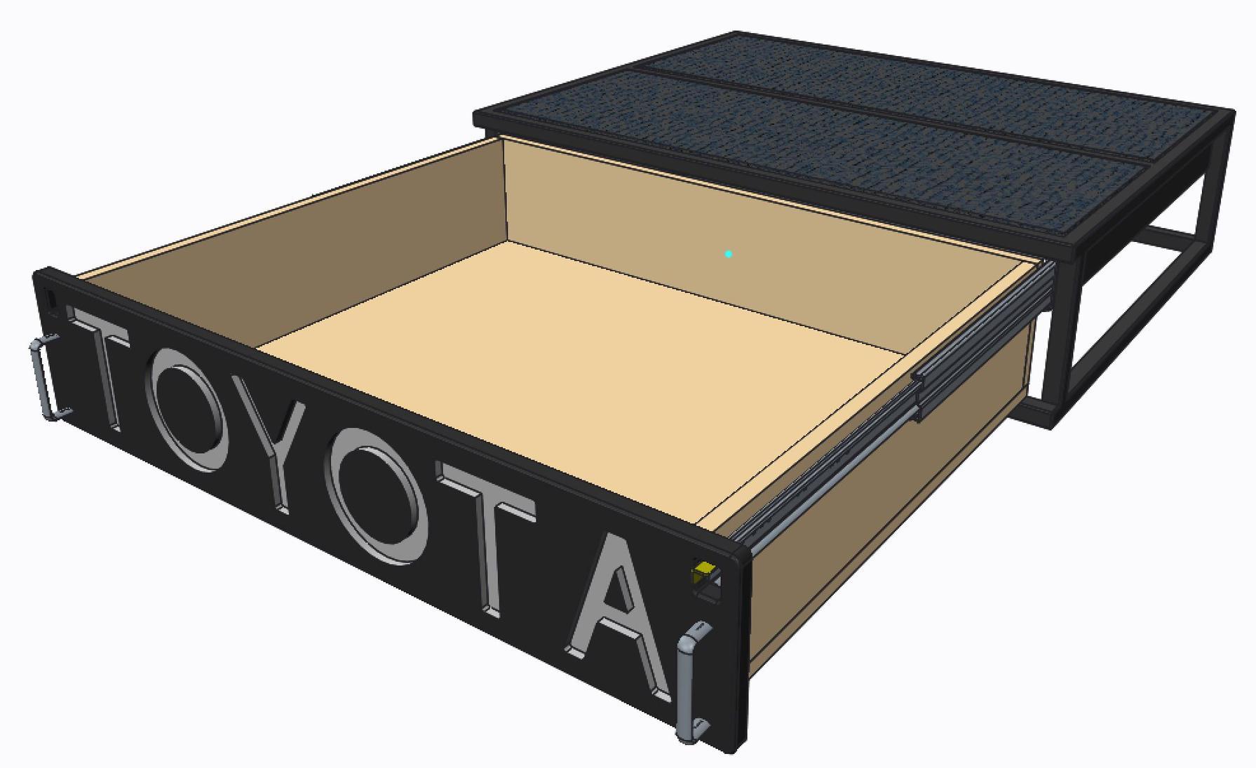

I am taking a short 6 week metal working class and am fabbing up a drawer for the back of my 5th Gen Trail. I am using 1" square tube and then plan on covering it up with baltic birch. My dimension are going to be 43" x 36" x 11" exterior. I still haven't decided on the drawers, but will probably do those in baltic birch and use bearings instead of $150 heavy duty slides.
I'm just taking it one step at a time. I like the idea of leaving the metal frame exposed so that if I want to add a sliding tray I could add it later.

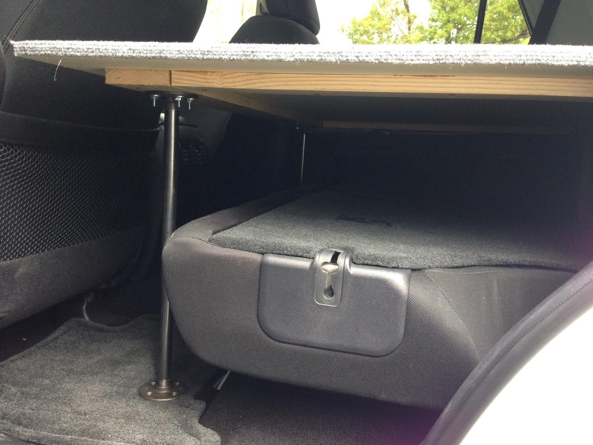

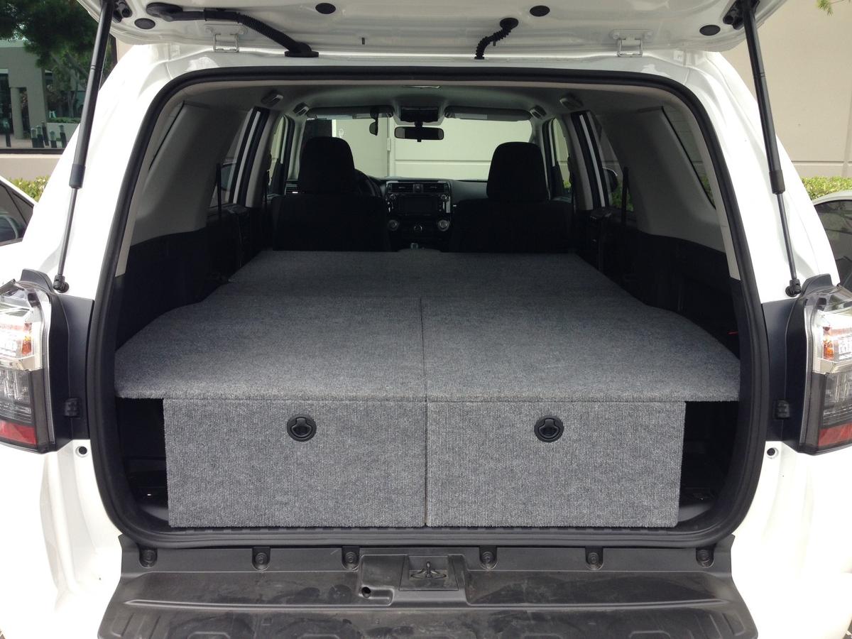

I finally finished up my sleep platform and drawer system. Its a two piece system, so for everyday driving the drawers live in the back and dont interfere with the rear seats. The top is at the same height as the wheel wells and follow the contour of the panels.
When its time for a trip I install the sleep platform. Im 6'3" so I wanted as much leg room as possible...which means the seat bottoms need to be removed. Not a big deal, 4 bolts and they pop right out. This gives me a 6' platform that goes all the way to the back of the front seats (in their driving position), and with the passenger seat tilted and slid forward, I have 6'10" of leg room.
As far as construction goes, I wanted to keep things light, so the drawer frame was made from 1x2's and 1/2" plywood on top. The drawer were also made by 1x2's and have 1/8" plywood sides. The drawers are 35" deep and I used 100lb 28" drawer slides from Amazon. I could only find 500lb full length drawer slides and the price was way too much compared to the 100lbs. The latches are made by Southco.
The sleep platform is also 1/2" plywood with some 1x3's along the bottom to help support it. One end rests on a lip on the drawer frame and held with two 1/4"-20 counter sunk screws, the other end is supported by 1/2" x 18" steel pipe with threaded floor mounts.
The entire system can be installed or removed in a couple minutes. The only modification is removing the seat bottoms....which to me, is worth it for a good nights sleep so I can stretch out.
I still have some tweaking to do on the inside of the drawers and how I want to mount my camp stove and some general organization dividers, but all in all, Im psyched on how it turned out.

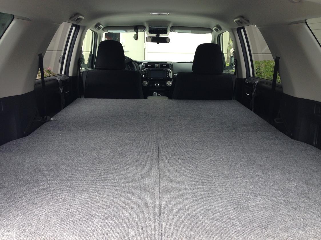

The dimensions of the platform are 72" long x 53" wide. From the platform to the headliner is 28".
Obviously 28" isnt a ton of headroom, but for me, it fits my needs of having a comfy place to sleep at night without having to setup camp.
For the last 6 years or so Ive used a cheap ikea full size mattress for throwing in the back of trucks or vans. Its super comfy, 4" thick, 100 bucks or so.

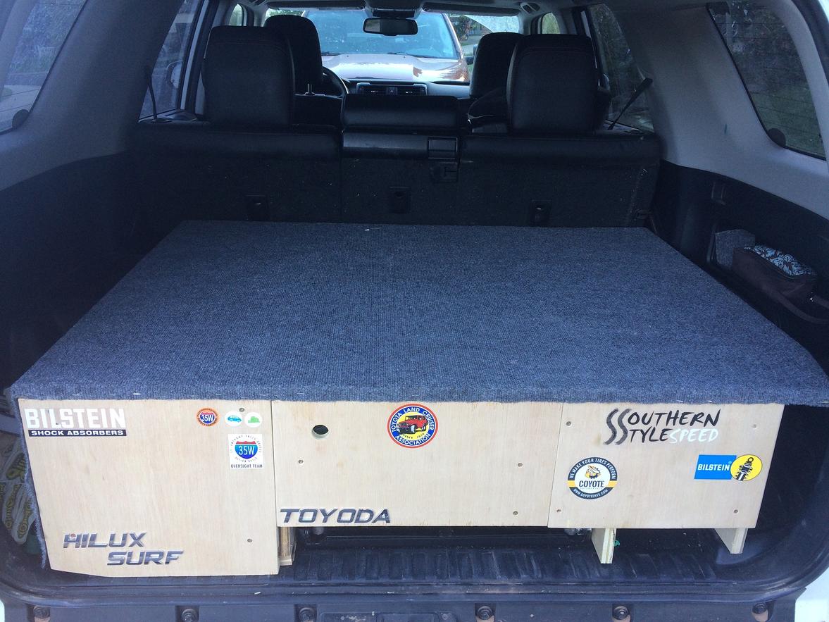

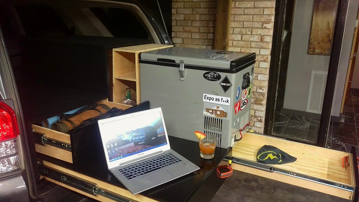

Finished the drawer system today, only thing left is to finish it. Probably won't happen until the middle of May or so. Next step is to get a ARB 50qt and get the fridge drop slide installed as I sold my Smitty ARTEC fridge. Pretty happy with how it turned out.

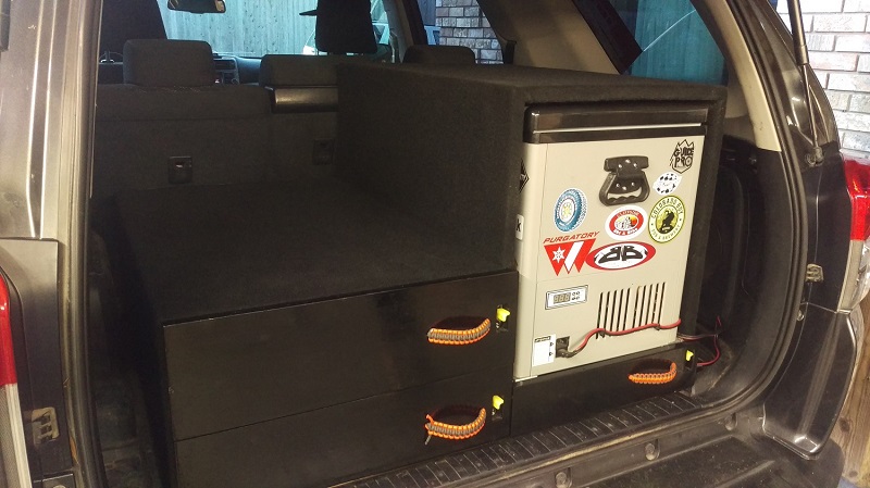

Update: I thought I was 100% done with the build yesterday, but it just occurred to me I hadn't attached the table face yet or installed my Stone Brewery bottle opener. My wife was kind enough to let me have a few hours this afternoon.
I also put the fridge drop slide in, still trying to decide which side to mount it to.
Or passenger side
After seeing everything I think I'm leaning towards the passengers side. The pros are: weight offset by gas tank, can still use top table if not fully removed, water tank is tucked behind the fridge slide so its out of the way (but still accessible when fridge is pulled out), and I can still fold down the 40/20 seats on the drivers side to sleep or pass through. The Con: I will no longer be able to see over my right shoulder when switching lanes.

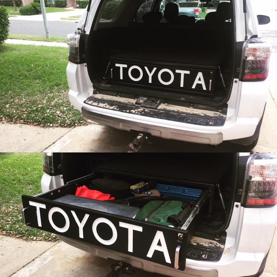

Went with a welded steel frame so I could have one large drawer than can be partitioned anyhow I please rather than be stuck with two equal sized drawer. So far so great!
I would go passenger side for the same reasons you mentioned. I often have a north face duffel on top of my fridge compartment which completely blocks that window and I still see out the passenger rear door just fine for switching lanes for what it's worth.
That's a dope little pull out table, where did you scoop that?
