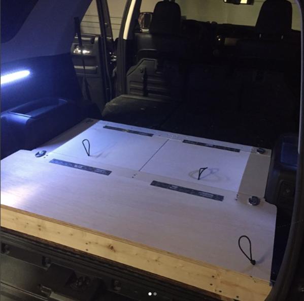

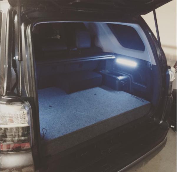

I like how you did this. But in the pic I can't tell; do you just remove the forward section when you use the rear seats? I want to hinge one to fold back but don't know if that will work.
Yes, the forward "half" of the sleep platform gets removed and the seat bottoms go back in for "daily driver" mode. Its really easy to swap in and out, but lately, Ive just been leaving the platform in.

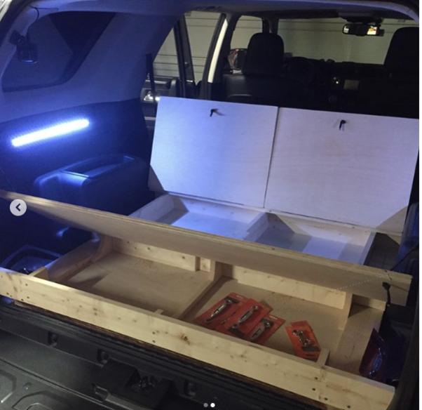

The hinge method could work depending on how you design it. On my specific build it wouldnt work since the front half is 36" and the headroom is only 28". I did help a friend build his and he wanted a similar idea. We ended up making the sleep platform pop in between the drawers and the seat bottoms (he wanted to leave his in). Ill get some pictures of his setup.

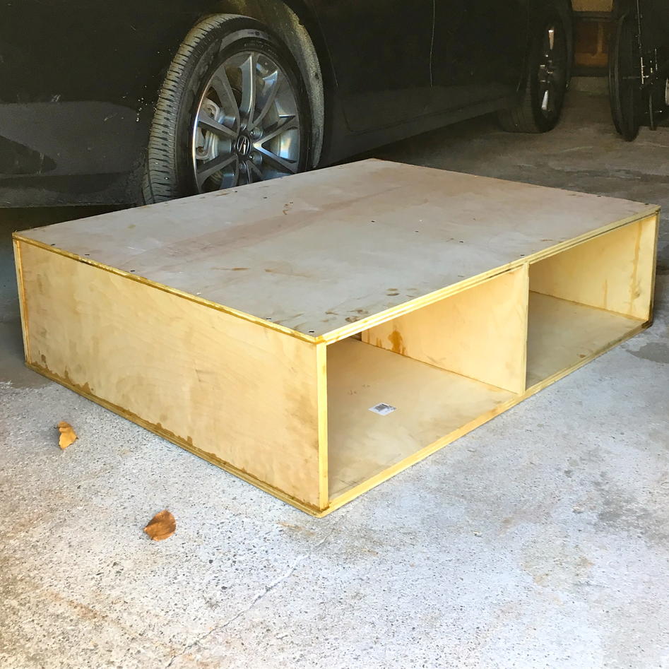

Started mine months ago. Maybe this weekend I'll come closer to finishing it.

Mine is really simple. I sketched it up and my father in law knocked it out in an afternoon. Two short drawers and a full width compartment. The flashlight bracket is also the charger, so I can plug it in the 12v.
