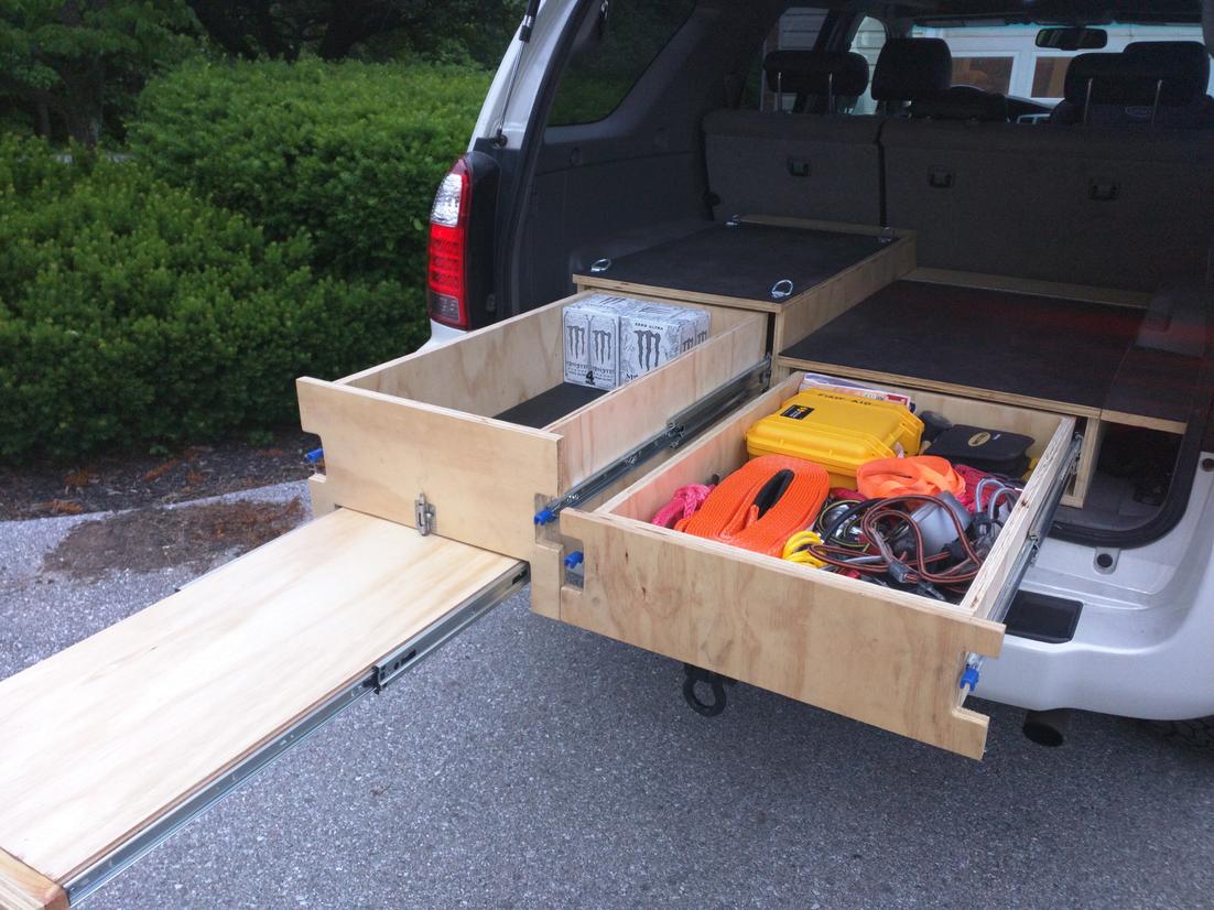

Got a little more of my drawer project finished today, got both my side table and sink mounted, I still need to spend some time with a router and some polyurethane. I'm not going to stain the tables or sing mount, just protect them and replace them when they get destroyed. After that the next step is to hook up the water, modify my drop slide so it will house a pull out table similar to the Tembo Tusk unit and then build the fridge divider/barrier.
The groove is on the bottom of the table, lets it clear the slam latch catch.
Sink stores under the table surface on the drivers side drawer. I plan on storing it on top of the fridge barrier once it's built. The painters pole stores between the seat back and the box.
Spent Sunday modifying my Easy Slide 150 fridge drop slide to house a pull out table underneath it similar to the Tembo Tusk drop slide.
First I cut the front of the Easy Slide off.
cut a few pieces of 1.5x1.5" 1/8" steel angle
I order a piece of 10 gauge pre cut to 29"x15.25, fits like a glove
Bolted the risers to the side
Bolted two KV 26" slides to the bottom, 1 locking, 1 not.
For the table to I found a Husky took box topper that fit with minimal modification.
Risers painted and table installed
The risers were tapped and the top was bolted on. I wanted to weld this, but the order of operations inhibited welding as it would have kept me from disassembling if needed in the future.
Fridge mounted
Table pulled out
Fridge and table pulled out, fridge still drops down 85% of original drop with table out, but handle does get very close to table.

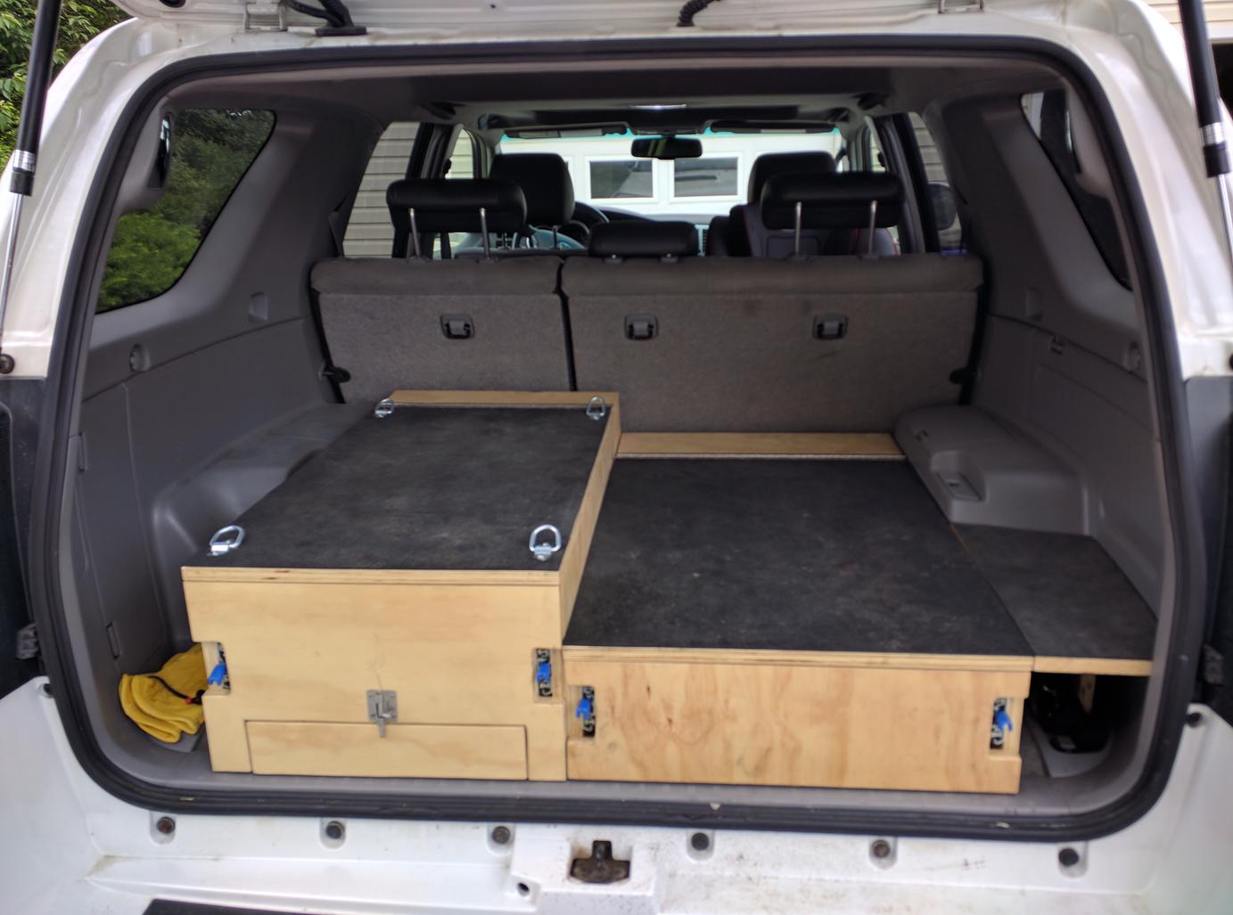

Pics of mine for good measure. Not as pretty as a lot of your guys builds, but they work!

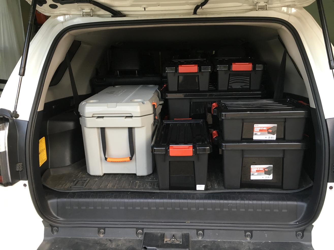

Ozark Trail 52 and Store-It-All totes. 2x43, 2x20, & 3x12 quart.
