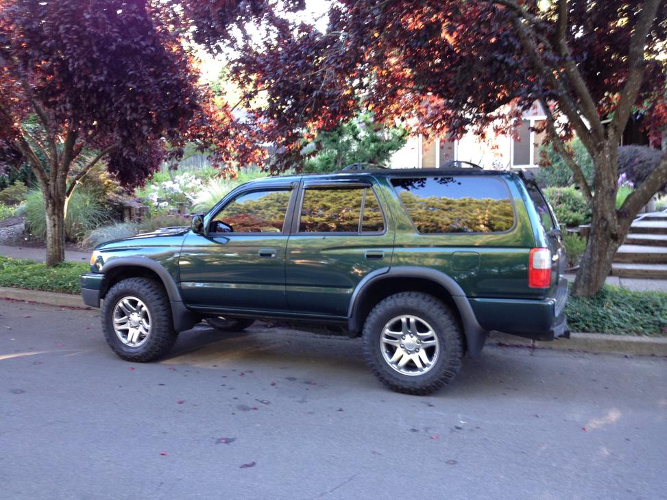

Stock 99' springs, 265/70/17 duratracs!
No rubbing at all

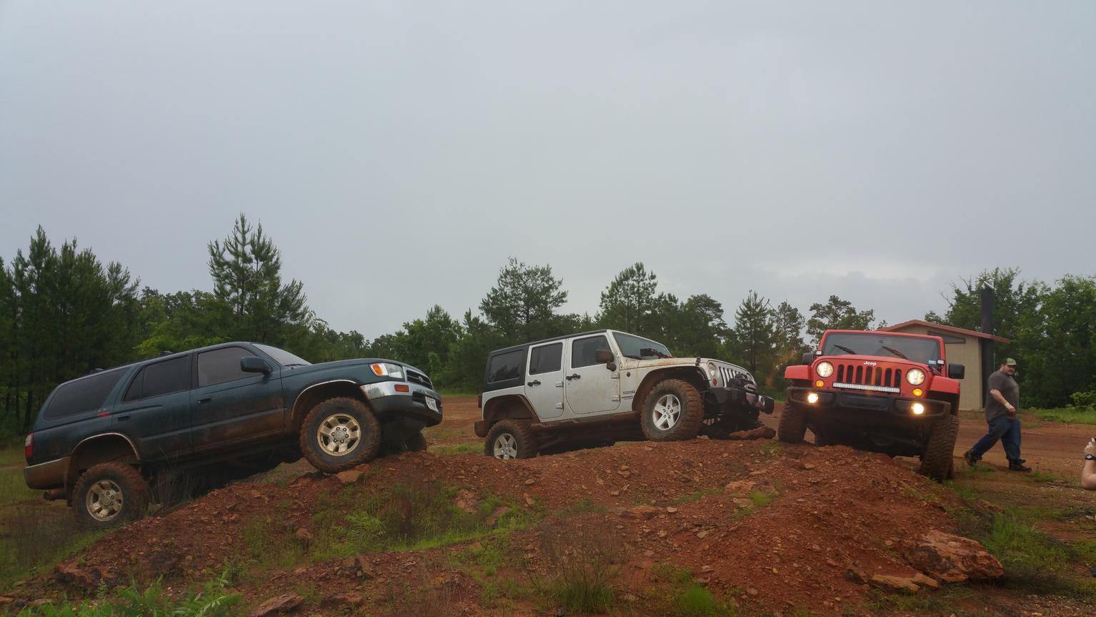

The silver Jeep is on 35"s

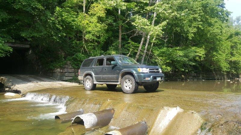

265/75R16s look great on these rigs although next go round im buying 255/85R16 (I think that's it). With a little more ground clearance with no mods required they sounds very appealing.

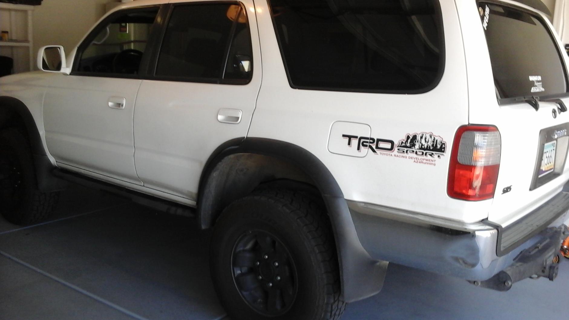

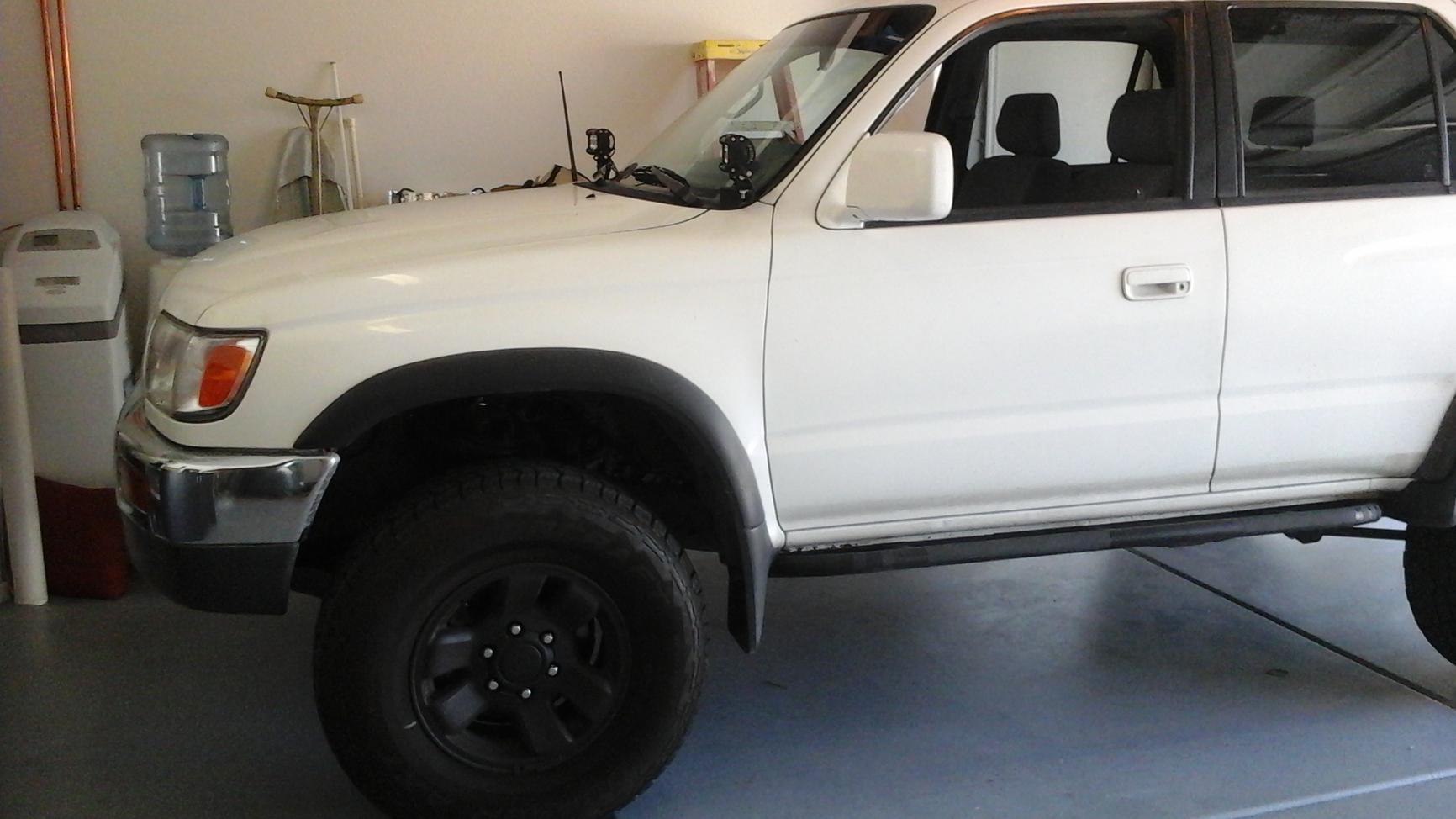

My rig with 265/75R16, OME 881/890 lift.

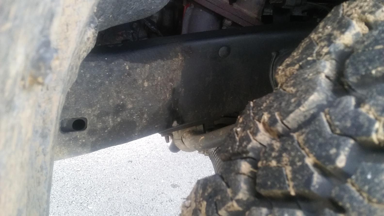

Mine Rub
I put 265/75/R16's on mine stock height and I have some rubs on my frame20150807_142916.jpg

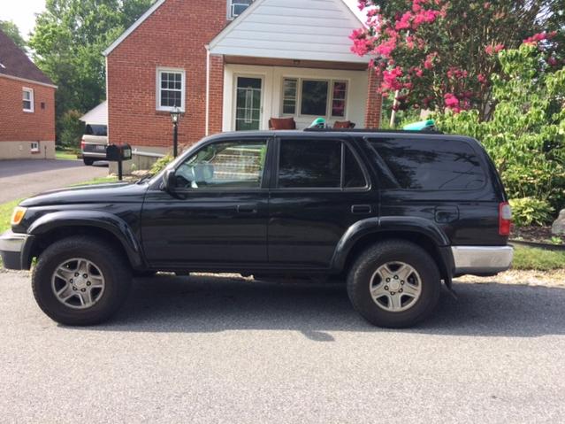

all stock

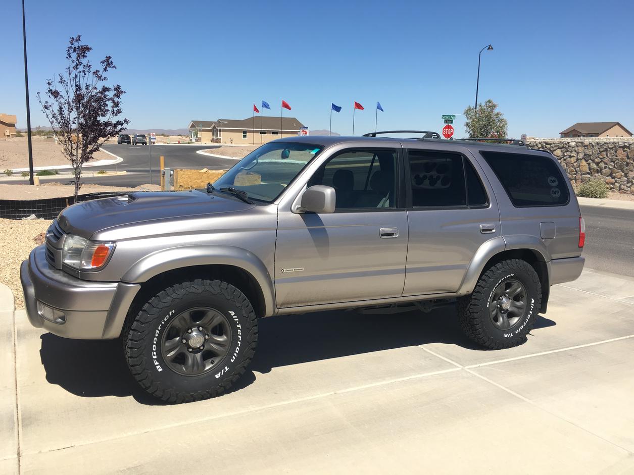

2002 and they do rub the fender liner a touch right at the pinch weld. I cannot wait to get a lift. 265/75/16 BFG ko2s, center of hub to fender measurement front 19" rear 19.5". Tired suspension 197,500 miles on a 2wd Sport edition.

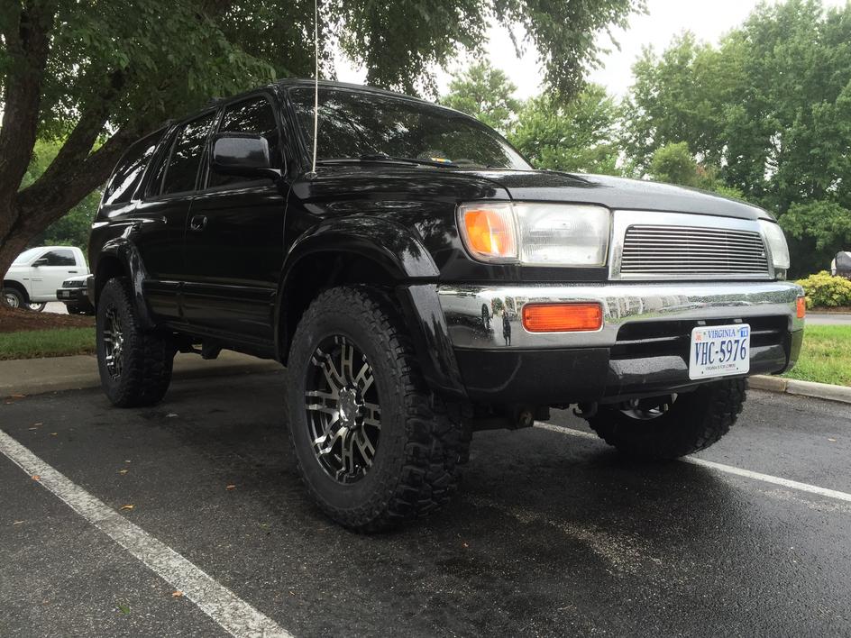

Mine with 265/75/16. Vehicle has tall 99 springs (probably have slight sag at this point with 115k) and rubbed the front bumper slightly lock to lock. I took a saw to the plastic on the inside just slightly then sanded with a metal file. I haven't had any issues during flex thus far.
I haven't done any measurements, but the tires seem to run quite large.
Anyone else have the same brand of tire? Just curious.

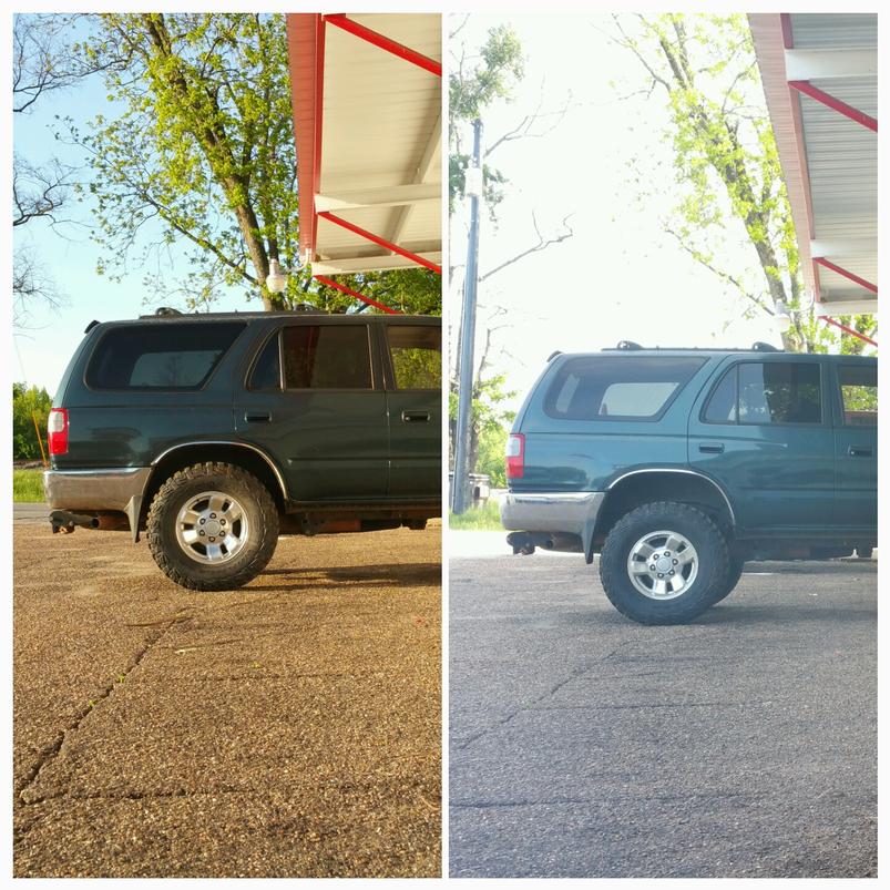

2000 4runner 3" toyota tek lift with 265x75x16

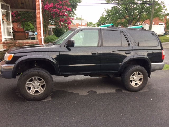

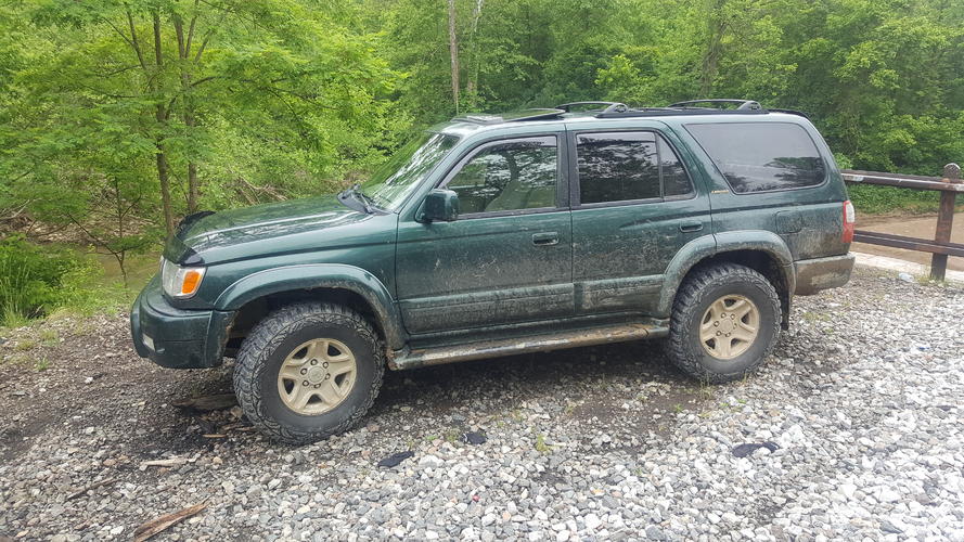

Here's mine with 265/75r16 Duratracs. Lift 881/890 on 2nd perch of tundra 5100s. Hub to finder, 22" front, and 23" back.
