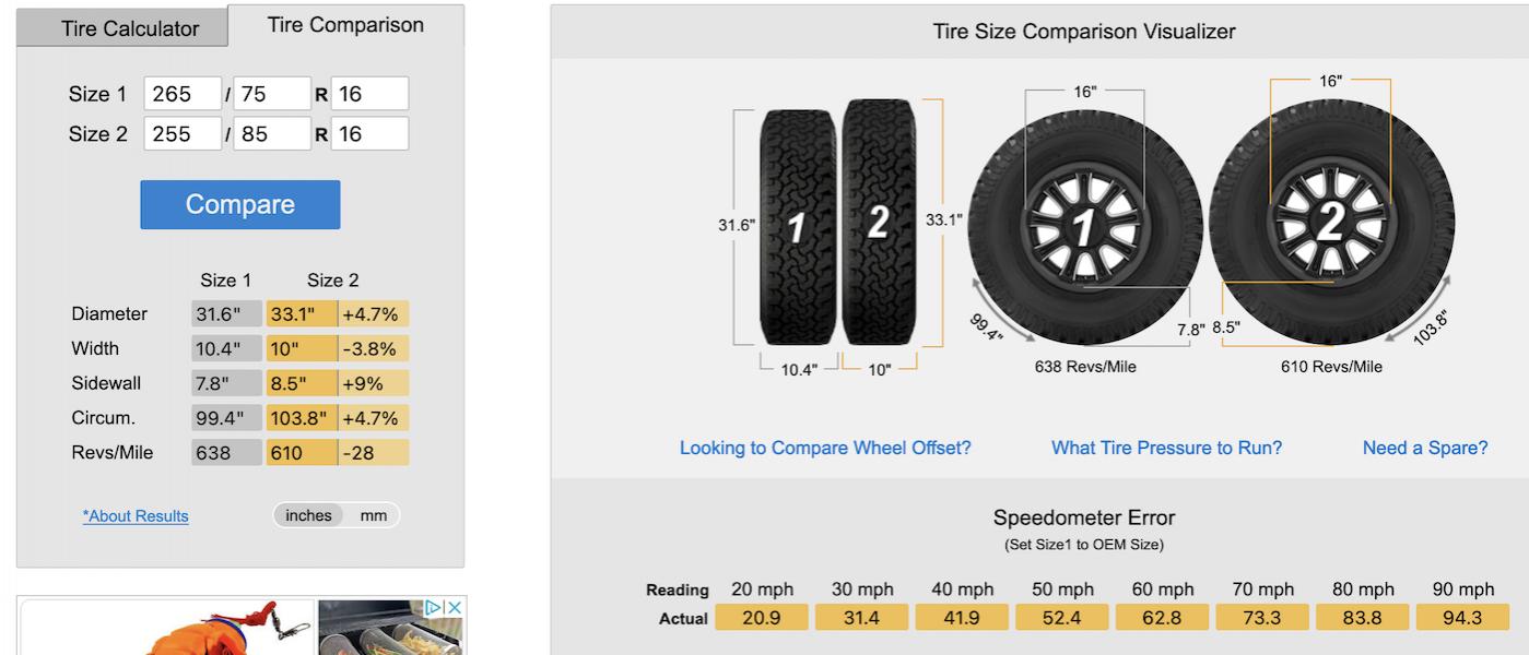

I love 255/85 as opposed to 285/75. Not only are they taller than the 285s but they make the steering feel much better and I can get 18.5 mpg loaded down with a RTT. Plus you can fit 255/85 with barely any clearancing required. You don’t have to beat the shit out of your car and change upper control arms and do a bunch of supporting mods to make them work
The biggest drawback though is you’re only gonna find MT tires in that size which sucks and isn’t for everyone
