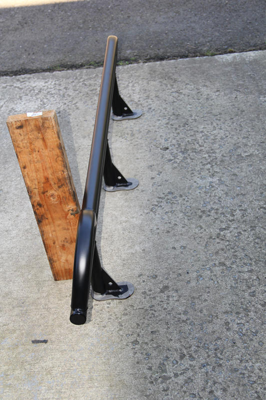

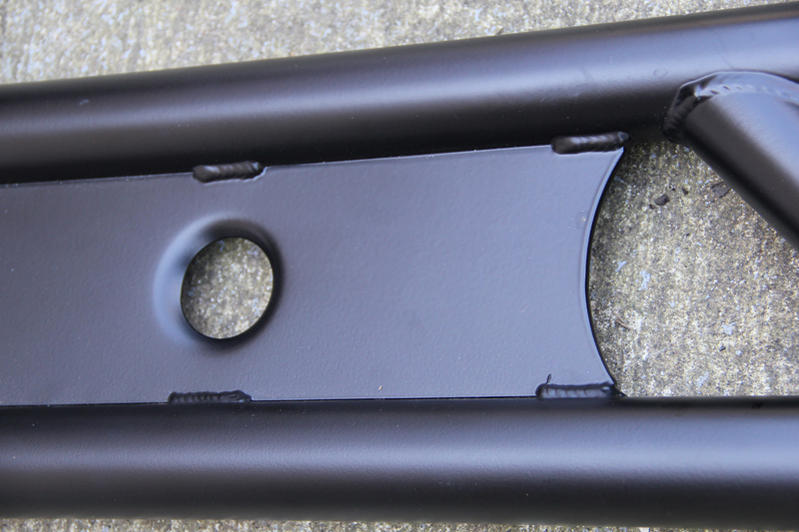

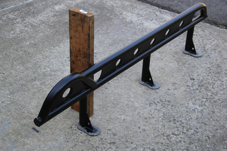

Those are weld-on from CBI Offroad with half the angle they normally make them. Normal angle is about a 25° offset from the weld. Mine are around 15°. Awesome craftsmanship. Welds and powder coat are immaculate and their service was great. Give them a call and ask for Nathan (208) 528-0664. Cost was $700 with shipping.

Yeah I thought they looked like a CBI product. They look real unique with the plates welded in. Thanks for the info!

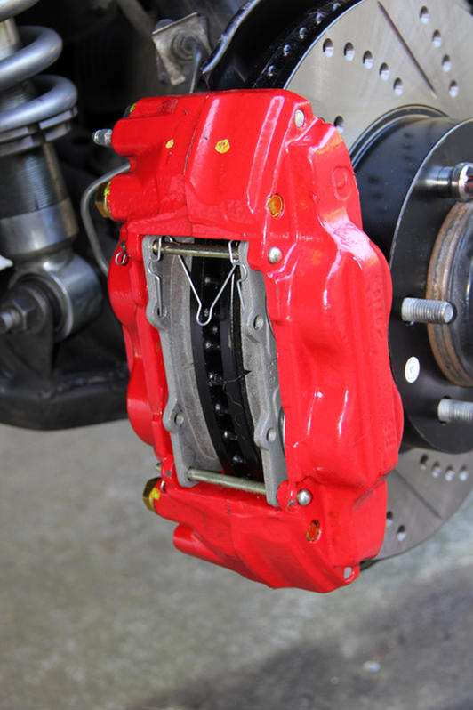

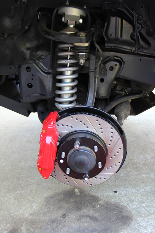

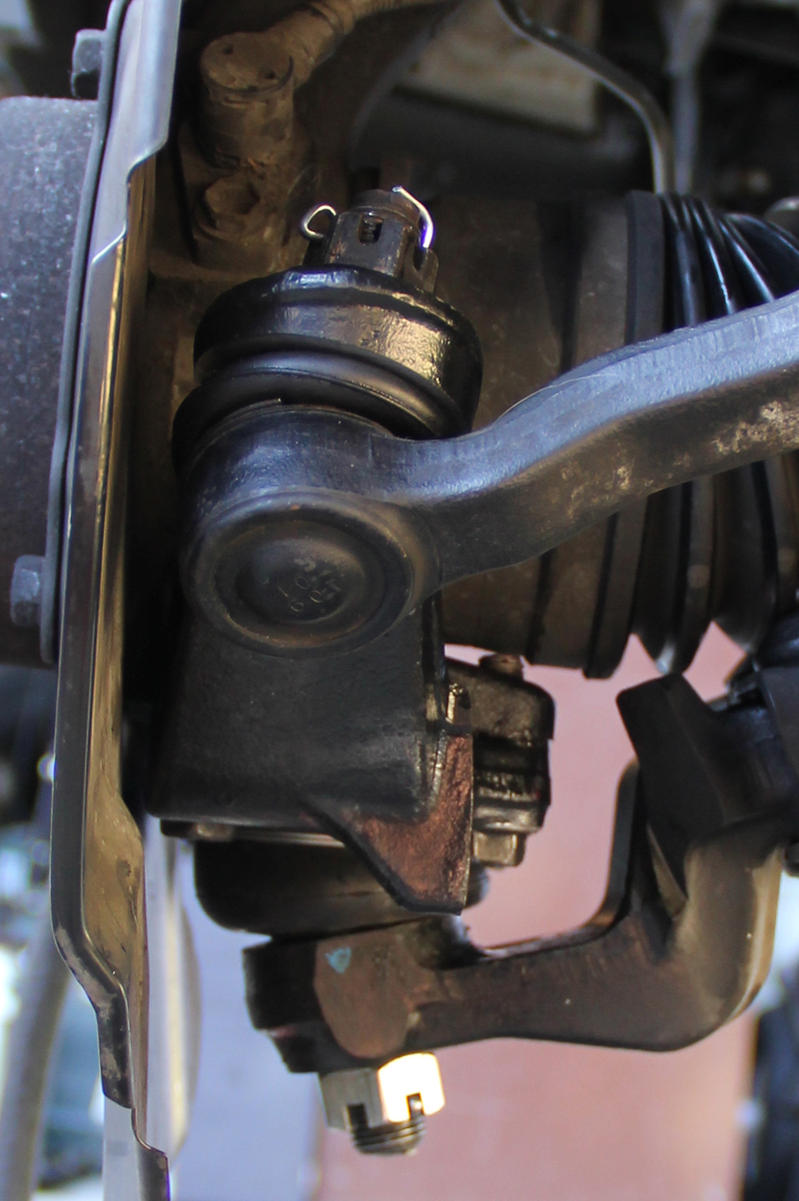

Tundra Brake Upgrade - DONE!
With 311K miles you guys really scared me about the lower ball joint failures. Mine were never involved in the recall but I went ahead and bought two new OEM ball joints over the weekend and went ahead and replaced them today. Finally finished up my Tundra 13WL rotor/caliper brake upgrade. Can't wait to feel the difference in the ride.
Went with the following:
Lower Ball Joints - OEM PN# 43330-39585 (Rt) and 43340-39465 (Lt)
Sport Tech Slotted and Drilled Rotors - 127.44118R and 127.44118L
PowerStop Performance Brake Calipers - S2712 for the pair
Wagner Thermo Quiet Ceramic OE21 shimless pads.
I hesitated to go with the aftermarket calipers and the Wagner pads. Both have a warranty and if I'm not happy with them I can return them. They also take any existing caliper in exchange which was also a deciding factor. Will keep you posted on performance issues.

Thanks! Go with OEM if you can and check out speedy's video on painting them red. Are they the 13WL or the smaller ones? If you do go with the Powerstops I ordered them from autoanything with a 20% off promo code. Figured I would go with the bigger ones since I'm keeping it. Heading out on a business trip so haven't tested them out yet. Will let you know when I return. My concern with the Wagner pads is they may be too harsh of a pad for the rotors. Might need to go with a "softer" pad. Perhaps OEM. Concern with the powerstop calipers is the QC on the re-build. So far no leaks when I bled them. All went real smooth. Just ran out of time to break them in correctly. No need to rush. Waiting for the 1" body lift to come in before I weld on the sliders. Ordered from Toytec. Was going to go with 4Crawler but too complicated of a site. Huge turn-off. :)
