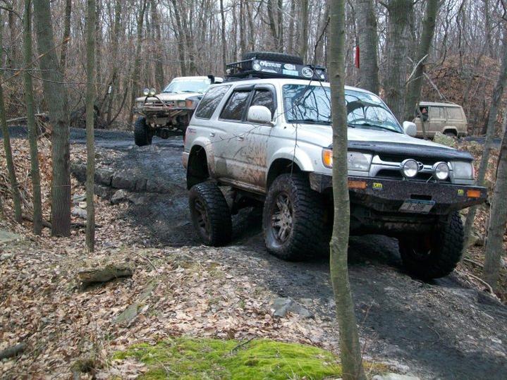

Post your Pics if you have LC coils as your lift!!
