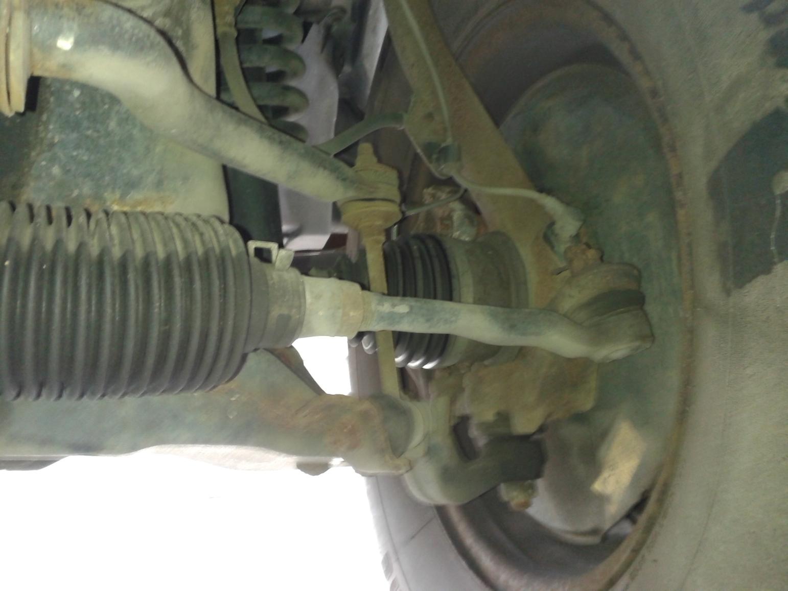

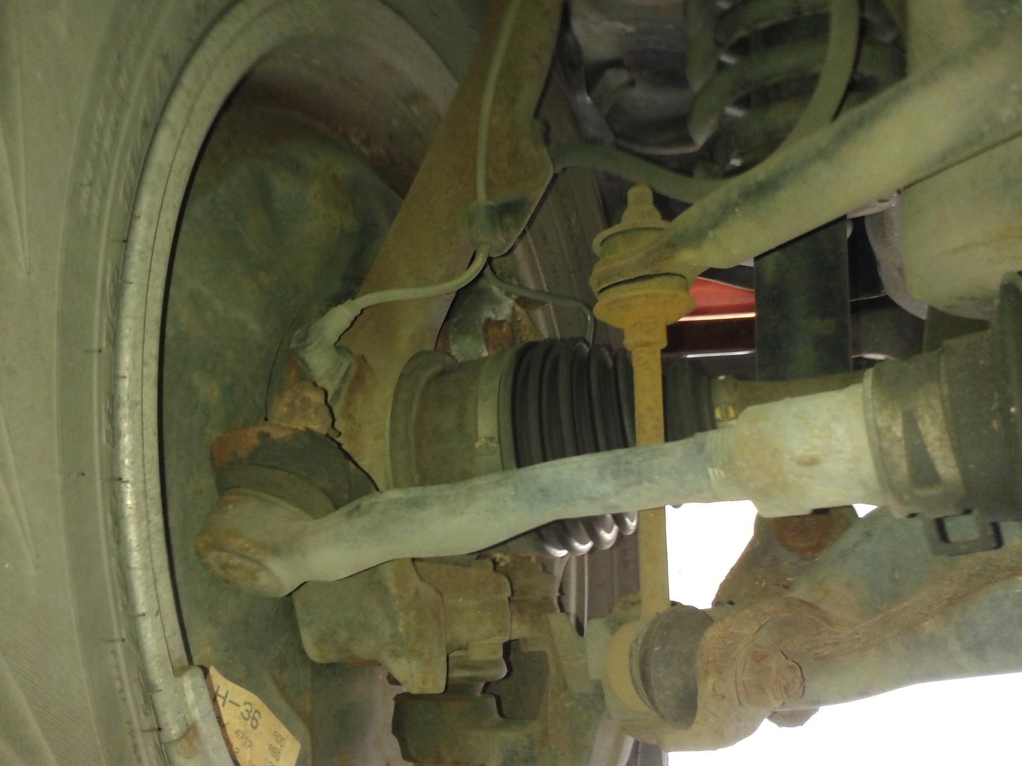

Hi to everyone and a thanks to all that have posted. I've been looking for a used 3rd Gen for about 5 months and saw a pretty good one today but it had excessive wear on the inner section of the front driver side tire. I took some photos of the left and right sides (both wheels were straight) of what I thought could be the issue: bent tie rod end.
Is the left side tie rod end damaged and in need of replacing?
Thanks in advance.

Very good eye: yes, spare tire on right side but the owner said it's only been on for a few miles as they got a flat. Maybe it was on for longer...
I didn't twist the tie rod. Maybe if I take a second look I'll do so. Visually the left side looks to rest at a different angle slanting towards the front more so than the right side.
